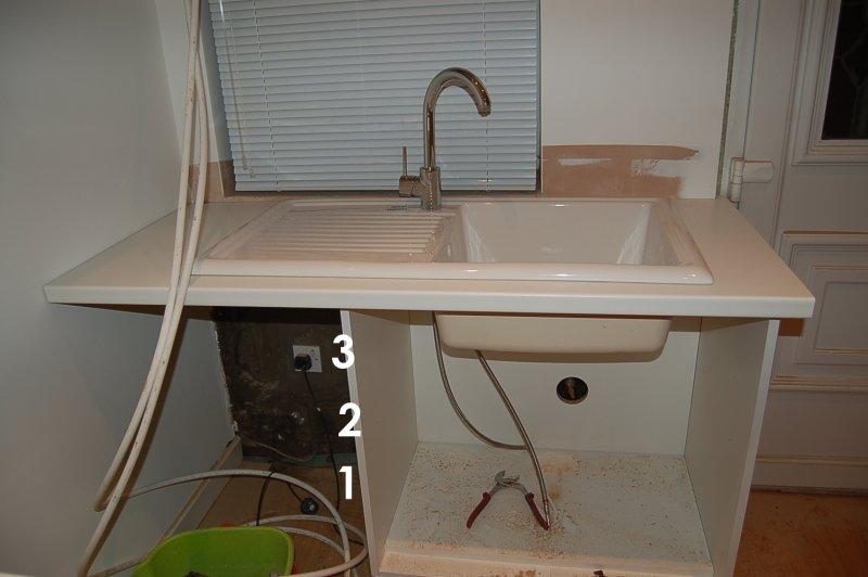

I'm replumbing my kitchen.
What's the best position ( 1-bottom, 2-middle or 3-top )for the cold and hot water supply for the washing machine ?
I will be buying a different washing machine soon so I need to put the water supply at a position that the new washing machine fit too.
50mm hole, drilled 50mm under worktop, this will allow both hoses to go through and will keep waste pipe high enough
