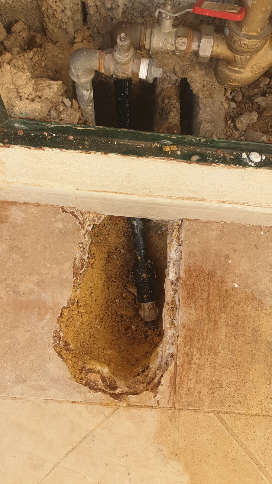

Found out yesterday my underbuild in spain is like Glastonbury in the rain.muddy as hell.
Traced it to a leak from the mains to the house, its bubbling and fizzing but is that an indication that the leak is very close to that point or could it be 2 metres of concrete breaking away from the point of the vid ( just as the pipe bends up in the wall to meet the house stop valve.
I'm hoping to catch it there without tearing right through a tiled patio any pointers would help as the insurance guy ( 3 hours ) is not here till 9am tomorrow, spain eh !

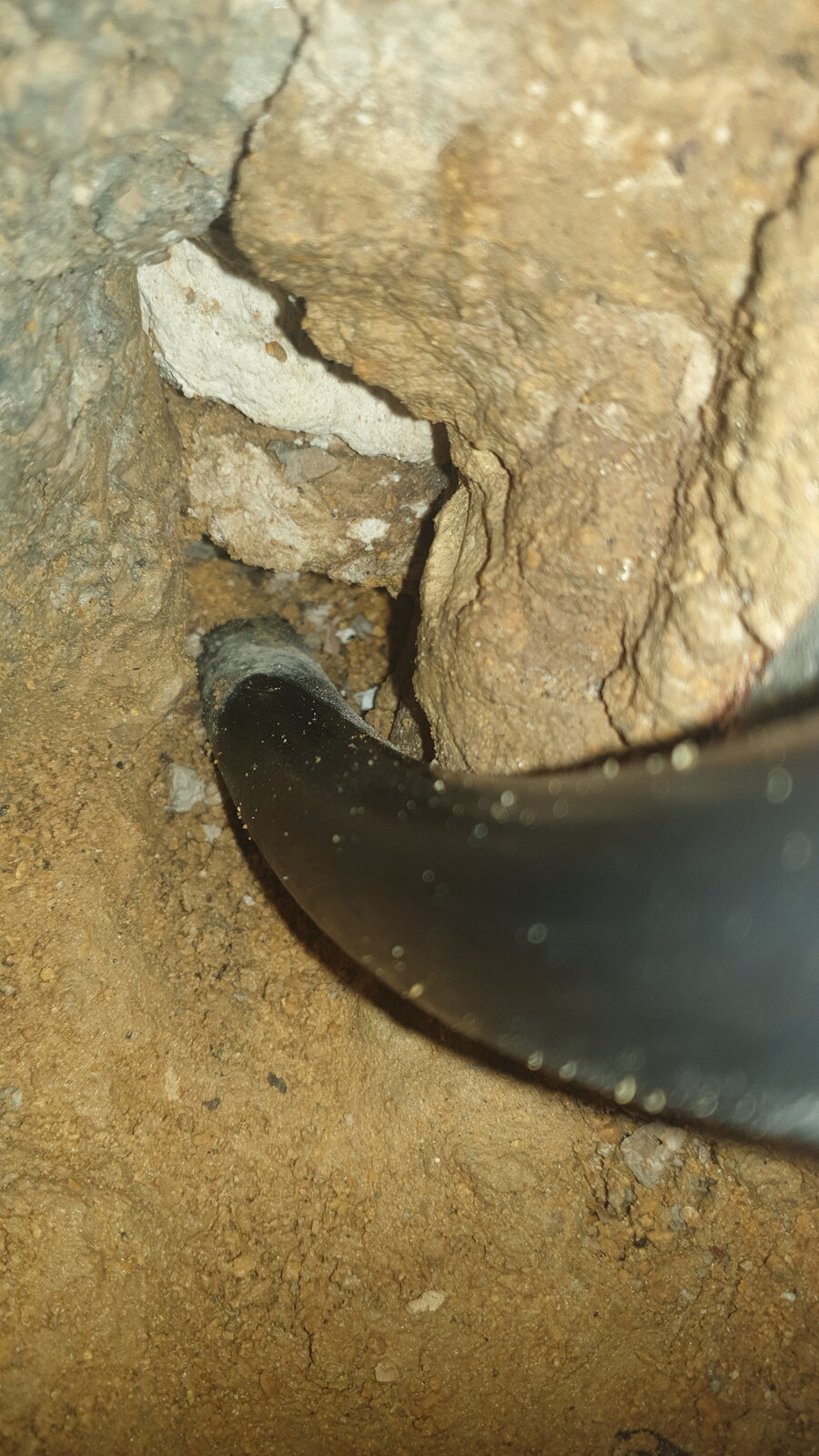

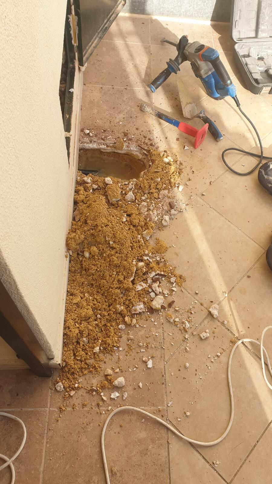

I dug up the first tile section, and it was there on the bend a pinhole. The guy replaced the pipe so all good now just need Glastonbury to dry out and me to fix the tiling. Could have been 5he whole patio dug up so small mercies eh!
