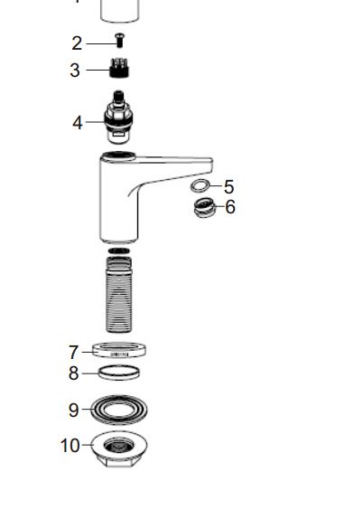

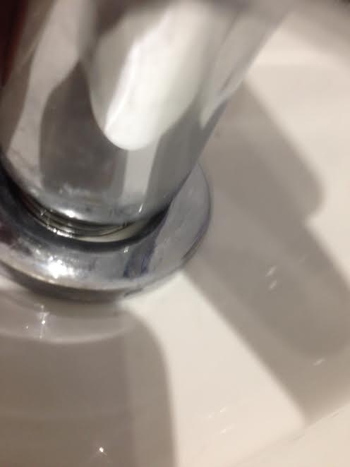

Hi,
Just had a new Bristan shower mixer tap fitted but I've noticed if water splashes on top of the plinth (the plinth is a separate piece with a a washer underneath it - see technical drawing) it seeps through the holes in the bath and trickles to the underside of the bath as it does not provide a water tight seal. Basically, it allows water to seep inside the inner ring of the washer. Why have they designed it this way - surely this is a design flaw? The plinth should be a solid piece, part of the body that way if water splashes on it, it has no where to go apart from into the bath. Any way how do I fix this. Someone suggested clear silicone but that's gonna look awful.
http://www.bristan.com/WebRoot/BristanNewDB/Shops/Bristan/Products/CS DRAWING-1055651-1-D2-1.PDF
http://www.bristan.com/WebRoot/BristanNewDB/Shops/Bristan/Products/INSTRUC. PDF-1060845-1-D4-1.PDF
It should have had clear silicone applied to the underside when it was installed and the excess wiped off before it dried. Tap needs to come off to do this.

Theres nothing on the instructions about applying silicone? I's say is a flawed design. The plinth shouldn't be a separate removable part, its should be one single piece which is part of the main body of the tap. No water flows through around the side of the plinth, because the washer beneath it does the trick, its only when water falls on top of the plinth that it finds its way into the gap and down the middle of the washer and through the tap hole along the tail.

Ok mate. Thanks for the tip. When you say apply silicone to the underside, do you mean the underside of the plinth where it fits to the body becuase under the plinth there is a washer that sits inside a groove in the underside of the plinth?
I would put a smear of silicone on every surface. I often bin the rubber washer that is supposed to fit between plinth base and deck as they can be unsightly as they can splay out. If it is held in place by a groove then keep it in but smear with silicone to make it 100%. Yes you need a bead of silicone on top of item 11, the plinth,so that it seals against the tap body when it is put together.

It should have a rubber insert on the underside of the tap plinth. It's not a design flaw, if it isn't totally flush against a cleaned flat surface of the bath or if it isn't fitted square to the holes/holes too large then it can overlap the edge of the hole, it was always leak if that's the case.

Thanks again mate. Is there any particular type of silicone I need to use. I've got some dow corning 785 sanitary silicone. Would this be suitable?
That would be absolutely fine. You dont need a huge amount, but some will ooze out when you assemble and tighten the backnut. Wipe it off right away before it starts to set.

I have had a similar problem with Bristan Quest bath fillers in shower-bath setup. The washer 8 at the bottom stops water entering from the side but is not tight to the tap thread so water falling on the top of the tap finds its way down between the two part design down the thread. To fix this I added a thin O-ring between the two sections. Also I added a makeshift silicone washer cast onto the top of a mastic container that is tight to the thread (I could not locate a 50mm washer that had a 1inch centre anywhere). I'm still monitoring for leaks but if it continues I'll just replace taps for a single piece design and warranty these ones.
