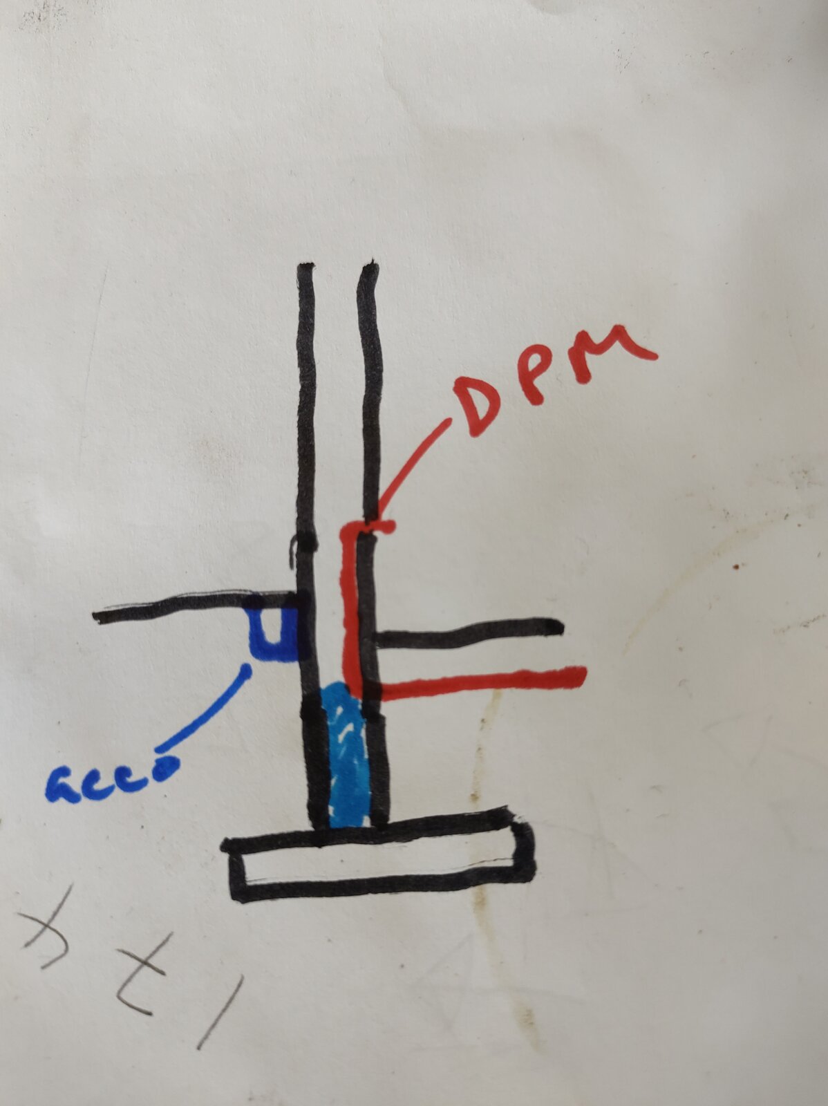

Retaining wall 150mm away with an acco finishing 150mm below dpc at the the bottom - then you have a "normal" build - otherwise take your chances with polythene sheets, internal tanking etc - and don't skimp on the detail.
Your polythene on the outside will just trap any water entering the outer leaf higher up the wall unless you put a cavity tray above it.

No, you will never keep the external face or the wall dry unless you create a continuous barrier down the walls and under the foundations.
You either design a barrier into the cavity or on the internal face
If you can avoid water collecting at ground level you wouldn't need accos, at its lowest point my internal floor level is about 250mm below external ground level and it's impervious clay so I was faced with lots of water standing against my wall (before the extension we pretty much had a small pond at the back of the house - so for belt and braces I also continued the floor DPM up inside the cavity against the inner skin:
As Woody says, a cavity wall is designed for a bit of water getting through the outer leaf - it just collects in the "trough" at the bottom of the wall and harmlessly evaporates or drains away below DPC level - you get problems when this can't happen and you've got excessive ground water getting in.
You might get away with something less if your soil is free draining but there is an element of risk.
