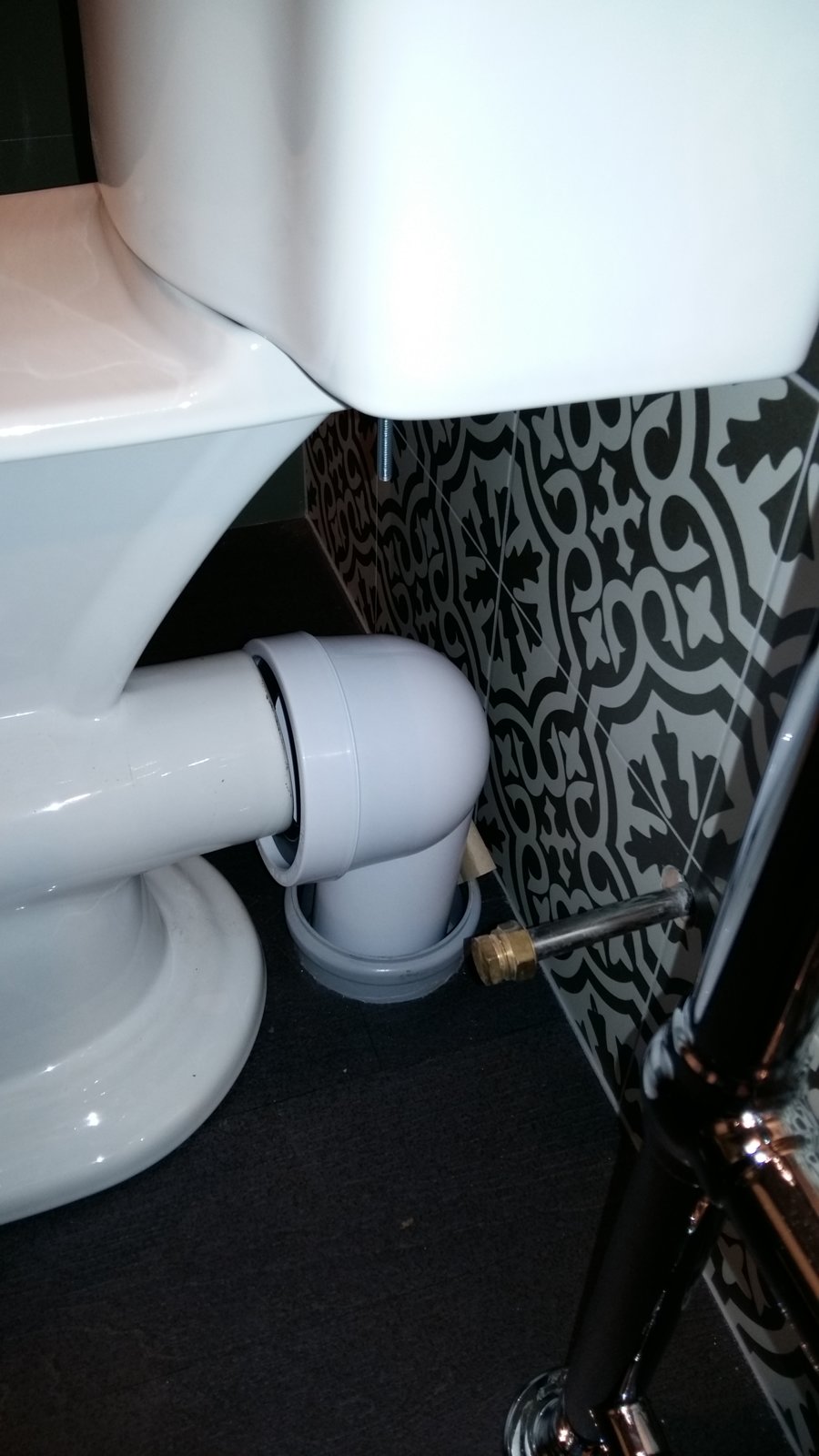

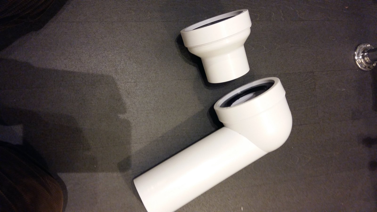

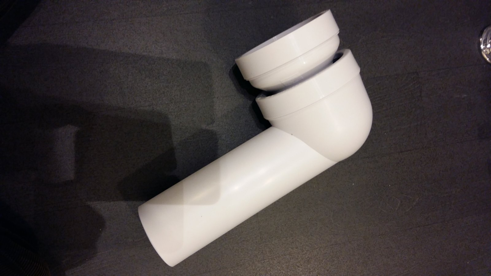

I'm struggling with WC Pan connector set up. A flexi won't work either as the radius is too tight.
Is it acceptable to stack like I've shown in the photos to extend out the neck?

Yes ,as long as it makes a water and air tight seal. I think McAlpine do an angled pan connector that will suit ,but I can't remember what their code is. I might try to dig out their catalogue.
Where are the seals for the other end !!
Thanks. Seals are just off while I was dry fitting to see what it looks like.
If you can find the code or screwfix number etc would be great.
Cheers
Its their code WC -con8E.
Extended inlet ,90° bend adjustable length.
Don't think screwfix or tool station stock them. Plumbers merchants would be your best bet.
Do yourself a favour in future and get decent "multiquik" pan connectors. Normally you would use a multiquik joiner piece if doing that. As the back of pan is smaller than soilpipe. Mccalpine do a extended neck pan connecter that does all that. Or even use a long flexible pan connector. :)
I think what I'm doing in my first picture is ok then but instead of a straight standard piece with the fins I should be using a straight extension because the diameter is bigger. This is what you've suggested I do. Cheers
The section in the floor looks like a ring seal fitting ,with no section of waste pipe in it. If that's so ,its unlikely to be a tight enough fit with the multi seal on the bottom of the angled pan connector.
