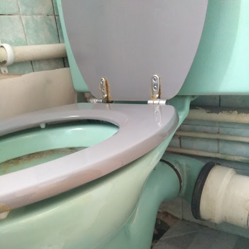

Hi All

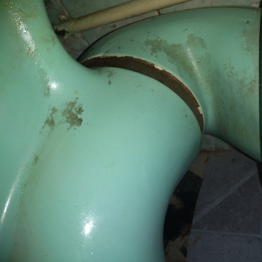

I am about to replace a WC and this old Ideal Standard has a unusual built in pan connector. ( swan neck style)

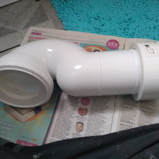

Does the connector in image 3 look about the best to replace it with ?
thanks

Only thing you can do is try and see, if it doesn't work the other options are use a flexi, (not ideal), rejig the soil pipe, or bring the new pan forward.

Thanks, I,ll probably bring forward, if I have to shorten the plastic soil pipe going into the vertical soil pipe what's the best way to cut it?

Cut the plastic pipe with a fine tooth saw. Take your time, the plastic becomes more brittle over time, you want to cut it, not shatter it!
