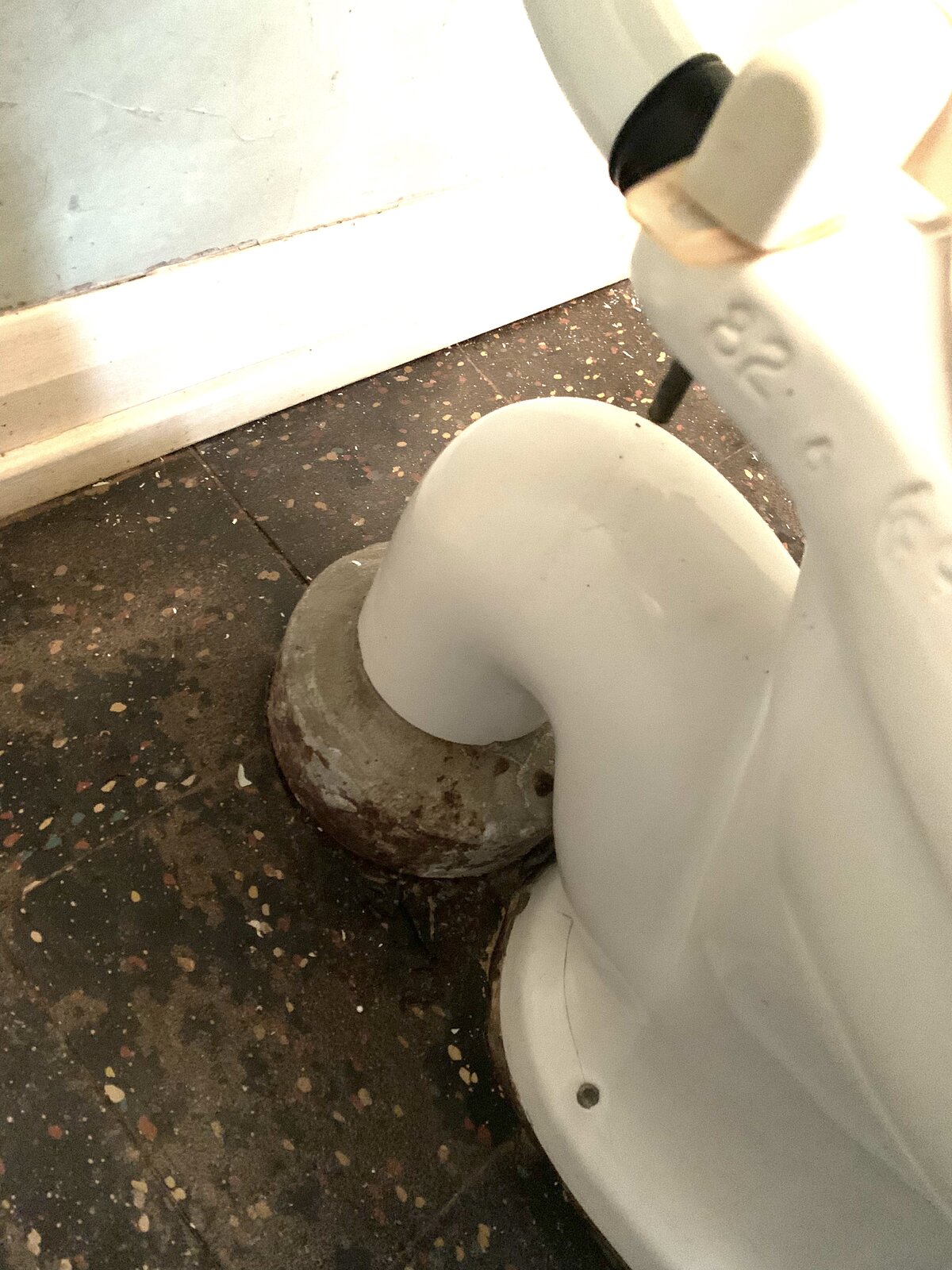

I'm trying to decide the best option to replace this downstairs loo. Is it possible to fit a swan neck or P-Pan connector to this old Iron? waste pipe. My understanding is that this is filled with hemp and fine cement. Is it possible grind it off flush with the floor, add UPVC insert and insert some sort of swan connector? e.g.
https://www.toolstation.com/swan-neck-pan-connector/p23824?
I'd like to get it as close to the wall aa possible as if I build it out, with a hidden cistern, the door will likely hit the loo.
Swan neck connector won’t get over that hurdle, you’d need a back to wall pan, with a bottom outlet.
thanks they all seem to look similar to the one I'm trying to remove and I still have the large cement ring which is about 9" by 3" proud. I'm wondering if I should get someone in to dig it out.

i could be wrong but I think the socket is a brown glazed clay pipe, and the mortar is infill.
The cement collar will break, probably when removing the pan. What you need to be careful of is damaging the drain collar itself. Once all cement out, you can use a couple of multikwiks if needed or a McAlpine DC1-BL.

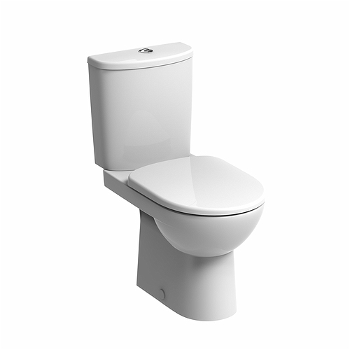

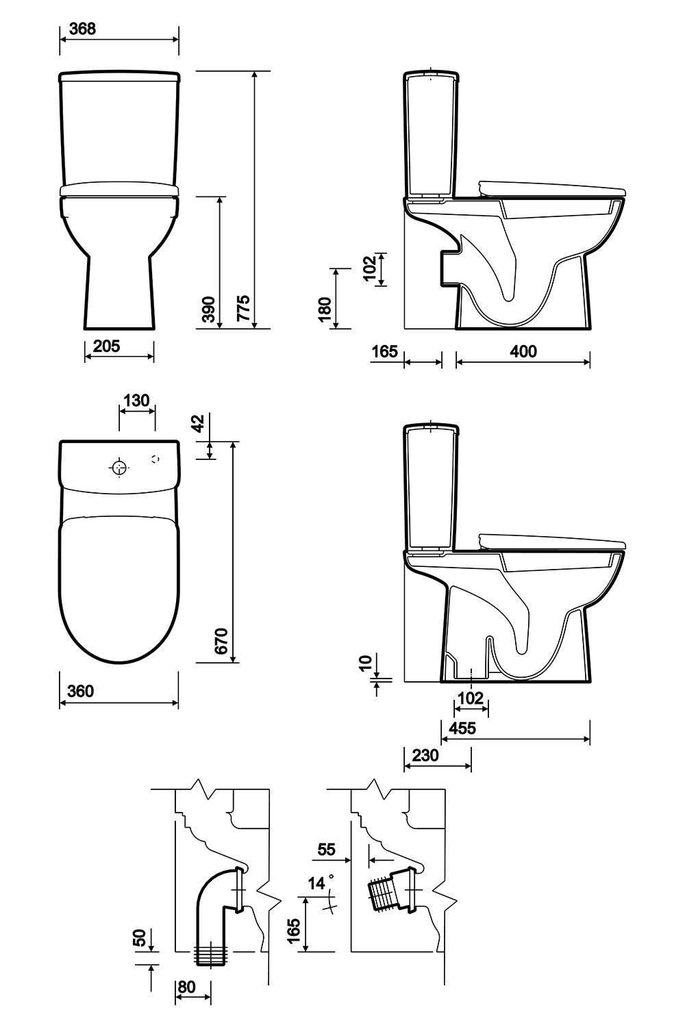

I fitted a Twyfords E100 BO, which is nominally 230mm hole centre to wall (you can make fine adjustment by chipping off plaster or adding a spacer behind the cistern. If you use the rubber socket adaptor it has a little bit of movement.
Flush is very good.
There are various BO pans, such as Alcona, but the distance wall to pipe varies.
Some Twyfords E100 are being rebranded Geberit Selnova, following a takeover a few years ago.
BO WC pans are not very common so you may have to look for stock. I got mine from QS at a good price but I'm not sure they still have it.
The is an HO version, more common, but not what you need.
You want the Round, not the Square.
There is a Standard version, and an improved (edit) Premium, which has an easy-clean smooth skirt round the base.
HO is horizontal outlet
BO is bottom outlet
i can't seem to find the technical drawing, but see
https://www.twyfordbathrooms.com/pr...nd-close-coupled-premium-toilet-pan-bo/12221/
E11145WH is the part no for the Standard BO, I have the Premium one, Product code E11248WH

I chose it because projection from wall is quite short, I see @jeff the gasman example is similar size.
I'll measure the size of the skirt if I remember.
