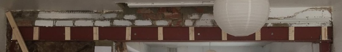

Here is a picture from inside if it helps. We have fitted 3x2 timber noggins approx 40cm apart(centres).

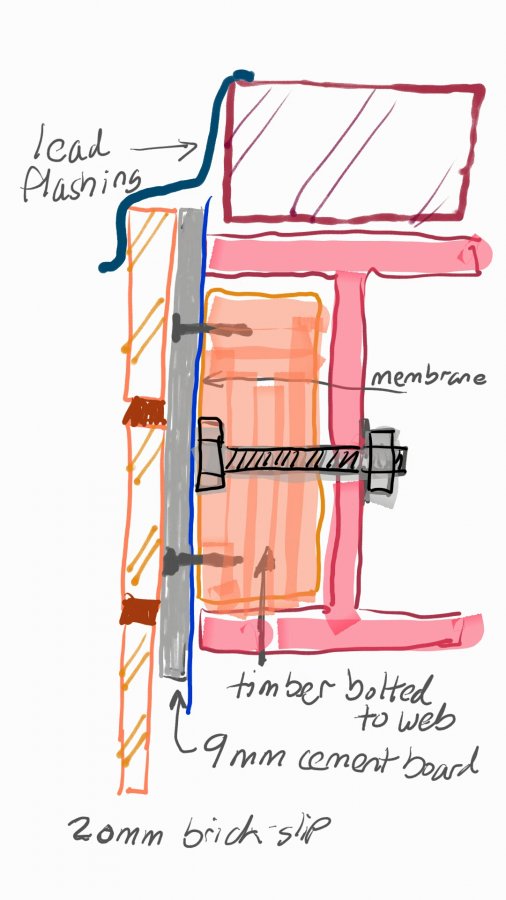

Here is the principle of slips in the beam.
It looks like the columns can be clad in closers ( ie bricks cut in half long-ways), of not the same principle will apply.
You might be able to recess the slips into the beam more than this by reducing the timber thickness. But the beam flanges (the top and bottom edges) do not align with the wall joints, so the slips will never match up with the wall. So there may be no advantage.

Thank you so much Woody! This is very very helpful.
This may be a very naive question, can the cement board be bolted in the web directly?
