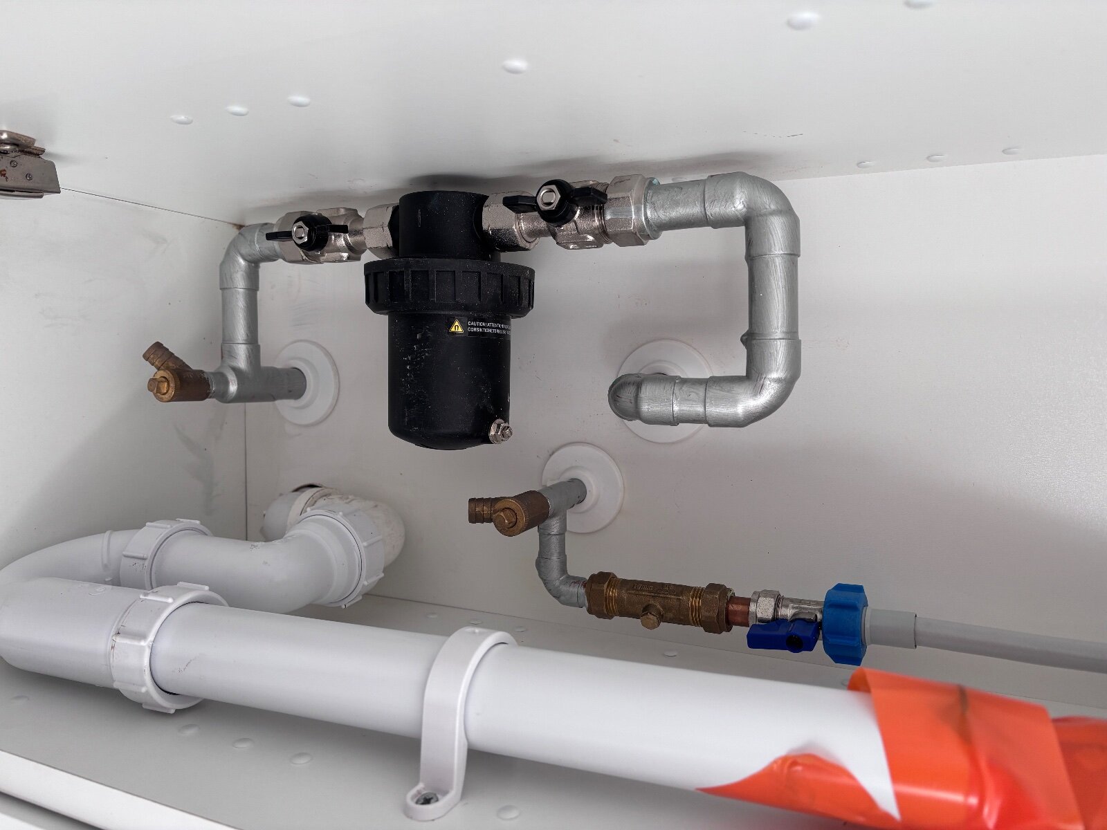

I can hear a constant running water sound from the cupboard next to my washing machine. I live in a 2-bedroom house. The washing machine isolator is off and all visible valves are closed, but the sound continues. No visible leaks. What could this be?
Condensing Combi boiler dribbles water out. Could that be what you can hear?
is your heating on when you hear it that looks like a central heating filter

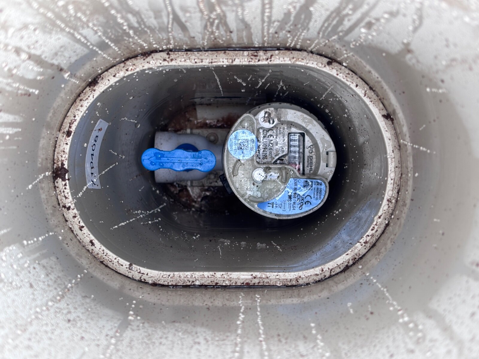

Go and check it see if its registering you may have a leak under the floor
