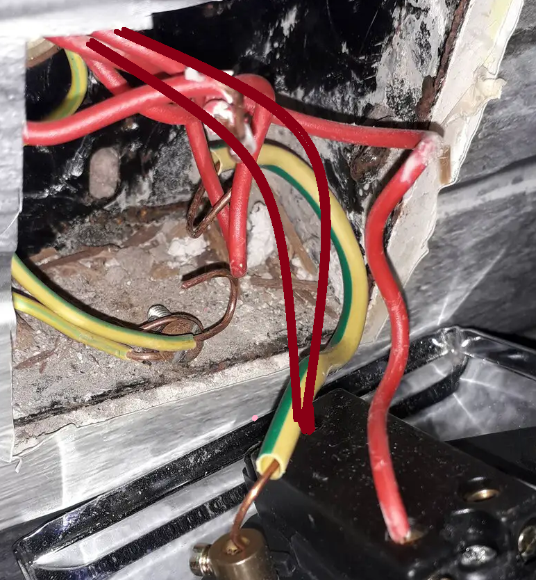

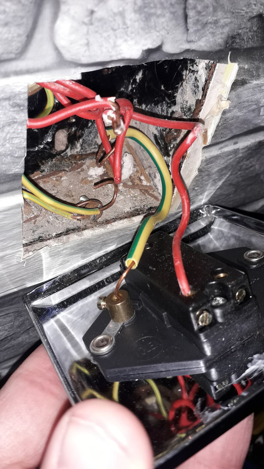

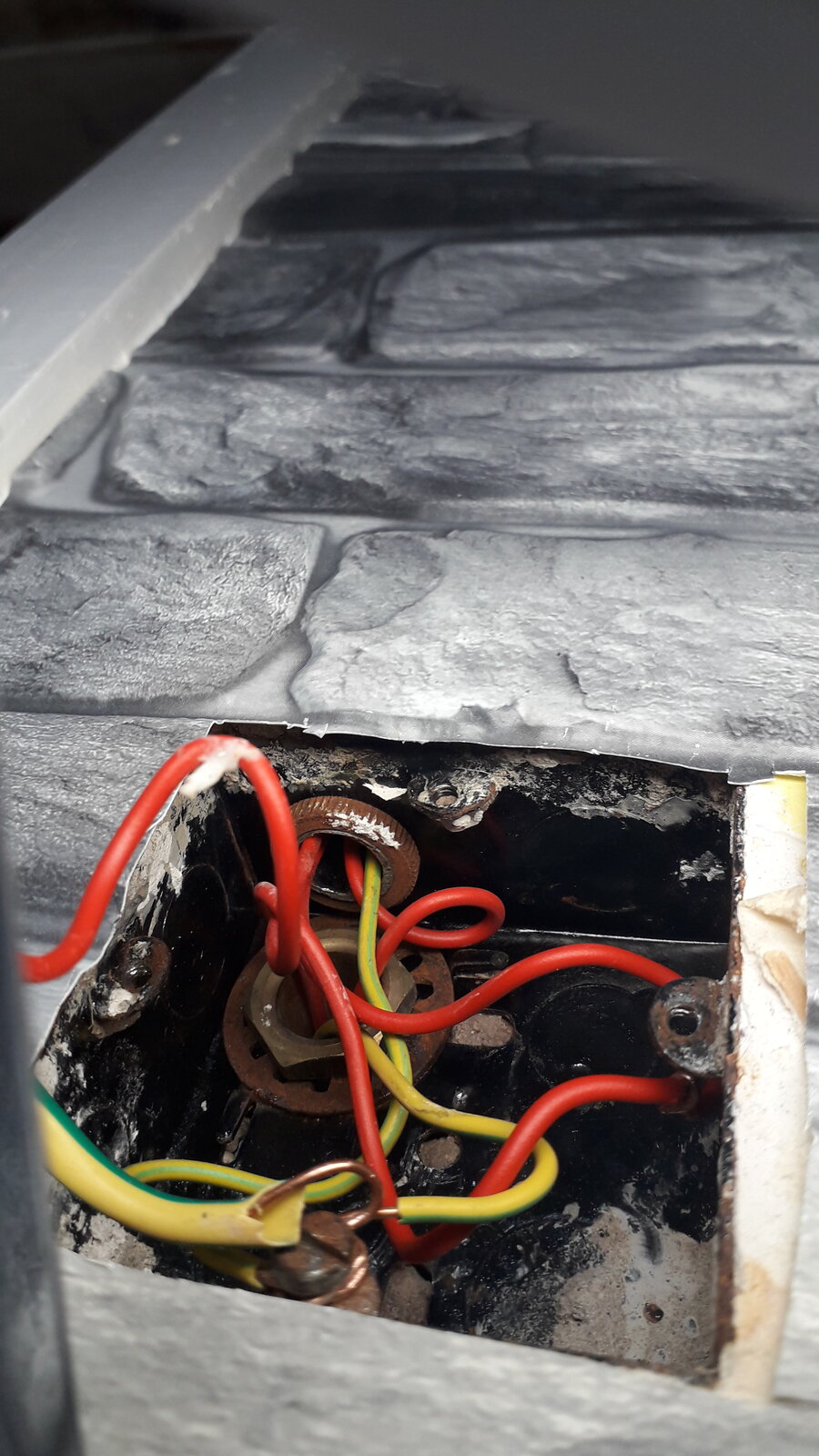

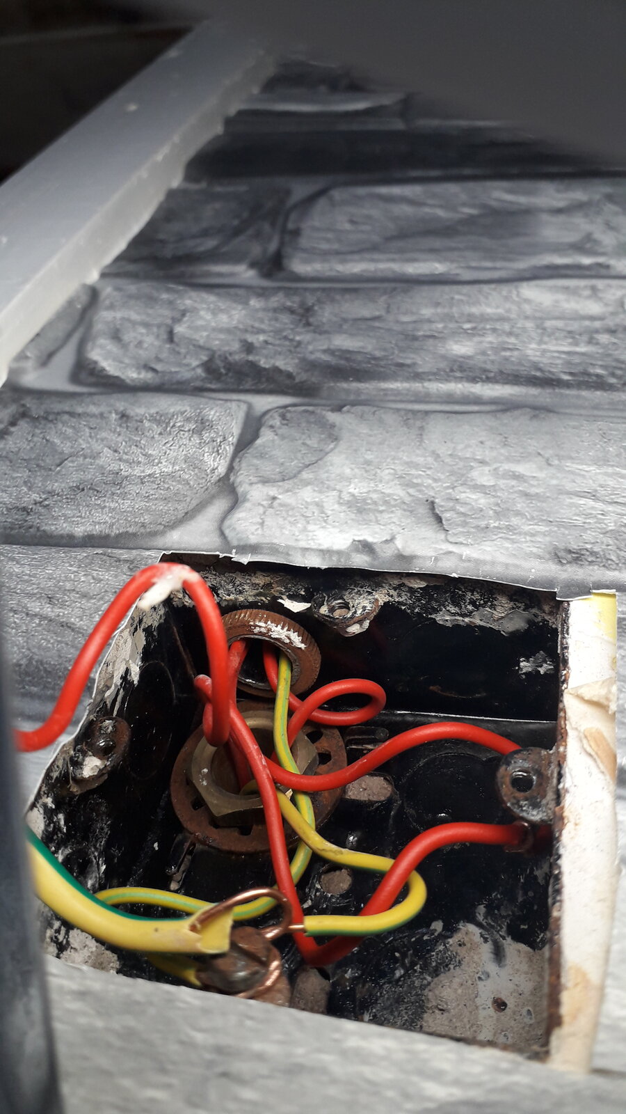

So was gluing some of those stone look PVC tiles to kitchen wall today. Thought I would do things properly and unscrewed the kitchen light switch to cut the hole out neat and have a professional look to things. So the tile sheets do look great around the light socket.
However some wires came lose in the light switch, and my kitchen light and living room light (room next door) no longer work. I have tried a few things but can't either to work. Never seen a light switch wiring like this before.
The red live wire is still connected fine. I am not sure what to do with the 3 green/yellow earth wires. I *think* at least 2 of the green/yellow wires were wrapped around a screw located in middle bottom of light switch (the screw is not part of the switch panel or used otherwise). If anyone can help advise what needs to be done and what needs to go where, will be most grateful.
I attach a photo.

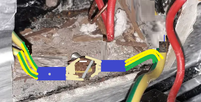

The 3 green and yellow wires are wrapped around that screw, which should then be screwed in a hole in the metal backing box.
You 'appear' to have a live feed to the switch but there are 3 reds coming from the top of the back box in the background. This means the other two reds should be attached to the hole at the top of the switch, furthest away from the red that's connected.
Make sure power is turned off first!!!

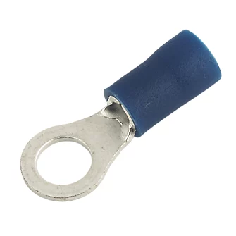

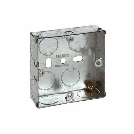

I think the screw is in the bottom lug of a 4 lug box similar to this
so I'm not surprised they came off. They'd more likely be more stable if all twisted together but then would be a chunky thing to bend round it. These would be even better
Thanks for all the suggestions. So I did put all the yellow/green earth wires round the screw like in last photo. I realised I could just loosen the screw also and get a good fit, then tighten it up. I realised the 2 red wires that joined which were quite blackened had probably blew at some point and there had been a trip. So I cut them back a bit and reconnected them also. It all looked good.

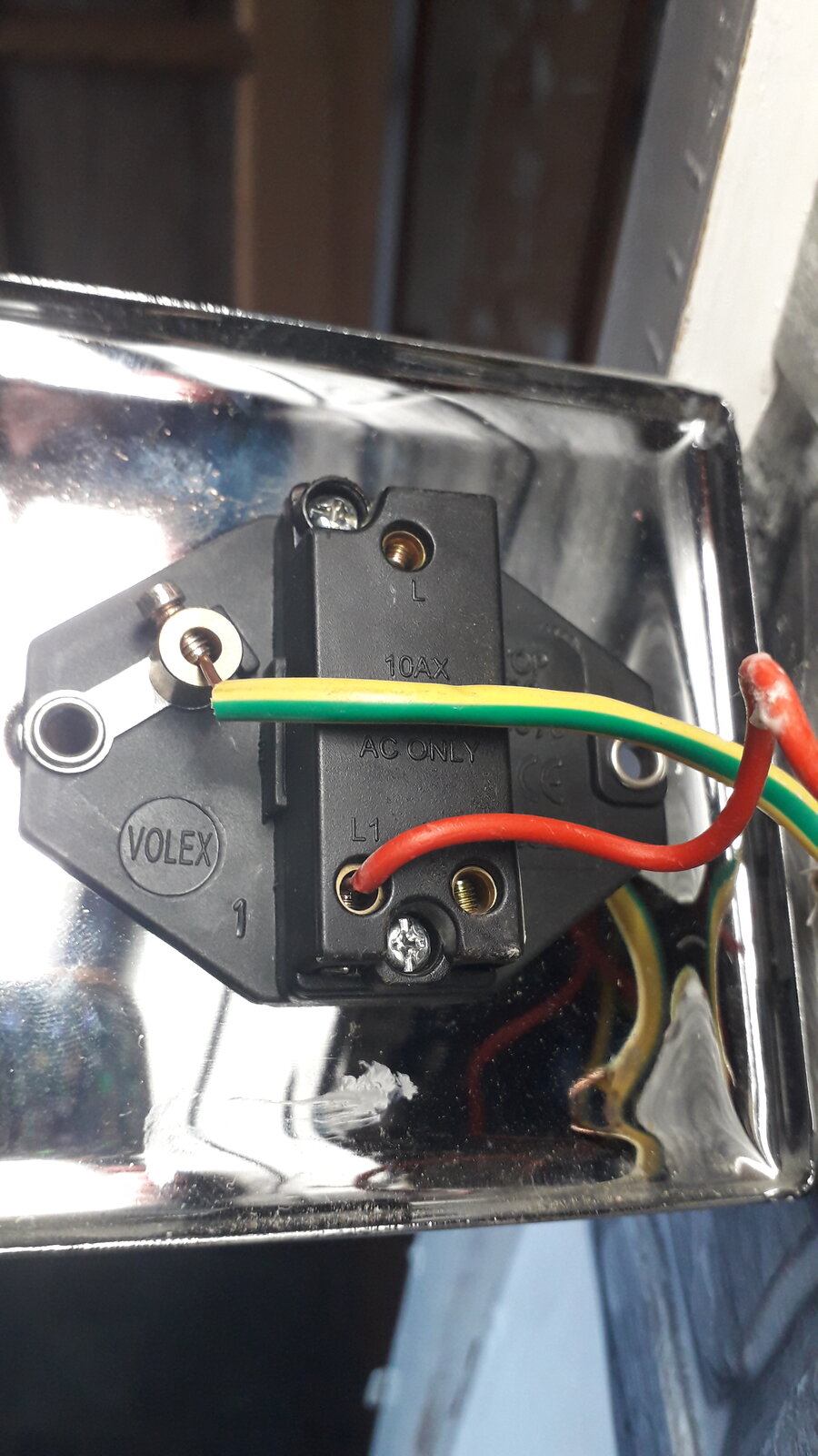

As the living room light is now working, after re connecting the 2 loose red wires, I suspect you may not have put them both into the com terminal in the switch. The com terminal is the single terminal at the opposite end to the terminal that contained the single red wire .
The earth conductors have nothing to do with your kitchen light not working.

To confirm Conny and Terry's advice it would normally be looking something similar to this although I can't tell in the tangle which I should have aimed for in the top left. (although there are odd switches around with terminals in different positions to normal). The common terminal is usually marked as 'COM' or 'C' or 'L'. Other selections of markings exist, do let us know what yours are if the pic doesn't work.

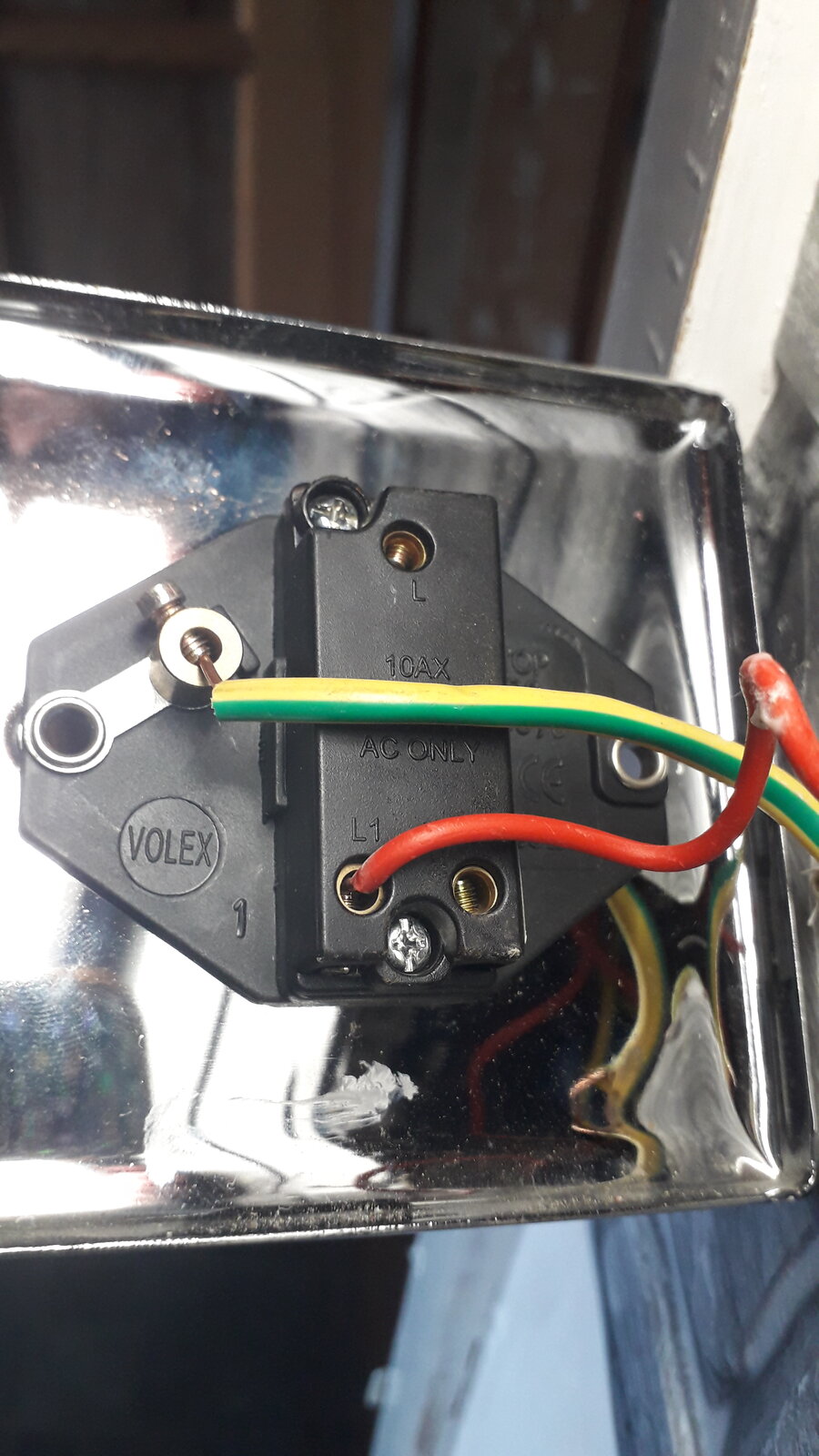

On the switch there is:
L (top) - empty
L1 (bottom left) - red wire in here
L2 (bottom right) - empty
As attached photo.

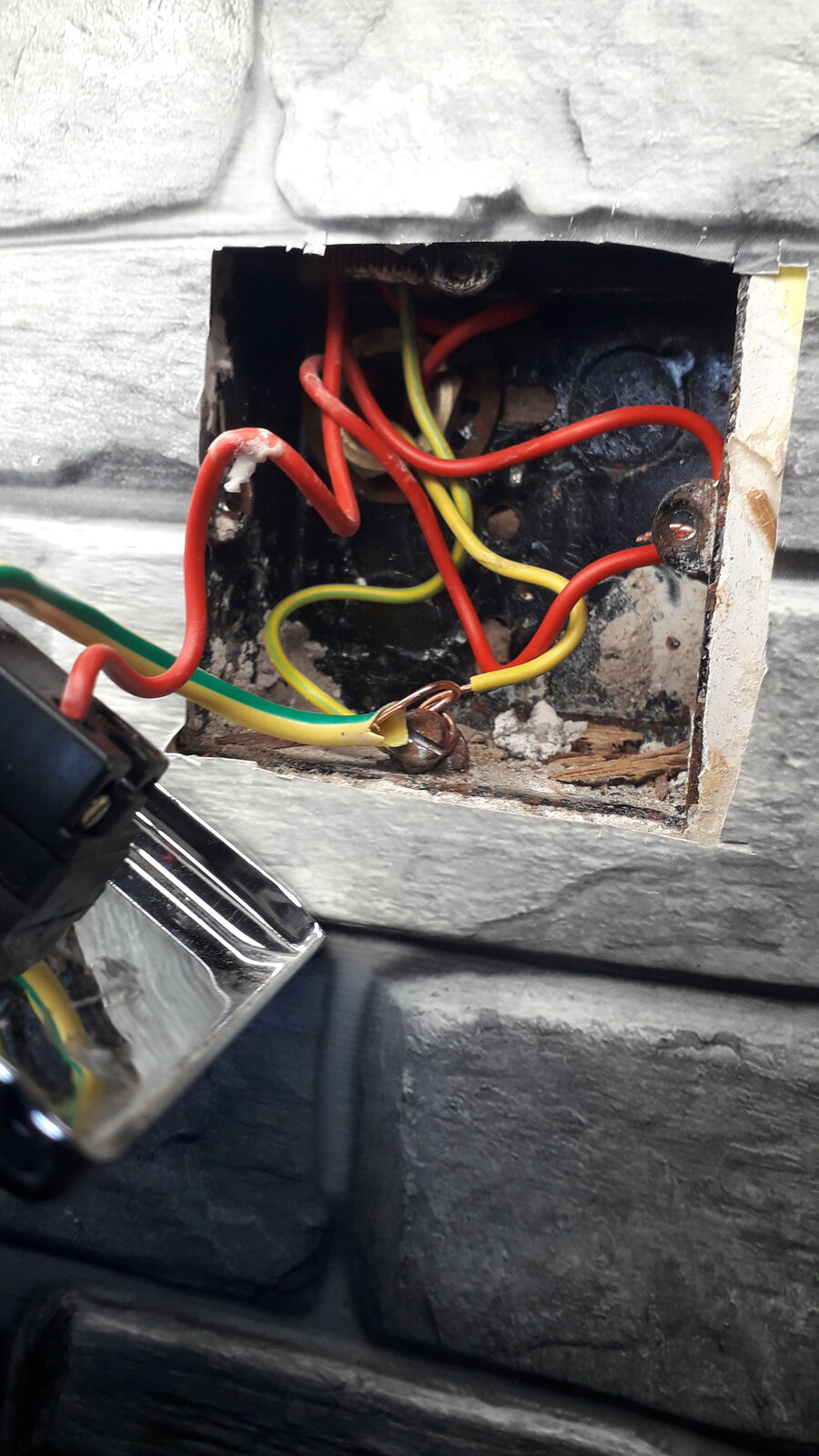

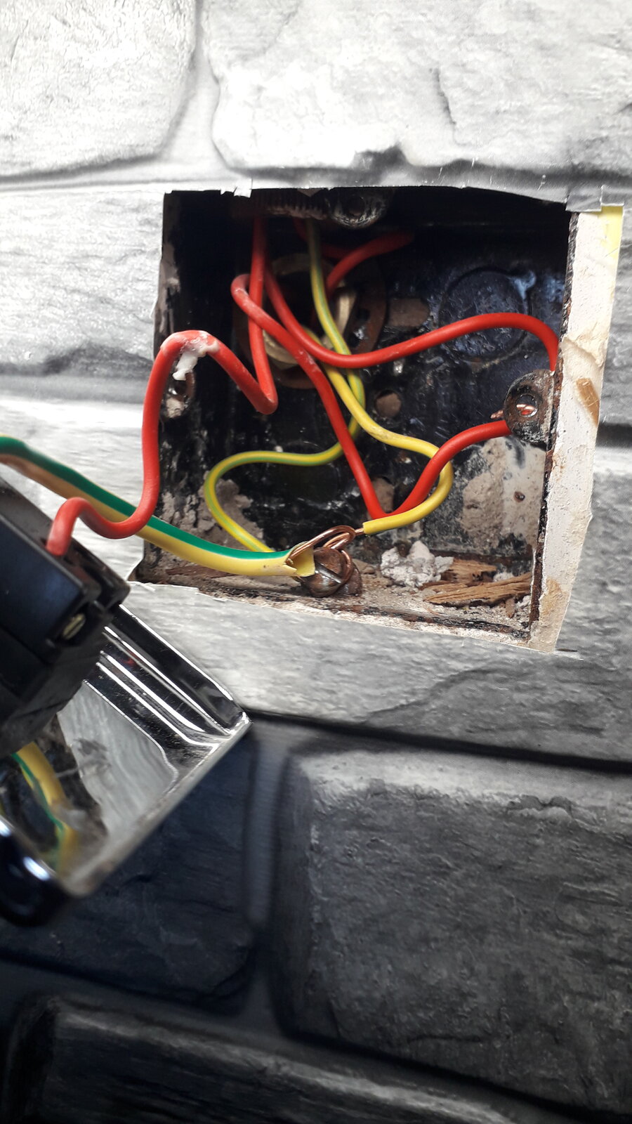

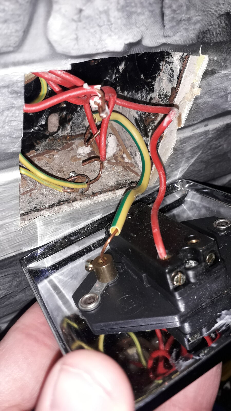

So this is what looks like now. All 3 yellow/green wires are attached to the screw tightly. I am not sure all 3 were though. I have this thought maybe 2 were and 1 was just loose (but not with a termination blocker as none were in place). The red wire to the right middle, is actually 2 red wires connected to each other, the bit I tidied. You can't see the wires connect as hidden beside the screw slot middle right.

Lastly this photo for completeness shows the top of the inside just so can see what wires are coming out from the inside of wall.
To answer a previous question. Yes something did blow when I was assessing the light and moving it around and trying to turn it on/off. The consumer unit in a hallway cupboard, the light switch tripped at that time. At the moment nothing is tripped. I also tidied up the red wires and cut back for reason of there was a little glue from the wall tile sheet had got on a bit and it felt sensible to tidy it up.

You aren't making a lot of sense.
With only one red wire connected to the switch it can't operate anything.
The two red wires connected together need to go together in switches com terminal (L on your switch).

So the good news is I have now done what you @terryplumb @SUNRAY and @conny have all suggested and put the 2 red wires into the L, and hey presto kitchen and living room light both working tickety boo.
