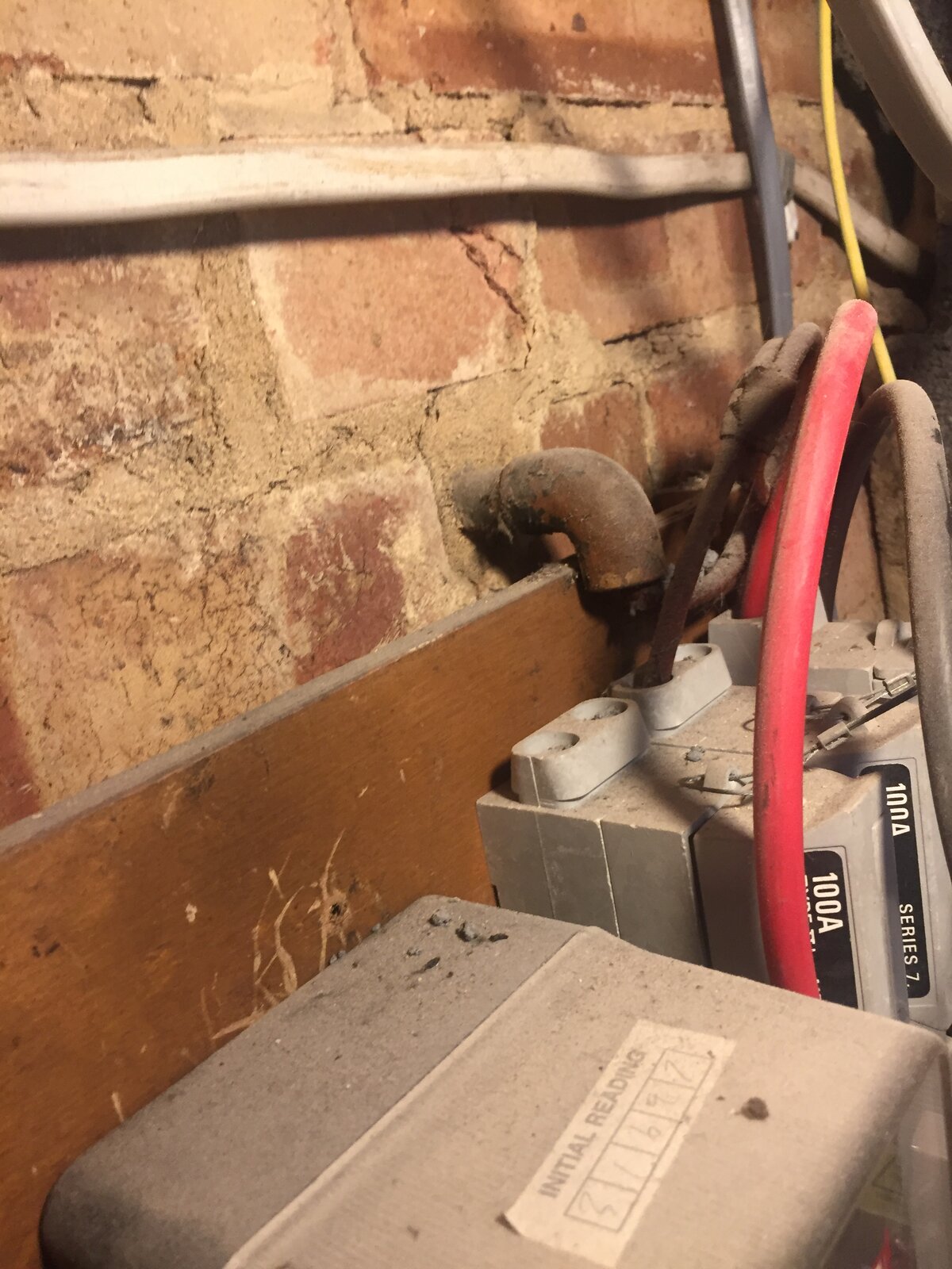

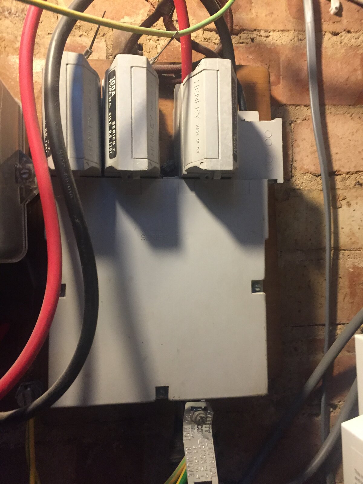

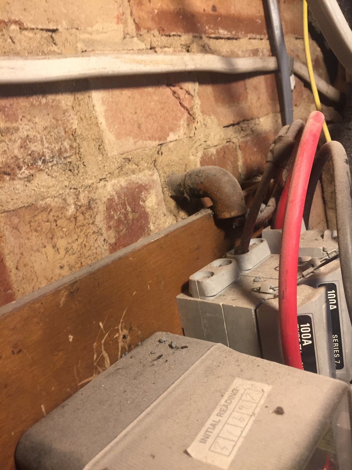

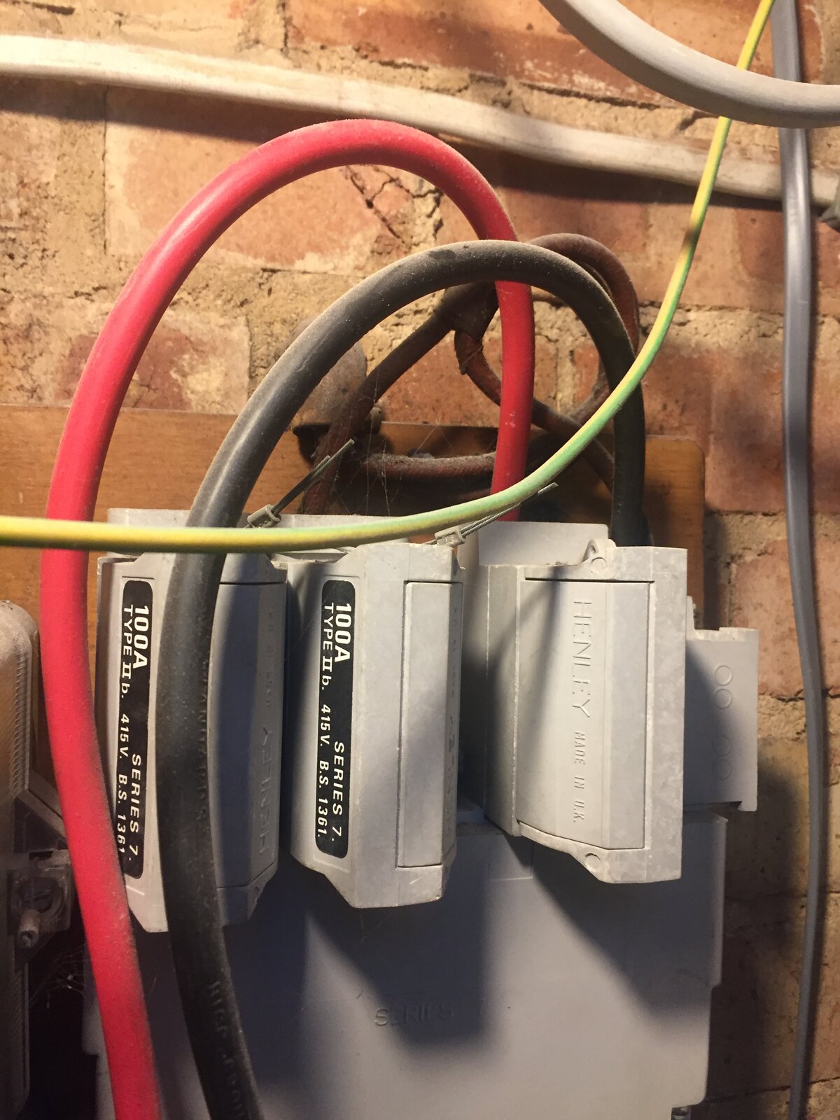

Hiya,
here are the pics, my fuse on right hand side, neighbours in middle, and spare on left, U can also see my main earthing point on main incoming clamp .

It looks to me from those photos that there is no provision at all for an earth to your neighbour's property. The DNO is not obliged to provide an earth - it may be that they never did, and the other property should have been equipped with an earth rod from the beginning (TT earthing system) and that this was overlooked - i.e. that property has never had an earth connection to anything.
I guess it's possible that they did provide an earth initially but that someone removed it and then took no steps to "TT" the other property. It is also possible the the other property does have an earth rod, but that this or the connections to it have deteriorated.
Without seeing what is on the other side of the wall, we can only speculate.
Does that look like the right type of clamp for the earth - or just a DIY job with the wrong clamp ?
