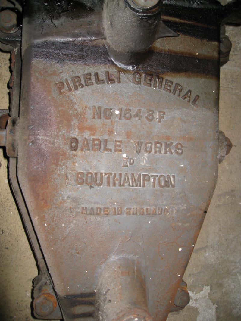

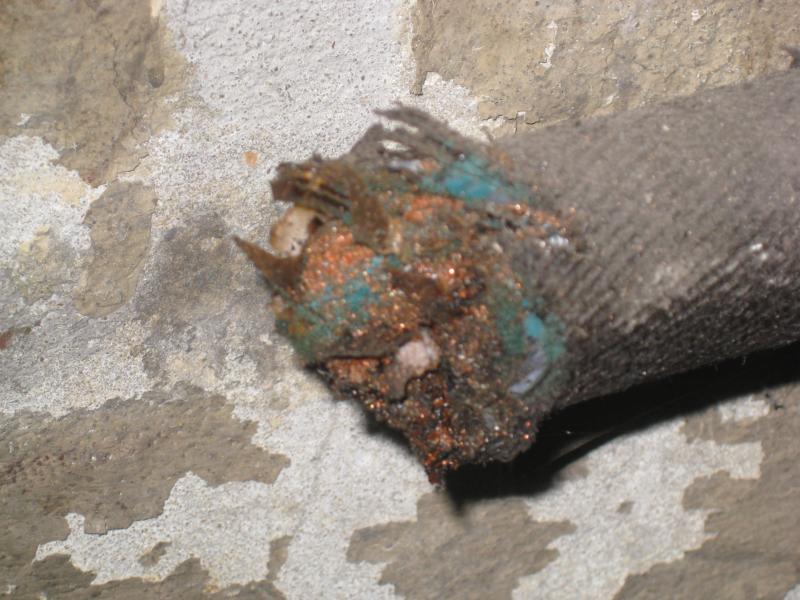

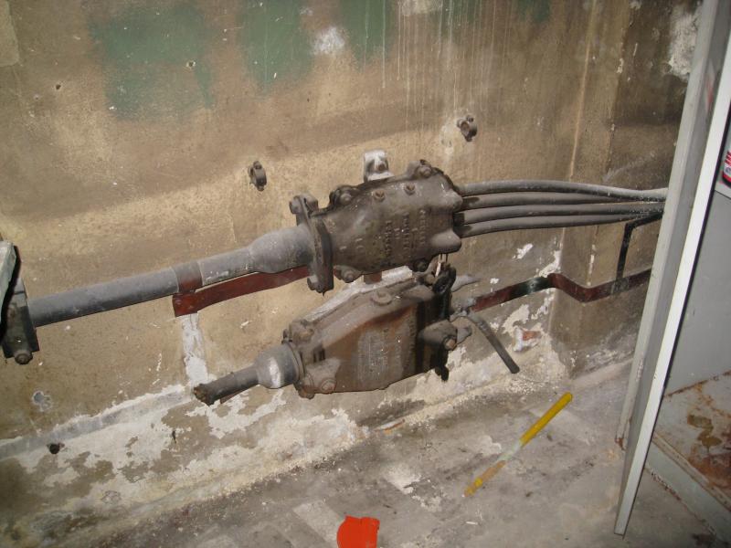

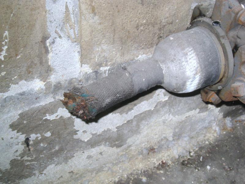

This is the best I can do to show what we mean.
PILC feeder, and then VIR in conduit through to next door.
Electrospark is working on the other end of this supply.
This is the best I can do to show what we mean. PILC feeder, and then VIR in conduit through to next door. Electrospark is working on the other end of this supply.
Yes, as I said, I understand now. Thanks. In fact, the first house I can recal from my youth had a setup just like that (the end in your photo, not Electrospark's end), albeit the cutout was cast iron - however, I was too young at the time to take any interest in the nature of the insulation of the cables going to 'next door'!
