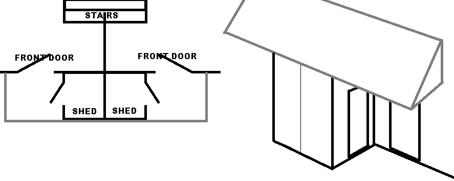

Having a 2 or 3 phase supply into one property was fairly common right into the 70's and possibly 80's where the fuse box was in the cupboard or as many called them 'shed' near the front door, My sisters first house was like that.
The word 'shed' is somewhat unintuitive. The irony is I have worked in 2 such properties recently but they are both in pedestrian walkway locations and not visible on Street View, hopefully this sketch will offer a better idea:
upload_2020-10-18_1-0-34-png.208388
Typically there are a pair of walk in cupboards, my 2 recent are ~3x3ft and 5x3ft, which are often crammed to the gunwals with the sort of things usually found in the garden shed. It usually contains the meters and CU and commonly one has the I/C services. With a single head it's a perfect example of my 'Two Services'. May be 2ph but bearing in mind these date from >40years ago when power demand was nowhere near todays it's commonly 1ph with 2 fuses and sometimes even just the one fuse.
If we're still referring to OPs situation either #3 or #4 could very easily be appropriate
