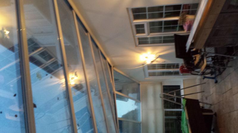

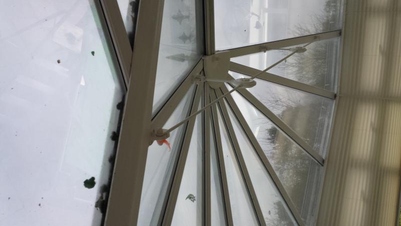

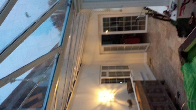

My conservatory ceiling windows and white plastic bits are getting wet to the point where it collects in the white bits then drips out or down the wall.
Do i need to heat the conservatory at night or do i need to leave the ceiling fan at night on to circulate the air, I thought there might be a leak but I've checked and theres not so its got to be condensation.
Any advice will be most grateful.
What type of roof have you got.....I'm going to guess that the roof bars are aluminium with a plastic cover strip ( post a pic if you can ).
Sorry few questions first..
First question is , do you dry clothes in conservatory?
Do you heat it during the day?,
Are the doors between your house and conservatory open all the time?
Hi yes ally and plastic cover strips i have 2 sets of double doors that you can use to enter and no not open all the time i have 2 heaters in there but never use them..and i have a pic in my album but dont know how to link it to here
