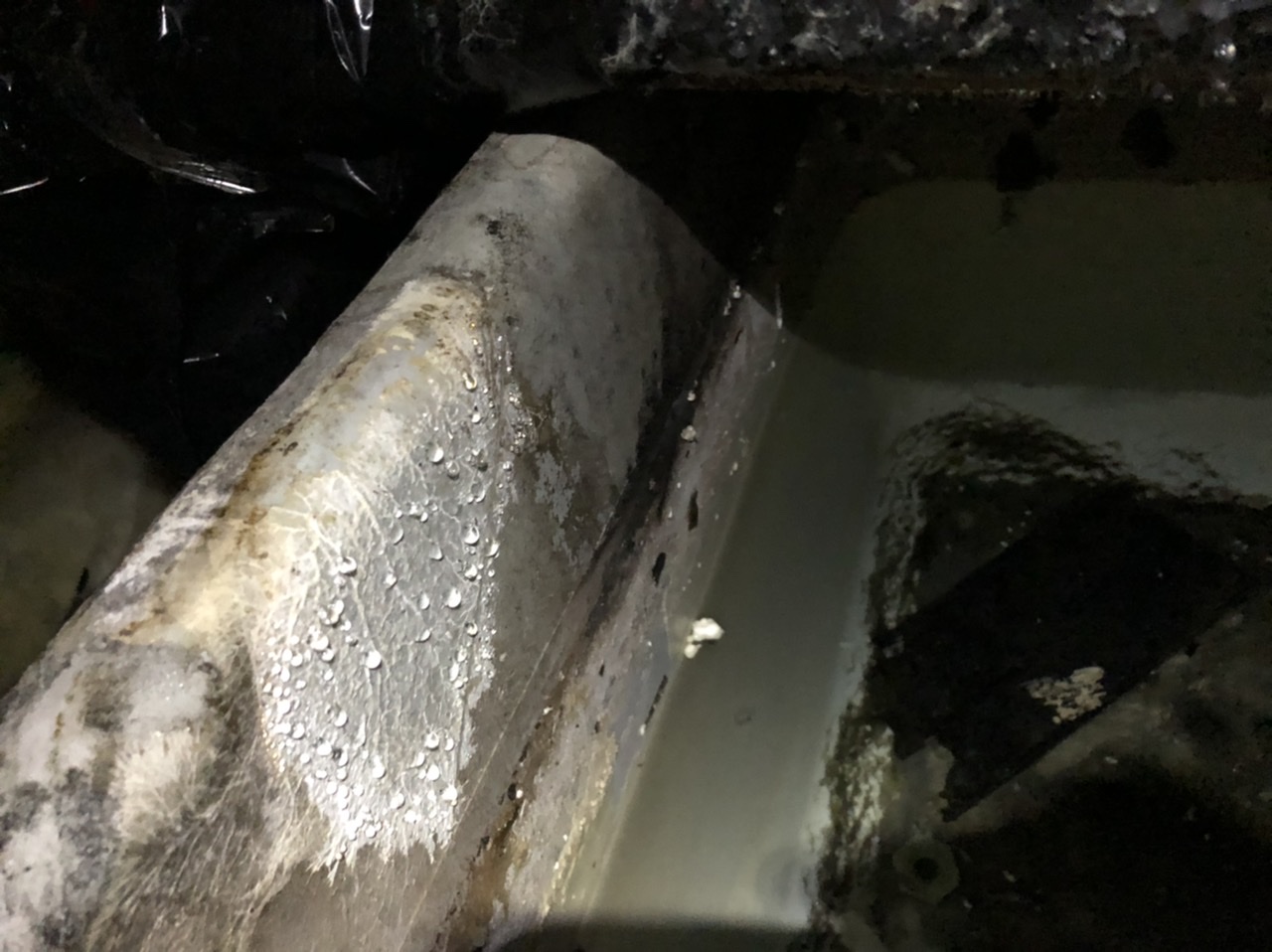

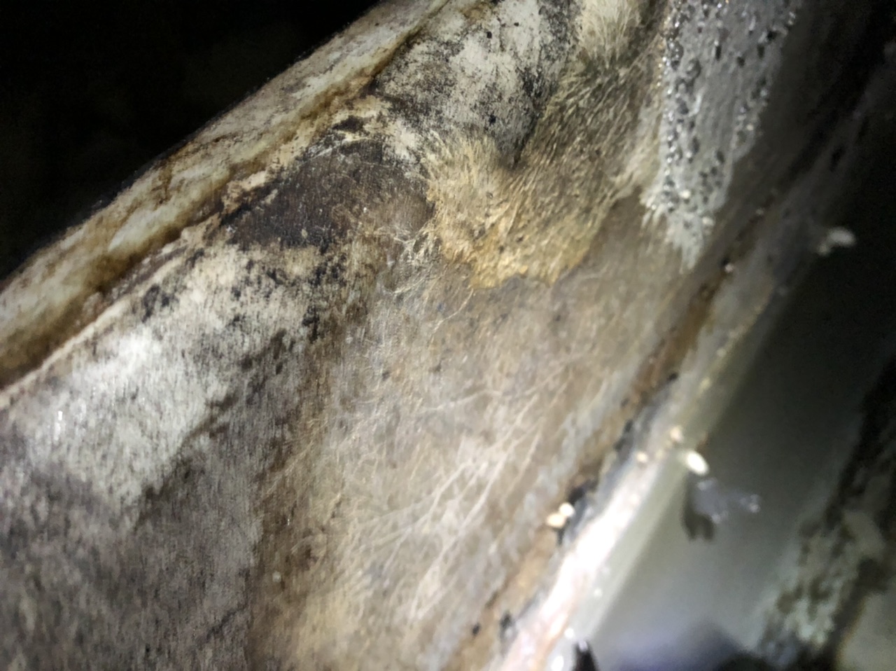

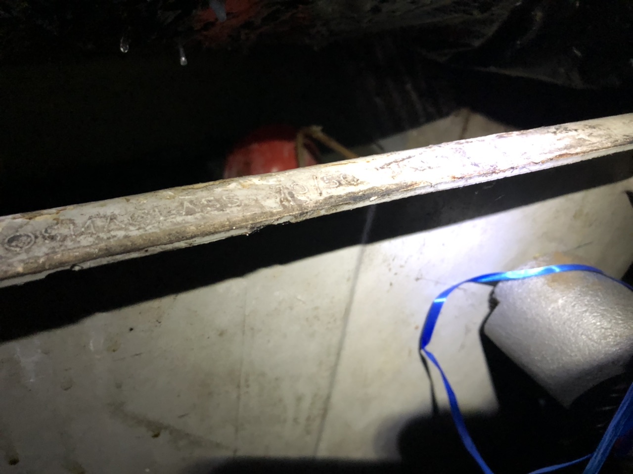

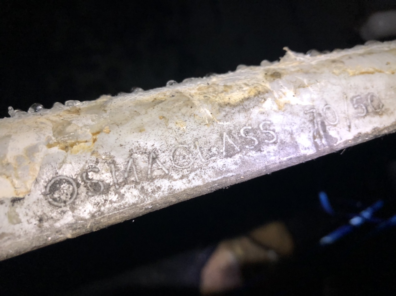

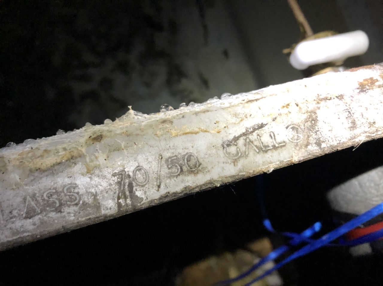

    Hi,
    I’ve got a pretty manky cold water tank in my loft that I’d like to clean up and fit/make a lid for. But after I started reading about tanks I found out they can sometimes be made of asbestos.. Now I don’t think mine is, it feels like plastic/fibreglass and it bends and flexes with a bit of pressure. Can anyone confirm from the pictures?
    Thanks!
    A68BEA4D-ECAD-452A-8604-03113E8EAC62.jpeg E74E80C2-BBBF-471C-B521-21246942449C.jpeg BD72714E-B479-4EE5-BBC1-F4A0202BDC5C.jpeg 1DC9DAF9-FF22-45AC-A774-D78B8ED5E712.jpeg 27A98F4E-2E7E-4816-B97B-BED9CFEBCF14.jpeg 13ACD4F8-8E39-4F3A-B2D7-8B4030EE4B83.jpeg CE31EC2F-967C-42A4-86A6-BFC421ADFA37.jpeg

    Fibreglass, popular in the late 60’s - 70’s but never came with lids!

    GRP or fibreglass
