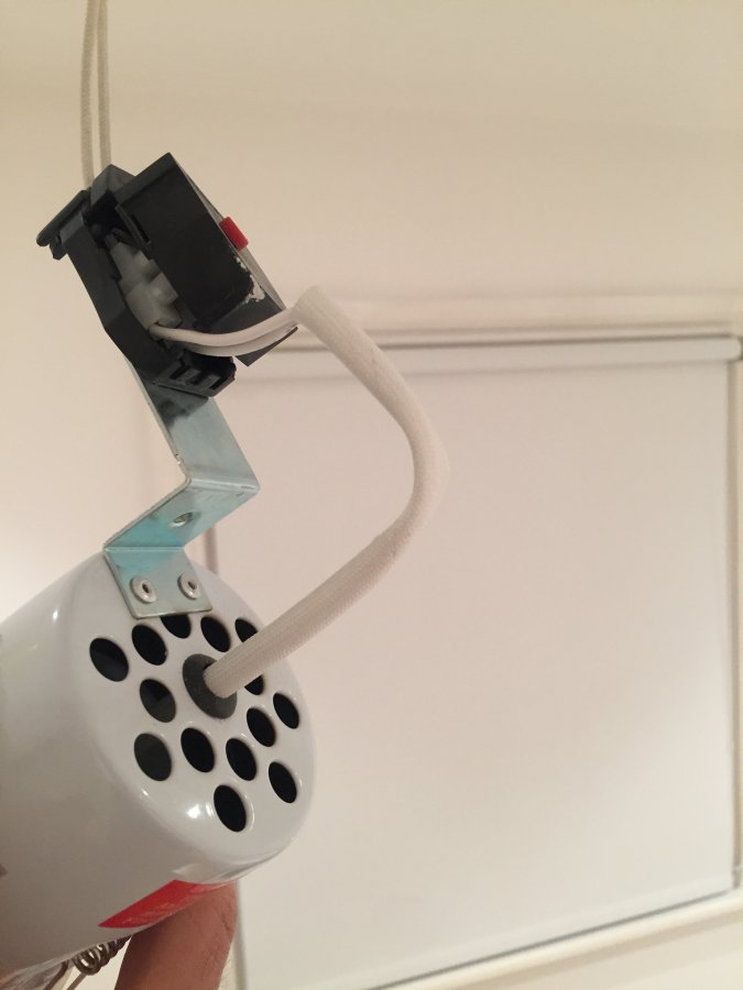

I am constantly finding myself having to replace this white wire in my ceiling lamps. I replace it, it works for few weeks then stops. When examining the wire it seems burnt down from the heat, I replace it and again it repeats itself.
Any idea what am I doing wrong? Perhaps I need to buy better quality ones? Any suggestions?

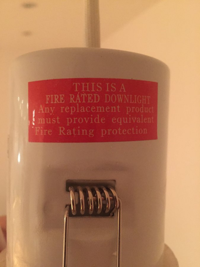

What does that red label say?

Here's what the sticker says, so perhaps I should be using specific wire or lamp?
That's not relevant.
If the room above is also your property, fire rated fittings may not even be necessary nor required.
It's odd that you didn't post a picture of the burnt part.
Presumably you must be replacing the lamp holder as well?
Thanks.
The floor above also belongs to me yes.
When I say 'burnt' I mean this white wire connected to the lamp holder exposed and looks like the plastic cover of its wire turned black which to me indicates high heat and burning.
I don't replace the lamp holder when it happens only the wire however given that it sporadically happens with different lamps something tells me I'm either using the wrong wires or the wrong lamp...?

I was assuming (and I think others too) that they were GU fittings (or similar) which only come with wires fitted.
Are they R80s (or similar) with an SES lamp holder?
Is the lamp holder making a poor contact with the wires or the lamp, thus creating excess heat?
I too had assumed they were GU lamp holders, doesn't look big enough to be an R80.
I'm curious, if they are GU, how the OP is replacing the cable but not the lamp holder. This fact, or the lamp holder may be the issue.
Also, the top of that can looks mint, no signs of overheating or even age discolouration, so I'm going for a high resistance joint somewhere causing the heat over the wrong lamps.
