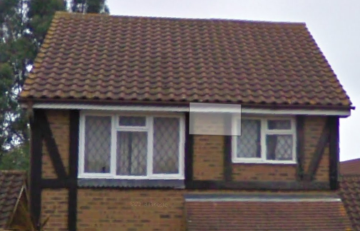

Hi,
What are those black wooden slats called?
If I want to repaint those what paint should I use?
Thank you.
Mock tudor beams. That's what I call them.
façade beams.
Coat in Zinsser all coat or Dulux Ultimate Opaque black.
Other paints you can use I guess. Depends what on there already
It is imitation half-timbering, an ornamental feature intended to bear some resemblance to 500 year old construction.
I would use a water-repellent stain, as sold for sheds.
If it has previously had some other kind of treatment, it would be better to use the same again. Sadolin is quite popular.
I used Bedec Barn Paint on mine. Wonderful stuff and needs little preparation if any.
