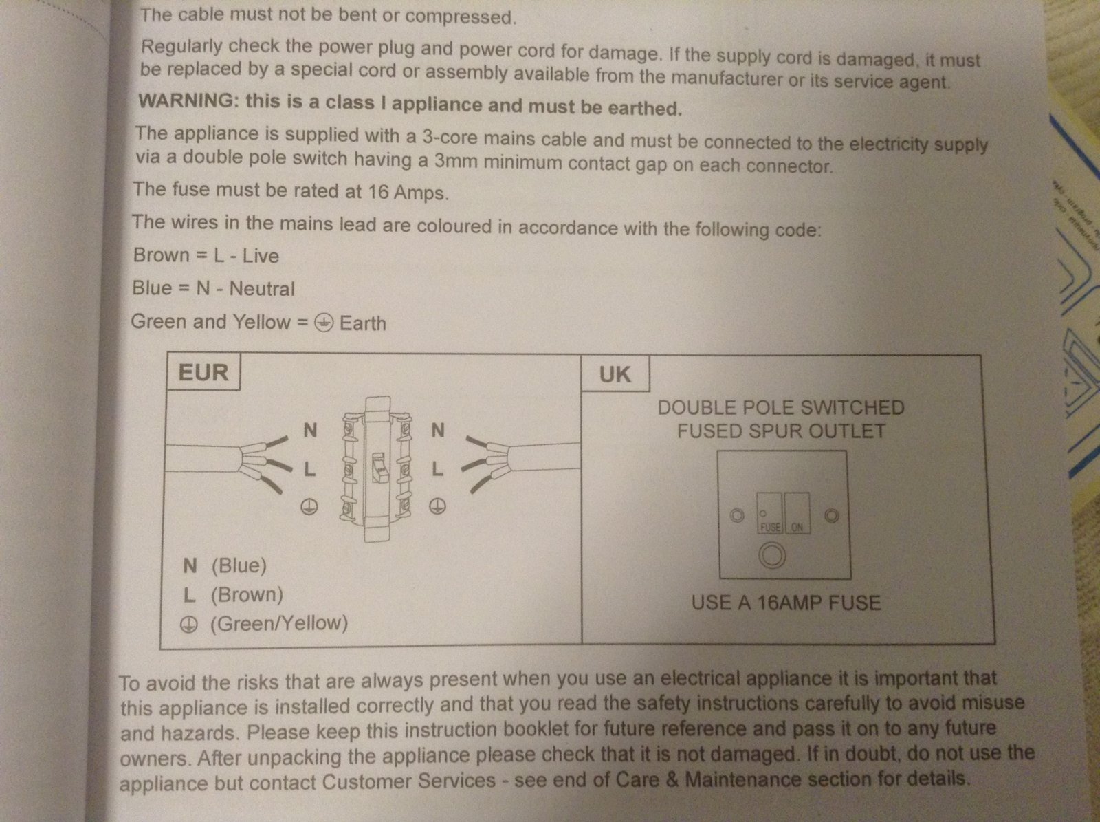

Ignoring Taylortwocities who clearly does not care about safety would you follow these manufacturers instructions.
It is B&Q by the way.
What's wrong with these instructions?
They're crystal clear to me.
Winnie has found one example of MIs that are not correct. He keeps wheeling this example out and spouting that obviously) all MIs are not to be trusted.
crystal clear?
Where would you buy a 16A fuse to go in the FCU?
despite their physical size, usually ovens are a lot lower current than you'd think. hobs use more. Electric showers are the worst though.

As far as I know stoves and ovens etc depend on the current they draw. 13A can be connected to a socket circuit and if it comes with a plug can be plugged in but complicated as the on off switch should be accessible. The plug is ok as it has a 13A fuse in it. An alternative is a 16A MCB which effectively means it's own feed from the CU.
A model from europe may draw 3.6kw so needs it's own connection to the CU as does the usual electric stove and hob set up.
The site guide is clearer on this area as it mentions that kitchens these days consume far more power than they used to. One catch with that is some electrician will fit a 20amp circuit for kitchens on the basis that all it needs is a few sockets. They might fit a separate circuit for fixed equipment though. So in real terms this needs considering and also anything else connected to the circuit. These things seldom draw full power all of the time but if there is a number of them, stove, hob, drier, washing machine, kettle ;) in my case an espresso machine, somebody might even plug in an electric fire................................
Built in units using a plug ? Common sense says don't do that unless the plug can be seen and has a switch. Some things may come fitted with plug and mention some where in the instruction that this is for testing.
These are all shoulds rather than shalls other than drawing too high a current but they are pretty sensible ones. Likely to turn into shalls at some point.

As far as I know stoves and ovens etc depend on the current they draw. 13A can be connected to a socket circuit and if it comes with a plug can be plugged in.
Well…it CAN be plugged in to a ring final, but SHOULD it be?
The guidance in BS7671 is that loads of more than 2KW should be on their own circuit, rather than plugged into an RFC.
