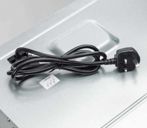

It depends upon the oven. Both of mine came with a 13A plug fitted.
The ones we're looking at are more like 30A and the electrician has it on a big chunky cable running off a 32A fuse but it's an all electric cooker/hob thing. Which is why I expected it would have to be hard-wired
