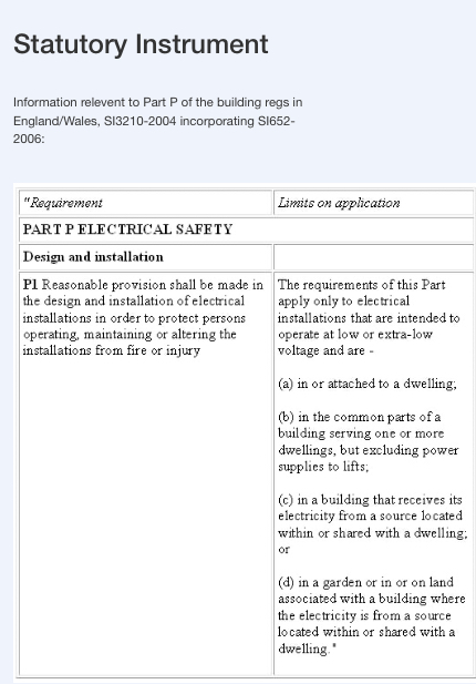

The Building Regs are the only la with which one has to comply and, as far as electrical work is concerned, that consists of just one sentence ("Part P") which essentially just says that electrical work must be done safely.
"The Regulations" which we discuss, debate and attempt to interpret here are BS 7671 (aka The IET Wiring Regulations) which are non-mandatory and have no force in law.
I think there is a misunderstanding there. It is part of building regulations. In a sense these have no force in law but what matters is the outcome. Say some one builds something that departs from in some way they can be made to take them down. BS7671 in many respects is privatised building regs enforcement some aspects of which can also be handled by local building control. The equivalent taken down here is disconnection and don't use stickers. There are others about that have no force in law. The party wall act for instance.
The only law (statutory instrument) is Building Regulations Part P.
This is it
Along side this is the Approved Document for Part P. This is a guide to advise how the law can be complied with.
In the approved document is says that a way to comply is to follow BS7671. You could install your electrics to a completely different standard, but you would have to be prepared to convice an overseeing body (LABC, for instance) that your approach is acceptable.
LABC don’t have the wish to mess around , so they use the Approved Document, with its notification requirements, as the Bible by which electrical installations shall be carried out.
