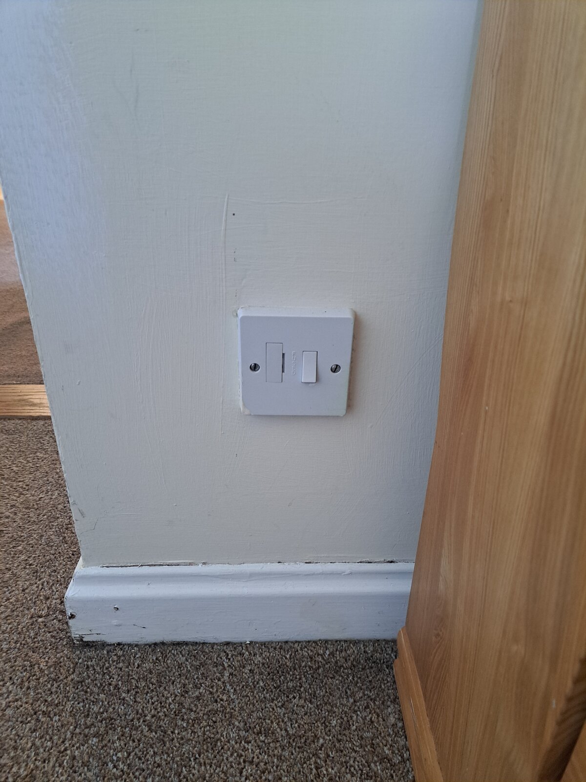

Hi all
I have these in my house just bought, are they isolation switches? do leave them all on in every room?
Switched fused connection units (FCUs). Do you or did you have electric heaters/storage heater or anything similar? Is there any indication in you consumer units (CU) of circuits for something like that?
If you post a photo of your CU with the flap open it might give us a clue.
Thats it just been in house a month and not sure, rads are oil boiler...no electric heaters, there is even one in toilet wall...dont know to leave them on or not. I thought they would be isolation points for overloads and they blow instead of main fuse?
They are generally used to supply an item of fixed equipment. The questions are which circuit in your CU are they fed from and what are they supplying. You could turn them off in turn and see what stops working.

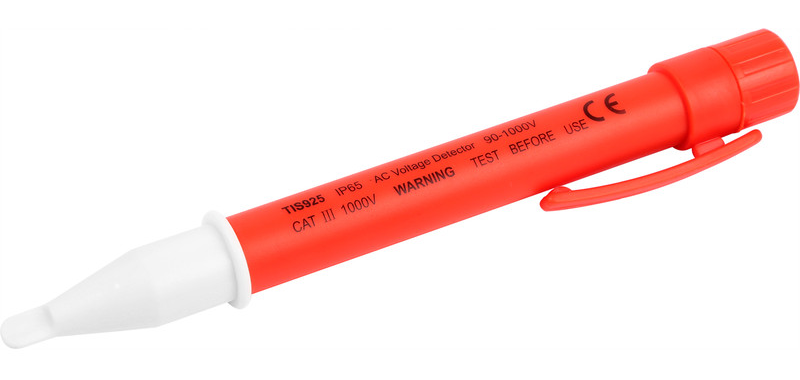

I have one built into my clamp on so never used these 1697026485698.pngbut they are cheap enough (£8 Toolstation) and you can work out what they are fed from and also likely what they feed using that simple tester.

The one in the picture is already off, so that’s not going to work!!
@iTRYer need you to (carefully) unscrew one of the plates and photo the connections within.
Maybe there’s nothing connected to the output side of the switch!
your strategy is to turn the FCU off to discover what then does not work. If the FCU is already off then you won’t be able see what doesn’t work because they were off in the first place..
If all off why can’t you see what’s not working, please explain ?

The first thing I would do is look to see if the FCU has an open flex outlet hole, depending on the FCU the flex outlet hole may either be on the front or on one of the edges, yours doesn't seem to have one on the front but I can't see the bottom edge in the photo to see if there is one there. If it does have an open flex outlet hole then it probablly means it used to feed a fixed appliance that is no longer present.
If not then I would look for any equipment, sockets or flex outlets in the vicinity. Especially sockets that are in unusual locations (high up, under a counter etc) and test if those sockets are controlled by the FCU.
If you feel confident in doing so then removing the FCU from the wall (with the power off of course) and looking at what type and size of cable (if any) is connected to the load terminals may give more clues. Looking at the fuse may also give a clue, a 13A fuse likely means sockets or a high power appliance, a 3A or 5A fuse likely means lighting or a low (electrical) power appliance.
