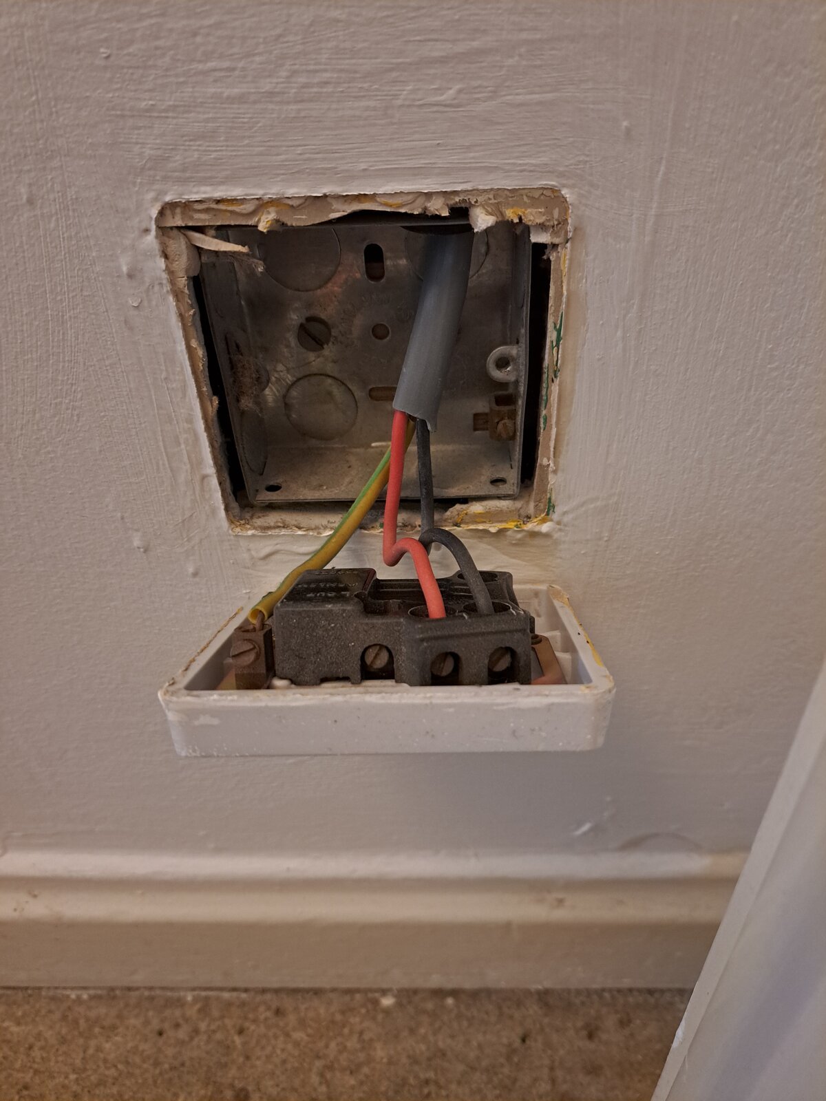

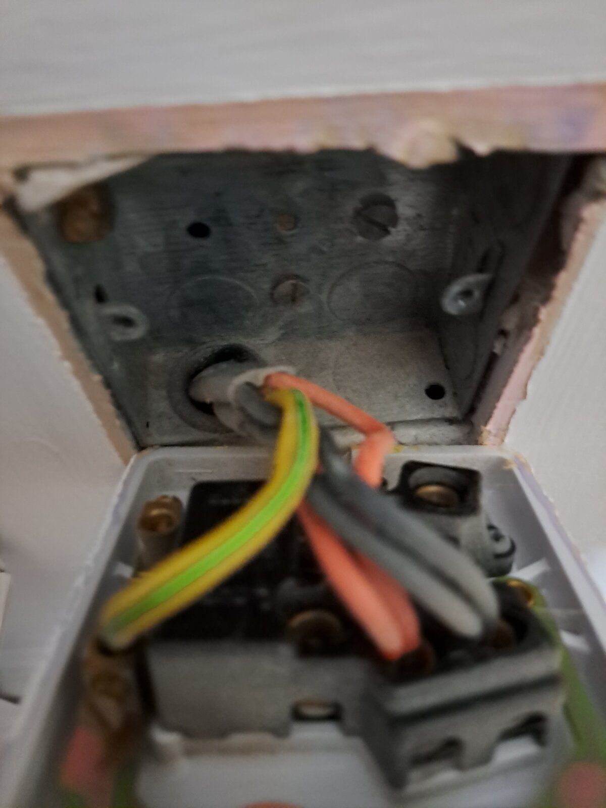

LOL lads what a post, interesting stuff :) well I have all off and cant see any difference...so are they isolation fuses so something blows in one room but doesnt blow main fuse just the room where it blew? I will monitor and post back if anything changes, cheers for all your great inputs...
Already requested above…
Carefully undo the plate screws and have a look at the connections behind. Photo them if you can.
We need to know if there are any wires connected to the load (output) side of the FCU.
Ok, will do and post back cheers
Hey chaps,
One got only single main feed by looks and 2 others I checked in bedrooms both have 2 feeds. Not a scooby what the bedrooms are feeding or if its just a isolation fuse box?
Aha. Thats tells a lot. there is nothing connected to those two. There are cables connected to the feed IN terminals, but nothing on the output side. Its possible that you could change the FCUs for sockets, but need to do some checking first.
Your next task is to check if there is voltage on the L&N feed wires (do you have any test gear, a multimeter will be ok.)
If there is voltage there then you need to find out what size fuse or MCB protects the circuit (or circuity).
