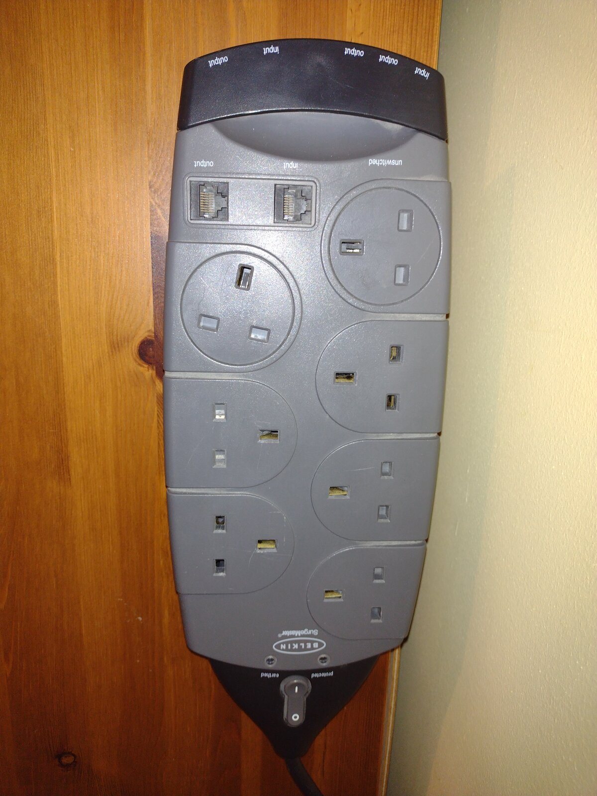

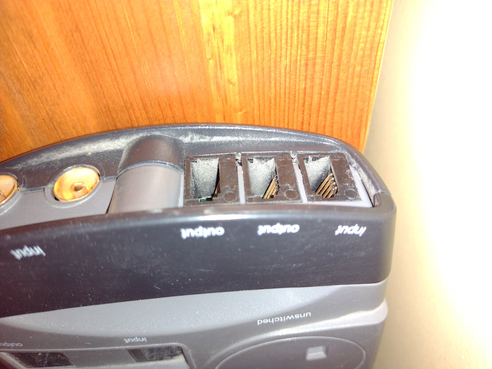

What are these sockets on extension cable?

Surge protection for phone lines/aerials
They are for phone lines, not that anyone has them these days lol
don't think so. Phone plugs have the thumblatch on the side. I think those are RJ45 or similar connectors.

oh, you mean the ones on the end? photo not clear but yes, probably

Yeah, those ports are RJ45. I can only assume they are to protect a broadband connection / network connection from potential surges. Input would be broadband / network feed in and out would be going to a router, switch or PC for example.
And phone line on the top grey side. I wouldn't be using anything that old though for a adsl internet connection though.
As mentioned, the ones on the black end side are for a LAN connection.
OH AND HAVING THE SAFETY SHUTTERS MISSING ON 2 OF THE SOCKETS. CUT THE LEAD OFF, SMASH IT WITH A BRICK AND BIN IT.
I suspect said shutters are just jammed and if it's possible to dismantle the thing (some extension leads can be, some can't) they could be cleaned and un-jammed.
might possibly be due to dust or grit in the moving parts? if you can be bothered you could open it up and inspect or clean.
but I don't know if it's worth the trouble. AFAIK these protectors were a bit of a gimmick, I don't know anybody who's ever benefitted from having one.
I see. Will replace it then, although where it is placed is pretty safe. It probably is quite old now, cannot remember when I bought it
