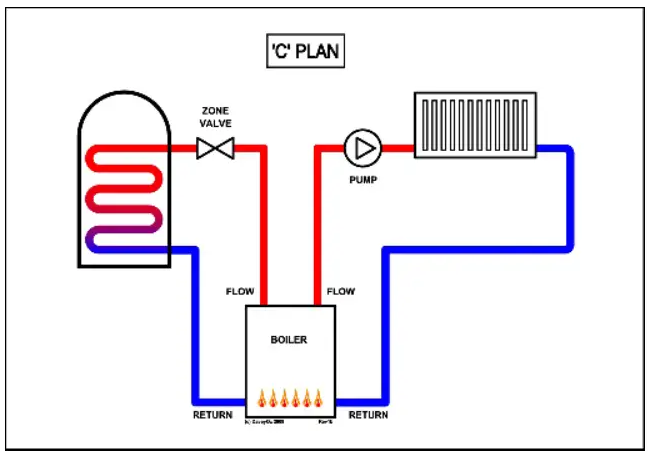

  2. Is my system with a two port valve called a Y plan or something else - I think its an S plan but with only one two port valve
Possibly it's a 'C Plan' generally as below, but with the radiators sitting atop a one pipe loop.
If it is a C Plan and, if it's been wired correctly the heating and hot water should work independently. Can't you tell when you use it?
The C Plan has two sets of pipework to the boiler one for the heating and one for the hot water, you only mention one set. If that's the case you may not be able to have the hot water on on it's own.
The only way to be sure is to follow the pipework and see where it all goes, there are all sorts of hybrid systems out there.

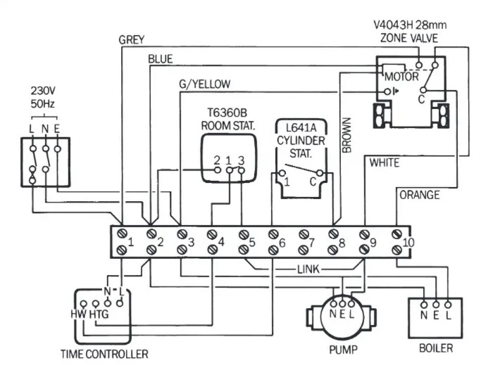

I think this was wired up wrongly if I am honest - It’s a drayton wall attached programmer
Is the 2 port motorised valve connected to the cylinder thermostat meant to link to the boiler - I cant see a wire from the cylinder to the boiler to be honest
Here's a wiring diagram of a C Plan. The changeover switch inside the motorised valve (top right) facilitates the isolation of the heating and hot water systems so that they can operate individually, so there won't be a wire from the cylinder thermostat to the boiler other than via the motorised valve.
