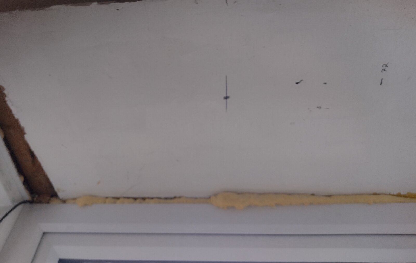

I have a upvc porch.
Between the porch and my main front door, there is 5-9mm ply on the ceiling. The ply is delaminating, looks bad and needs replacing.
What building material/ item should I use to replace the ply?

Is it a porch exposed to the elements or a mini extension, covered from all sides and dry?
Its a mini extension i.e. covered on all sides, dry and not exposed to the elements..

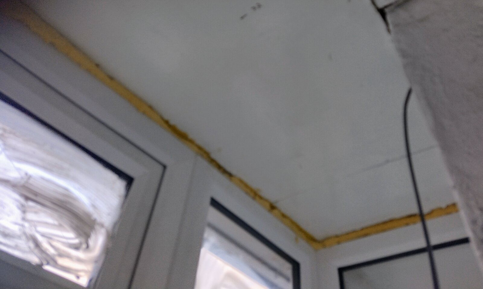

I assume you're talking about the edge with all the expanding foam blurting out; if you're meaning the entire ceiling section (can't see well in that blurry ass image but it looks ok?) then a sheet material well cut to fit. If there isn't any insulation above, consider PIR backed plasterboard, or remove the existing ceiling and fill above it (you don't have a lot of room in the frame height)

Now I get you.
The whole thing needs tidying up
The ceiling section is made out of thin ply and it has delaminated in places. It has been nailed timbers above
I will peel back the ply and run some cable and place mineral wool insulation (approx 170mm), then overboard the ply with either plasterboard or PVC soffit board
The edges with the expandable foam will be cut back.
I planned to just silicone some Flat PVC trim to the edge but I like your idea of using bath seal
Yes the picture was terrible, so I added a less blurry one.
