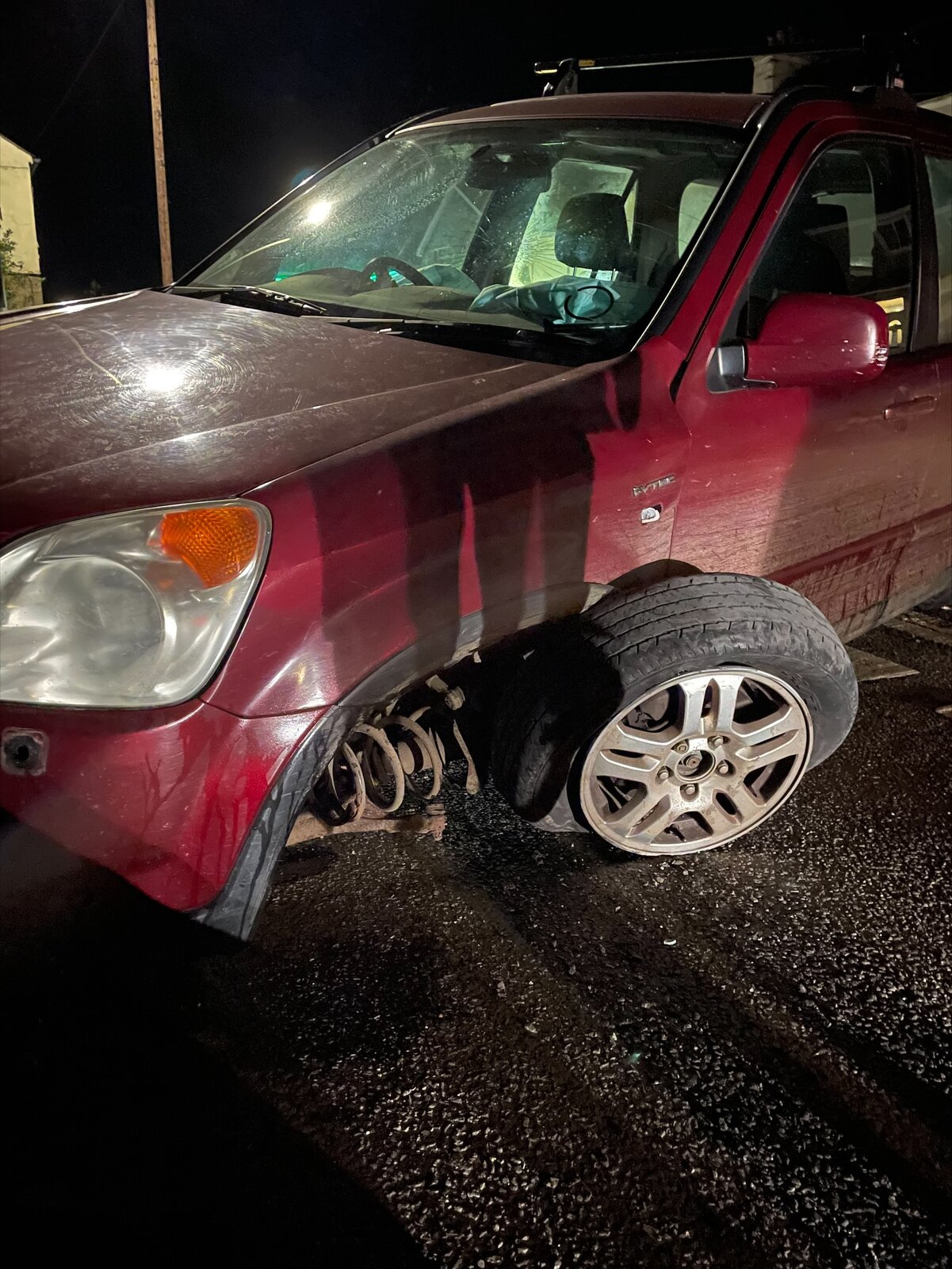

What caused an accident. Broken half-shaft?
Probably is the driveshaft, the mk7 accord is known to snap driveshafts I've changed 2 or 3 in the past, normally you just lose drive to the one wheel, wouldn't be a great surprise if another Honda model suffered aswell.
I'm OK now but police took me to Derriford Hospital because I had chest pain. I think they thought I had had a heart attack but it was just the airbag impact in my chest. Had blood tests, ecg, and chest x-ray and all fine. Blood pressure was sky high but that was to be expected. In total spent 11 hours in A&E.
there was a huge BANG, and the next instant I was on 2 wheels

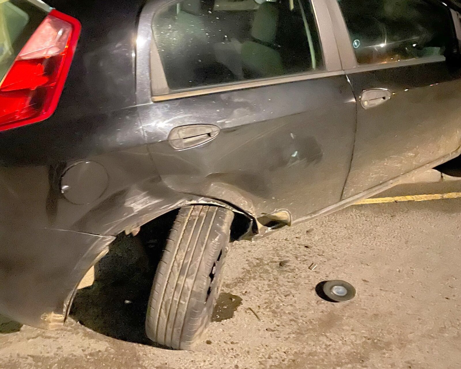

I don't think it was the propshaft. There was definately wheel to wheel impact (my NSF to the other OSR). The surprising part is that the corresponding wings were not damaged. I think something happened on my NSF suspension/drive which caused my wheel to move out away from the car. Can't really explain it as I'm not a mechanic. After the accident his wheel was sticking out possibly 6 inches from the arch, and I guess if it had already been like that my front wheel could have impacted causing the near flip. Having said that I had plenty of room to pass so I really don't see why I would have been that close. I think it more likely to be something mechanical on my car
There was no warning of any kind, no bearing or other noise. The accident was instant, I was driving completely normally, then an instant later one hell of a bang and I'm on 2 wheels.

Looking at the crazy angle of that strut I’d still think it was the bottom joint that gave way.....something let go at the bottom of the suspension wishbone.
