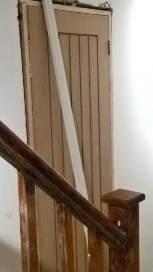

Hi,
I have had my doors replaced (as seen in pic) and plan to give them a coating of osmo oil. I had a staircase which was painted white. I spent time stripping this back to the bare timber and it now looks as per picture. The stripping has involved a heatgun which means that the wood is slightly burnt in places.
Now, is there anyway of giving this any type of wood finish that will look reasonable or do I need to prime and paint white again?
Thanks in advance.
To be honest it looks like the stairs could still do with a lot more preparation . It could just be the photo but it looks as if they are covered with (what looks like badly applied) wood stain of some kind. It really needs a good sanding down for starters.
However , from the photo it looks like the door is an oak or oak veneer type and it's most likely the stairs are going to be softwood. You can apply an oak coloured stain but it won't make softwood look like oak , the grain is just wrong for it to be anything like a match.
It thus comes down to how much money you wish to spend. Oak components are available but aren't going to be cheap , or at least in comparison to softwood, and you may have to get in a joiner to fit them. You could just replace the handrail in oak and paint the rest which seems to be in vogue at the moment.
Graining is another possibility and a good grainer can make anything look like whatever species you require. Again not cheap and it could be vulnerable to damage or wear.

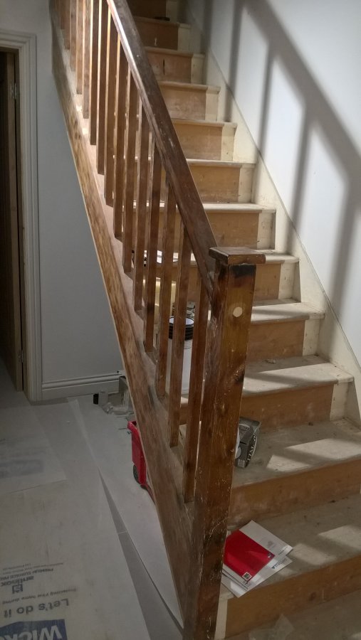

Thanks @ladylola.
Here's a better pic of the stairs. A significant amount of sanding has already been done. Is it possible that this cant be removed any further?
More sanding. Get some 60 grit on there. You will wish you never started, but persevere. In a year's time you WILL have forgotton how long it took you, and only see how good it looks.
Better to concentrate on the handrail and get that looking good enough to stain and have everything else white, as ladylola says its quite in at the moment. Did one yesterday which looks great.

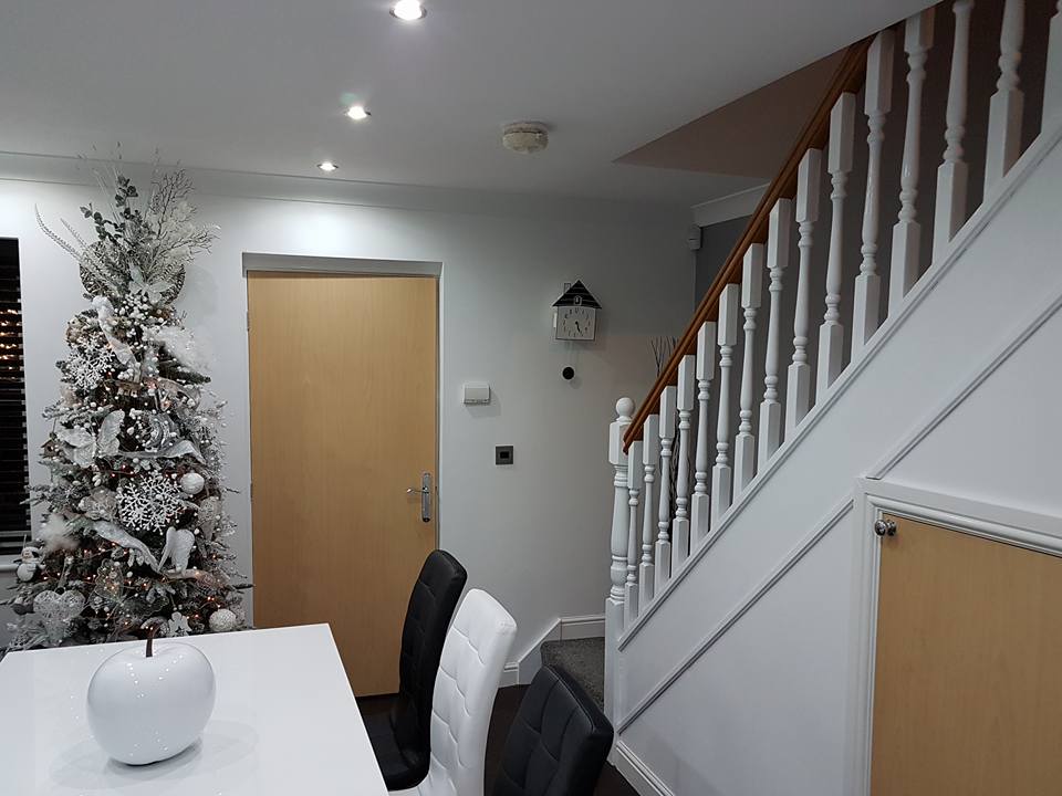

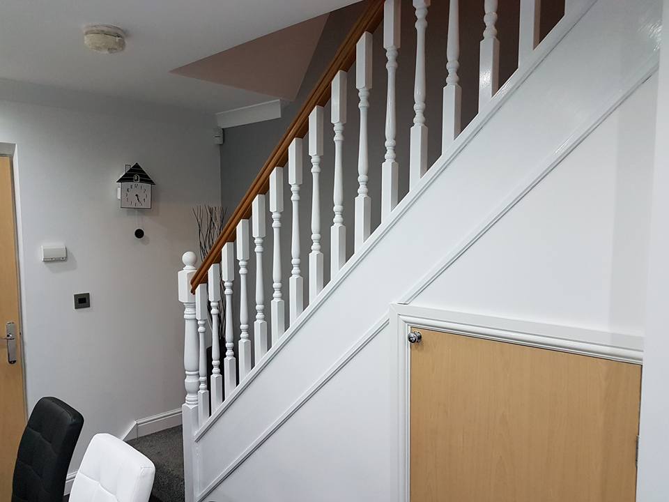

This one I did yesterday. Was all stained at first. Prepped it all, one coat of Zinsser Cover stain, then two coats of Armstead Water based gloss.
Thanks for putting that picture up Robbie , just what I had in my mind , very contemporary at the moment. I notice in the picture that the wall behind is grey which also seems to be very much in vogue too. Did you do that as well? I've decorated a couple of jobs in grey and have recently done my own stairs and hall in grey partly at the insistence of my daughter who is at an age when she wants to bring friends home but doesn't want the house to appear old fashioned (and embarrassing !) but more up to date.
Yes I did do the walls. The wall is actually a vinyl paper. Grey emulsion seem to be the trend this year, done so many kitchens and living rooms in grey. I did the stairs yesterday, all in the one day. The benefit of the Zinsser drying in an hour and the water based gloss in a similar time allows the further coats in the same day.
