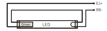

Kitchen had a 60W 5 foot thick tube seems not made any more so got a 24W LED replacement. It shows how to rewire however a replacement started is included with the tube, but does not really show where it should go or if even needed.
The tube works fine without the starter so what is it for? I hope it's just a link, but at £17.09 for a tube don't want to damage it. Actually found ballast (now completely disconnected) was 65W so no real wonder thin 58W tubes only lasted for 4 months. Tried everywhere for fat tube just could not get one. Crossing fingers an hope replacement lasts longer.

I would guess the included starter is a blank (no connection between the pins) as if you leave the old starter installed without disconnecting the wires internally it will short out L/N when you power on the fitting.
A starter doesn't short out L and N as such, there is a magnetic ballast in there so it basically causes a circuit from L, through the ballast, through the heaters (on each end of a standard tube) and then to N. The breaking of the starter contact causes the magnetism in the ballast to collapse and a high voltage spike to start a tube.

LUCEC Replacement Starter for LED Tube LSTR www.luceco.uk British BG General. It looks to have one single resistor inside.
Now I have looked on internet it would seem you can use the tube without removing ballast. But on the packet it showed
so it would seem pins in the blank end are just connected together. I connected both lives to the driver end and nothing to the other end and it seems to be working fine. It says:-

  • Tubes are powered from one end (fitting rewiring may be required)
I have looked for a voltage range it says 220 ~ 230 Vac but wonder if the driver can run 150 ~ 230 volt so is able to get enough power even when fed through the ballast? However can't find any details.

If wired as per the first diagram you posted, it would obviously have to be something fairly close to a short circuit (at operating voltage/frequency), and I see no reason why it couldn't literally be a piece of wire! A resistor of 22kΩ (let alone >200 kΩ) between the starter terminals (at operating voltage/frequency) obviously would not work, since one would then be limited to a maximum of about 10mA in the circuit (aka 2.3 W, nearly all of which would be dissipated as heat in the resistor)!
So, as you say, goodness knows what is inside it! I suppose it could theoretically be a capacitor (although I'm not sure how one would reconcile that with your 'diode test' results), but it would have to be a fairly high value one - and, as above, I don't really see why it couldn't just be a piece of wire (unless they are trying to 'cancel' some of the reactance of the ballast with a capacitor). Sounds like a case for some 'destructive investigation' :-)
