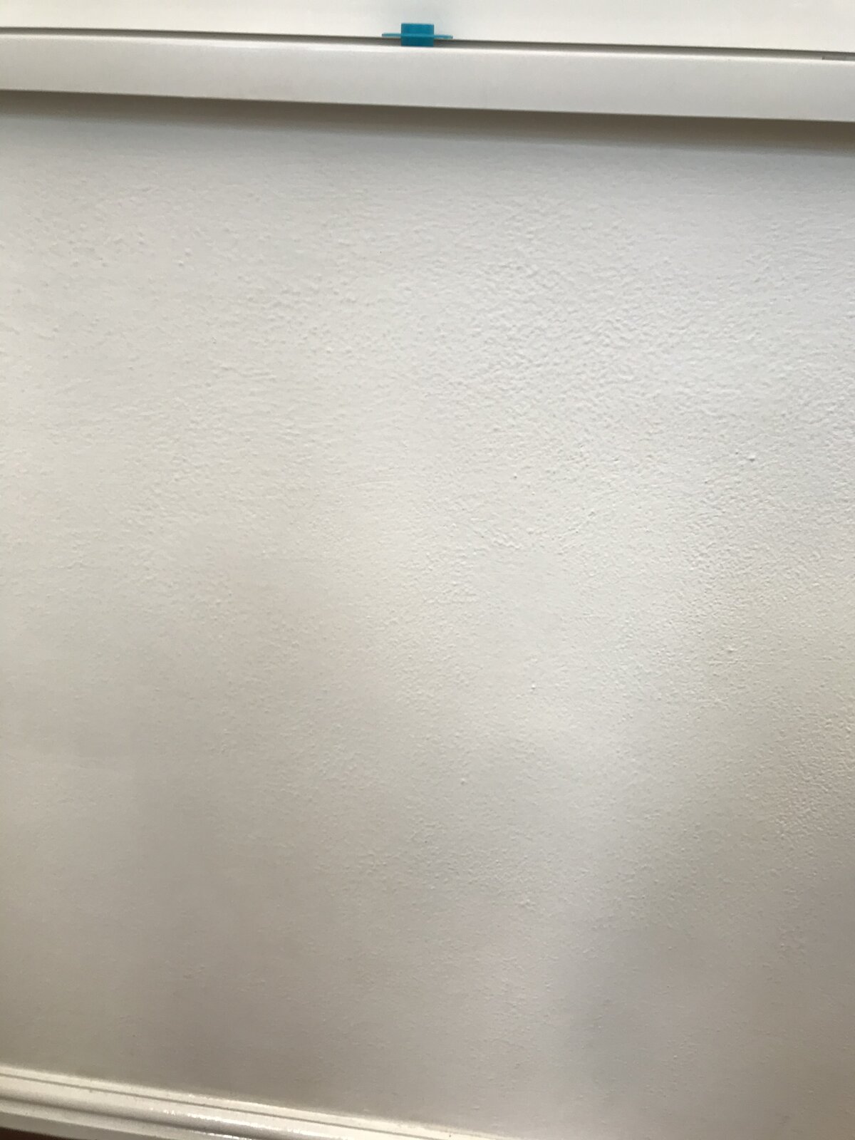

I want to hang a whiteboard and a small shelf on this wall and I’m not sure what fixings I need. The wall used to be the outside wall before the conservatory was built so I think it’s brick underneath but I’m not sure what this material is covering it. I’m a complete novice at DIY so sorry if it’s a daft question!
Do I need rawl plugs especially designed for brick?

All rawlplugs are designed for brick, stone or whatever, specialist fixings are available for hollow walls such as plasterboard or whatever.
Before you start though you'll need a hammer drill plus 6mm masonry bits......do you have those?
If so, some 6mm plastic plugs (Fischer from Screwfix are great) and some 4mm diameter screws.
John :)
Thanks for replying, yes I have the drill and bits already. Just looking at ToolStation and found some Fischer raw plugs, what length do you think I’ll need the screws to be?
Thats for you to find out, by drilling a hole. There could be an inch of soft plaster before you hit the brick. (How old is the house?)
A red plug is 1¼ inch long and needs to be in the brick, so, if my example above were correct...
1 inch of plaster + 1.25 inch plug into the brick + quarter inch for the whiteboard thickness = 2.5 inch screws.
