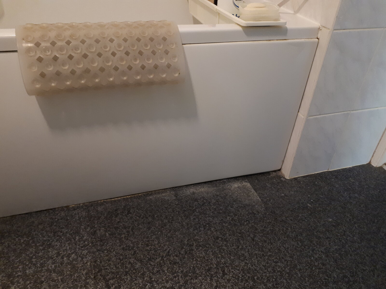

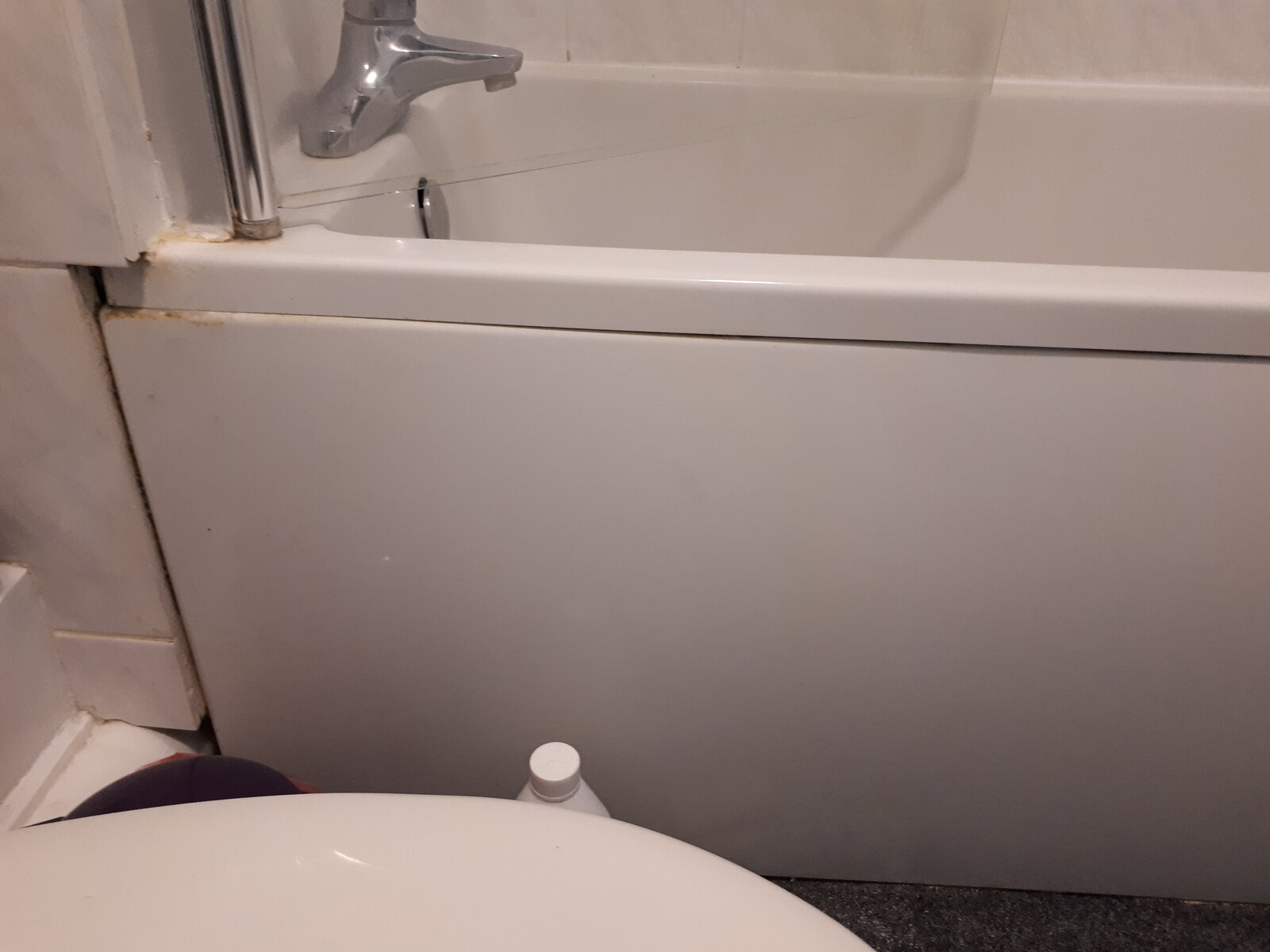

Ok there is a possibility to access the back of the bath tub. I need your advice below:
Here is the left part of the bath tub
kynJR9l
Here is the right side of the bath tub
XF8amYZ
How do I open the panel? If it is open, how do I close it?
