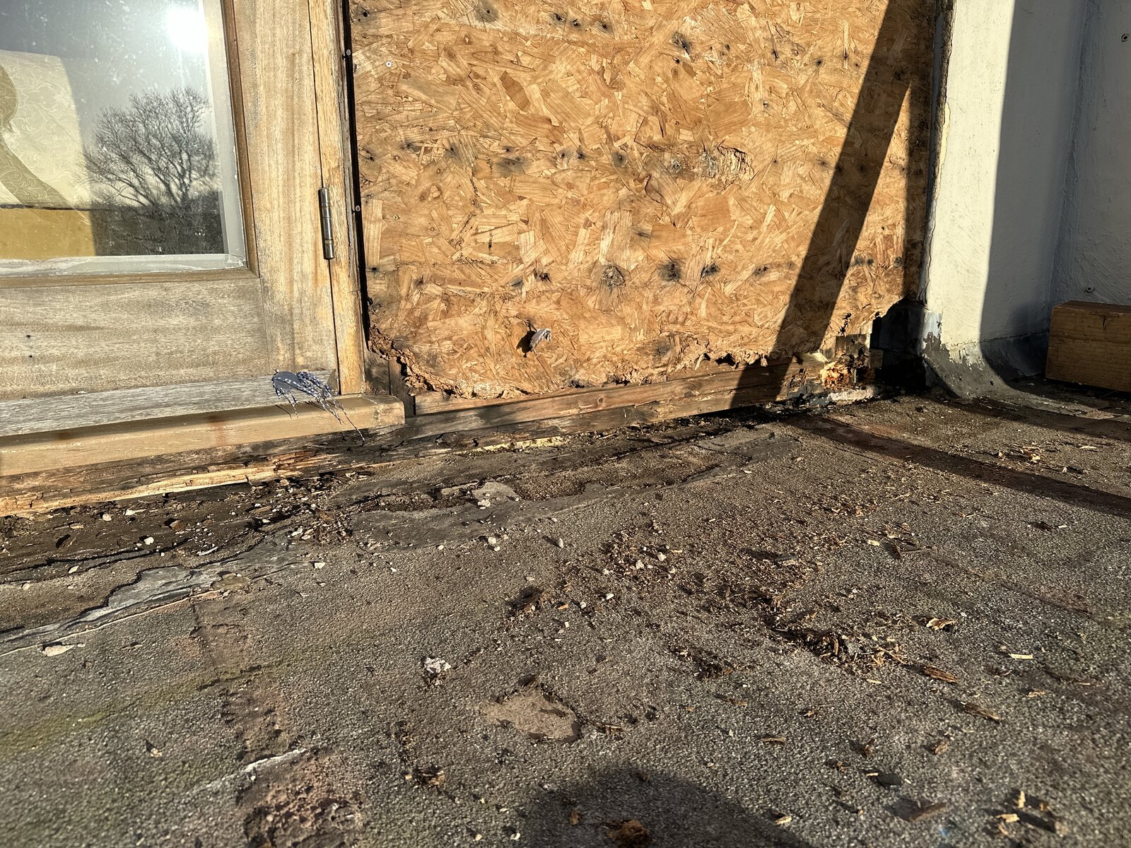

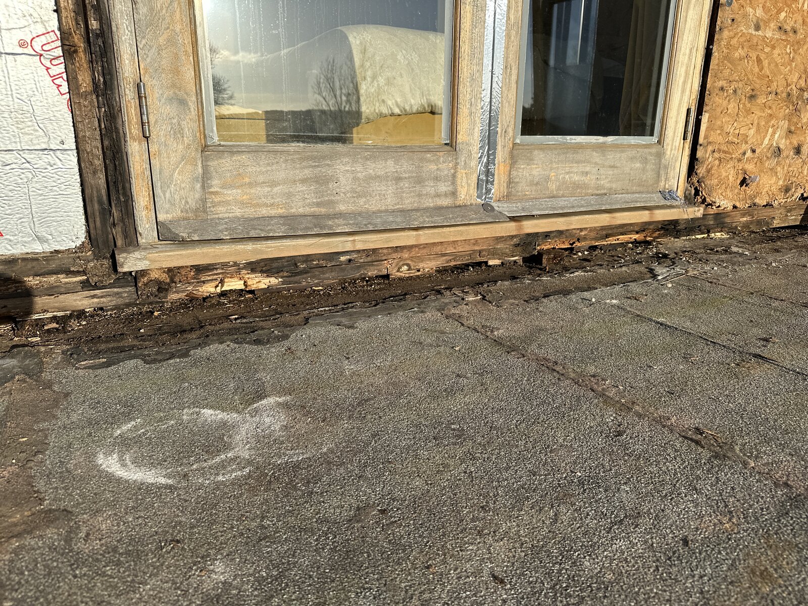

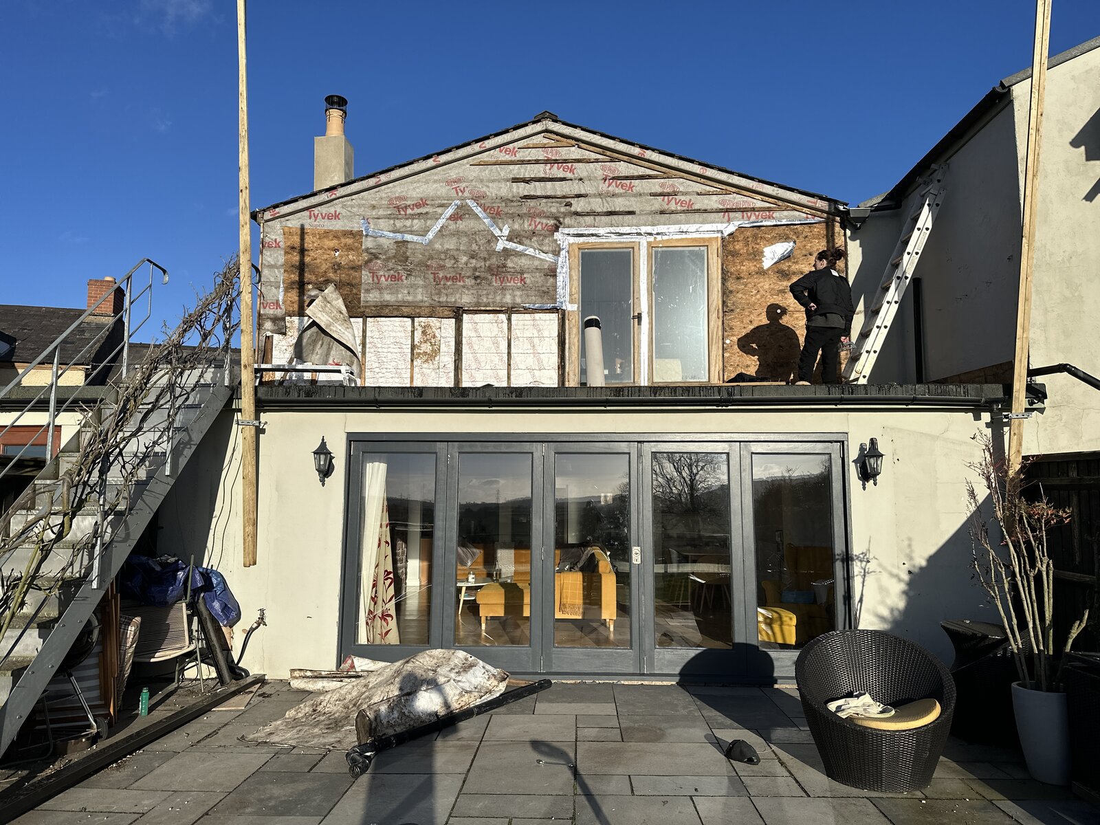

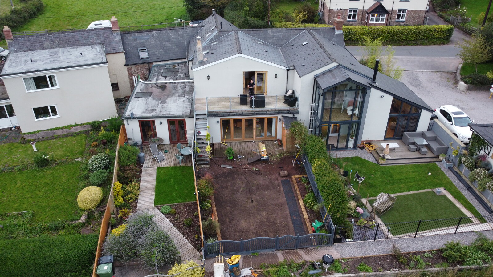

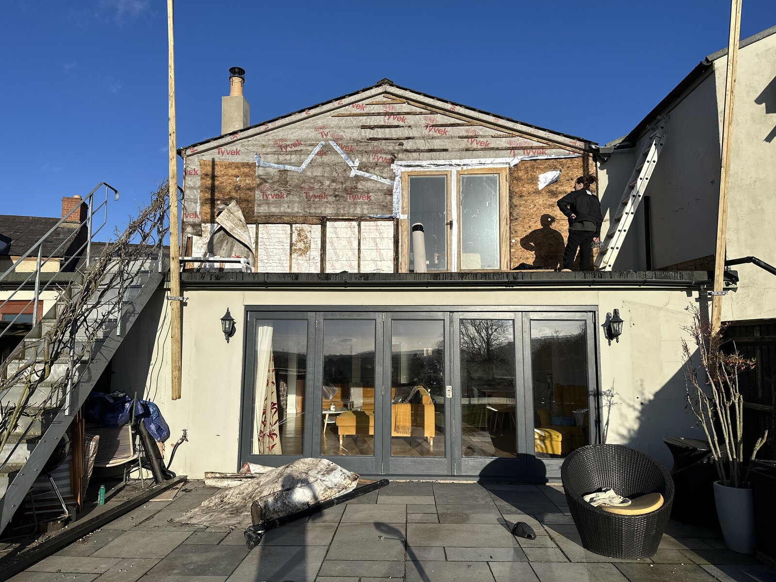

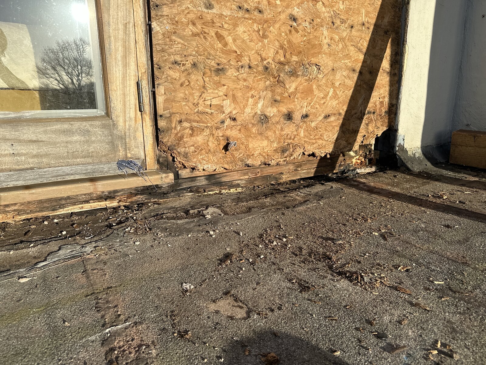

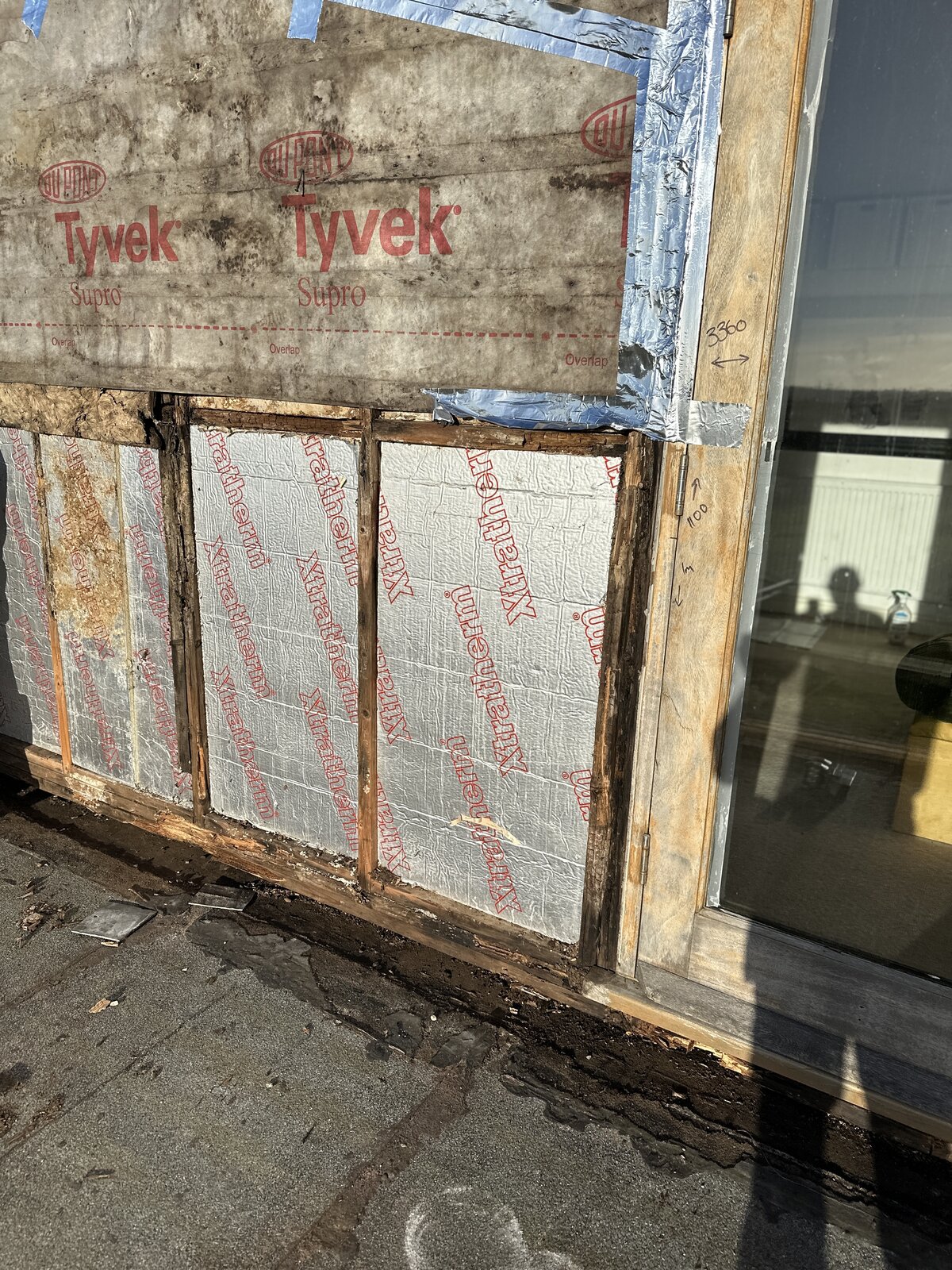

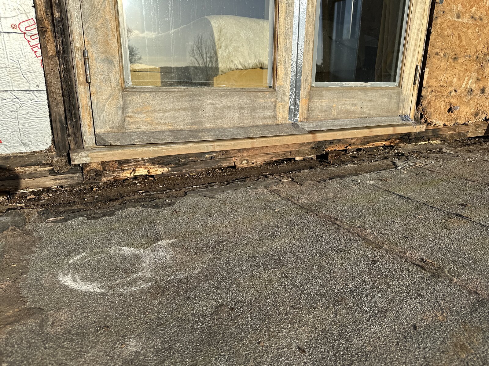

We have an exterior wall, that (now it has degraded sufficiently) I can see the construction.

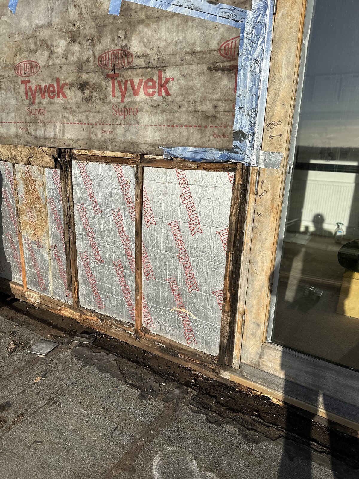

It’s a “lightweight” room built on a flat roof (torch felt). The main wall is exposed to heavy weather. The wall is made up of 2 stacked 5x2s, sat on small blocks of wood and tile in order to be level, then a timber wall, with a French door inserted. The wall is insulated (half with celotex, half with rock-wool), and then clad with OSB. The OSB is covered with tyvek, then battened horizontally, then this was meshed (galvanised) and nailed (galvanised I guess). Then finally rendered.the render is obviously very different thicknesses and the whole mesh has rotted as have the fixings. Meaning the render is “floating”. The OSB boards are stained at best, dust at worst. As is the first 1” of the timber r]frame (from outside-in). The stacked tx2’s resemble a sponges most of there lengths.
Where would you a) go to claim for this based on the zero support we’ve had from the “professionals” we used to ensure we did not buy a dog
I am hoping to rebuild myself., using a much larger bi-fold to minimise the amount of plastering, cladding, wall construction needed as I think it will be cheaper, more aesthetically pleasing as it will match the ground floor, and potentially add value that we are losing hand over fist atm.
Should the surveyor have picked up on this?
