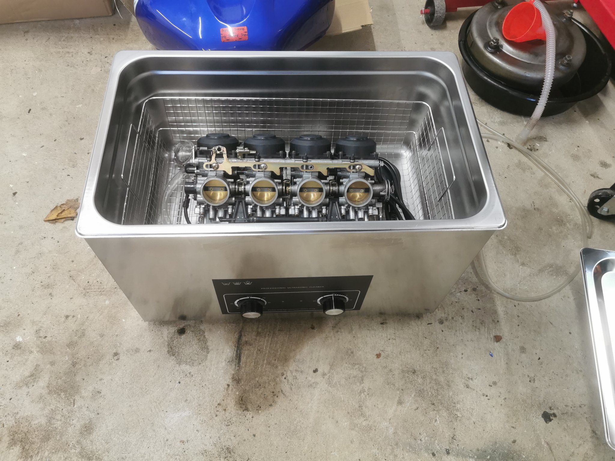

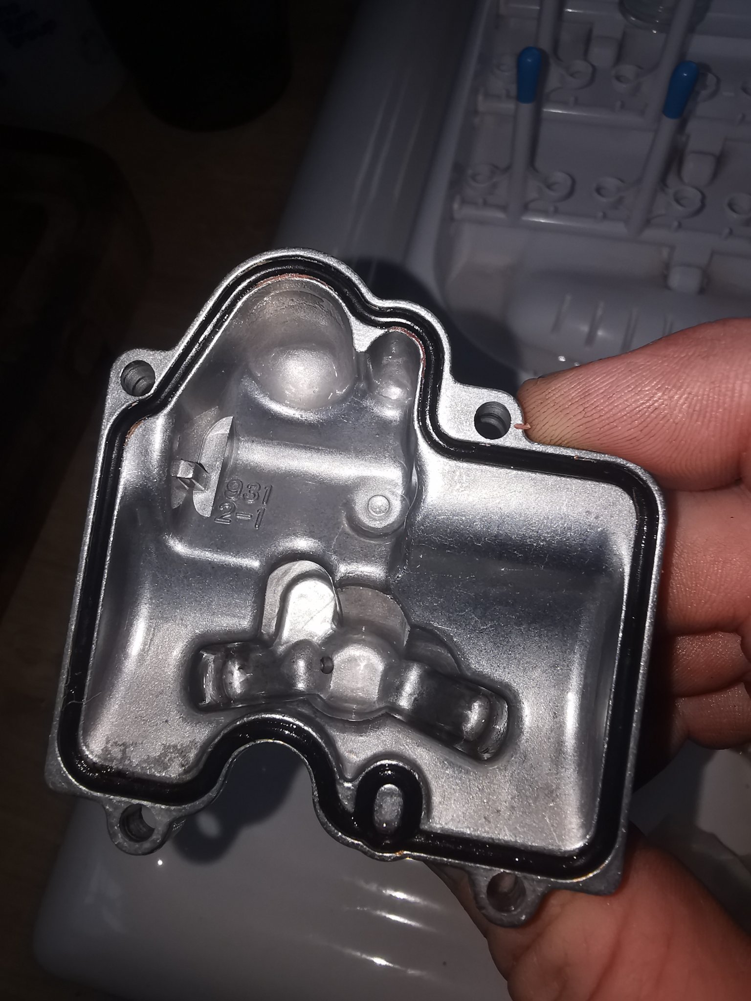

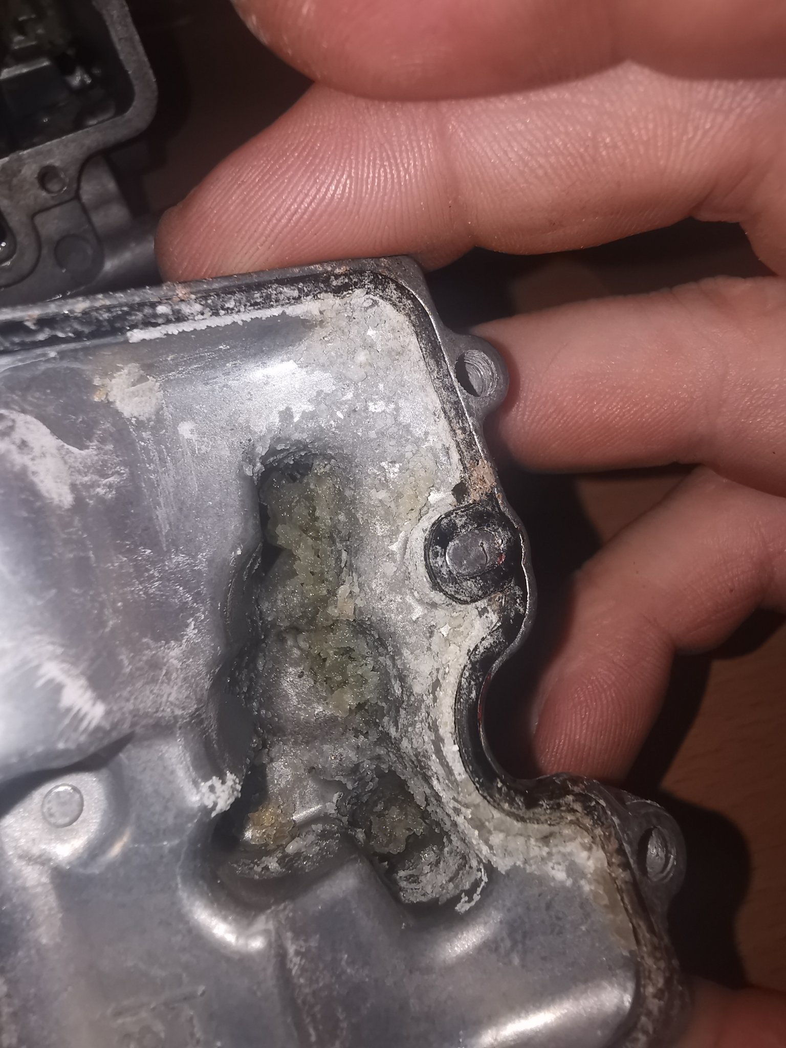

They are good, aren’t they? I have a smaller one that I sometimes dunk my watch bracelets and Mrs Motties jewellery in. The muck that collects the bottom of the tank when it’s finished! It does get things up sparkly clean though.So following on from the what have you bought thread, I bought a yamaha r6 that required the carbs cleaning so I bought an ultrasonic cleaner.
The cleaner was a bit bigger than I expected but the carbs fit in nicely which is the point.
I stripped the carbs at work ready for cleaning, they definitely needed doing,
They were then given 30 minutes at 80 degrees in the cleaner and I'm impressed with how they've come out,
Hopefully get them built back up and on the bike for the weekend.
