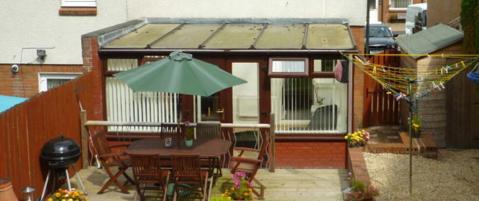

If I was to make an (uneducated) guess I would say this conservatory is a cheaper version so might well be at the end of its lifespan, I have included a picture of it below.
Anybody have a rough idea what a ballpark figure would to replace a conservatory on a 3 bed semi. Again obviously I know this could vary by thousands of pounds I'm just wondering as I have no idea whether this would be 2 grand or 20 grand. I'm assuming that since all the structural/electrical/heating work has been done that the cost will be substantially cheaper than installing a conservatory from scratch?

Very much ball park I would say to replace the frames and roof, using the existing base would be about 3.5 to 4k all in
Maybe gazman, dh frames or god on here could price up more accurately than me as I don't fit anymore, just do insurance assessments and repairs
I'd say anywhere between 3-5k, depending on what frames and roof you choose
If you opted for any of the self cleaning roofs, the parapet walls may have to be taken up as the pitch would have to be increased for the glass to function correctly
5k tops including the parapet walls work
