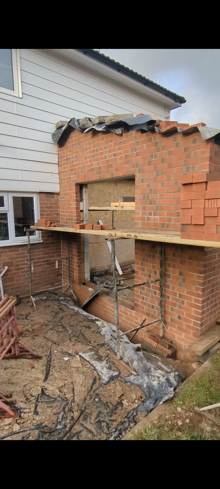

what is the pitch of my roof

Excuse me for asking what i think is obvious … maybe it’s different over here … why do you care what the slope is? As long as the builder is following the plans, what you should be concerned about is quality. As others have pointed out, it doesn't look good, maybe the mason had a liquid lunch when he started back to work.
what do you mean by out of kilter?
Freddy means the vertical lines of mortar between bricks line up nicely until you get to 3 courses above the window, then they go all over the place. They also lack pointing- but both these factors could be adequately explained by the top part of the wall being covered with a decorative render
When you say the bricks are 75mm, do you mean they're a 65mm brick with a 10mm bed, or are they actually 75mm bricks and the 10mm for beds has been omitted from the calcs? 12 courses of 85mm gets you more or less to the rise you need for the angle you want. Show us the plans the builder is building to
But the string it not the angle as the starting point is 2 bricks lower. So not sure the purpose of the string.
I'm guessing the angled string line wasn't there when the wall was being built?
I wouldn't put much stay by the angle of the string as pictured, as it could have slipped up or been moved out of the way at the lower end.
It doesn't have a single pitch, as it's a lumpy bumpy random shape.
Rather than cutting individual bricks to achieve a slope it's easier to just build out a wall in some higgledepiggledy way and then run a cutoff saw up it in a one-er afterwards to set the slope

I also saw some YouTube videos where the roof rafters are put up first before the triangle part of the brickwork is built up.
Most builders will build a part gable, then complete the finer angled bits when either a dummy rafter is pitched up or the complete roof. A decent bricky or builder would be aware that noggings may need to poke through the gable, if the roof is having say a barge overhang etc.

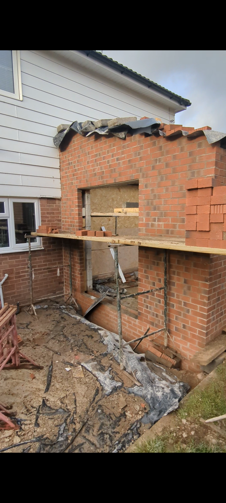

Are people not looking at the photo?
pitch-jpg.397297
There are bricks that are entirely beyond the string, and gaps of fresh air below it. It's crap.
No idea why the pointing's missing either, filling it in after will be vastly weaker than doing it right in the first place. It's basic brickwork stuff, there should be a bit too much mortar, which you then tool off. There may be the of tiny bit of a perp that needs gobbing up while pointing, but it all gets done at the same time. There are lengths of bed joint that aren't there. Most perp joints must be mostly empty. I'm an utterly amateur DIY brickie but I'd give up if my work looked like that.

Yes, and this is why i panicked that evening and came here.
but i've sent videos and photos to other builders and various people now - the message is clear. Brickwork is usually done after rafters have been put in at the required angle. these brickies got ahead of themselves and did this. the roofer side will now fit the wall plates, and start placing the rafters - any gaps you mention will be filled then as is normal for other builders to do. i'm not entirely sure if they than cut triangles or what. I just stress myself out needing to know every detail.
As for the pointing - maybe for these bricks he did it this way. a guy did this brickwork alone. whereas everything that was done before was done by a team of four and was done the other way you mentioned where it was overfilled and then a guy went around pointing it.
and yes, the string makes no sense. but we have moved passed that. the rise is 975mm, which gives 16 degrees. the rise should be 1040mm for 17 degrees, something they are still adamant will be achieved by the rafters. I'll wait and see.
Most roof tiles have a minimum pitch, below which they are not waterproof, may not interlock properly, etc.
He’s freaking out over 16* vs 17*. Both of those are less than 4:12 (18*) so over here that would require a double layer of underlayment for tiles.
If i had a customer like that on my job, i would refund his money and move on to the next one. But as others have pointed out, the mason is out of sequence, which leads to the question: who is managing the project? Why wasn’t the roof framing completed first, which would have set the slope and given the masons something to build to. And what professional project manager would allow the mortar to set on the mish-mash upper bricks? Looks like Ray Charles did that work.
I wonder who the Principal Designer is. Might be interesting when BC need the principal designer's sign-off before they'll issue a completion certificate....... We haven't had many threads yet on this topic, but I'm expecting we'll see a good few in the future...
