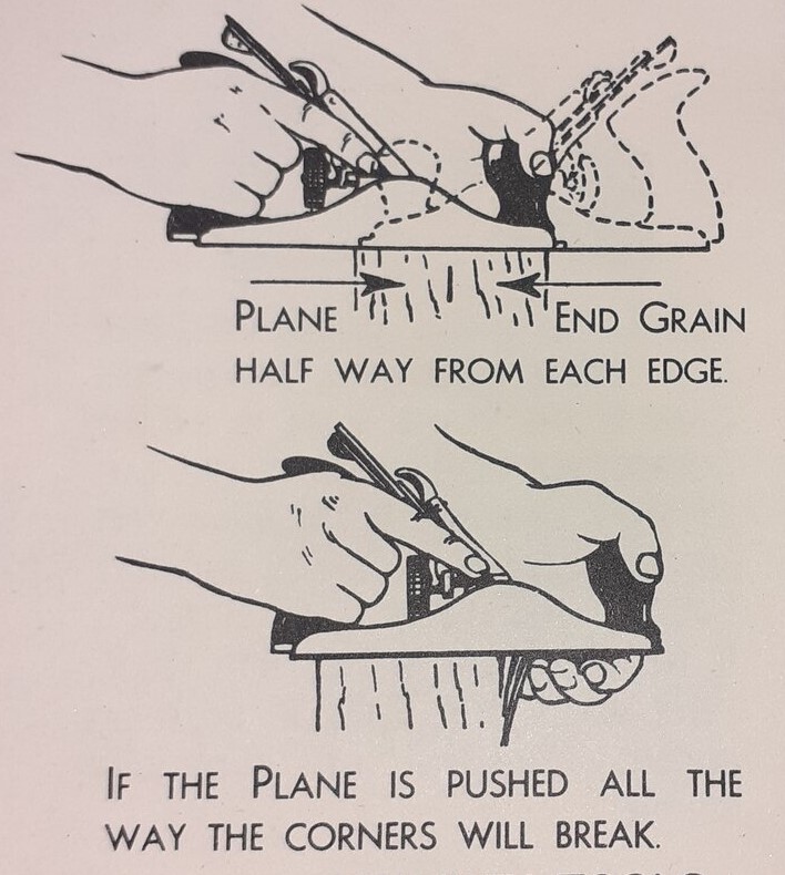

My tip of the day, is if you are power planing a door edge, stop before you get to the end, don't let the blade run past! :rolleyes:
As someone who hasn't used a plane for many years and never a power planer, can I ask why? What goes wrong?
It's to do with grain direction. On a traditional frame and panel wooden door if you are planing the long edges you can just work straight through as the stiles run the full length, no problem, but if you are planing the top or bottom edges you are planing across the grain when you plane the ends of the stiles but with the grain of the rails in the middle - unless you support the end grain of the stiles it will often break - or stop short and plane in the last bit from the other end

Oh yes that makes sense, same as sawing timber and 'breaking' the last bit if you're too rough. Thanks :)

When planing with a power plane there is a tendency to press down on the front, however lightly. So when the plane goes over an edge the front and blades go down and take massive chunks out of the surface. That's in addition to splintering! There are ways to avoid it, but its oh so easy to forget and do. :whistle:

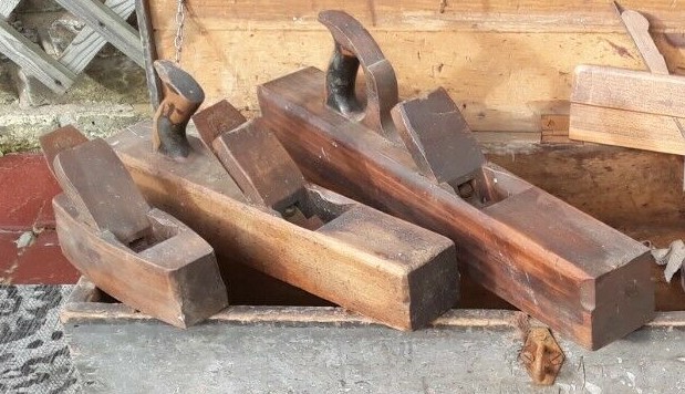

I agree. I'd just love to see how you'd get on with one of your namesakes, though - a "woody"
Another project to clean up and get working...
I did pick up one of those 18" monsters just after the first lockdown. Some bloke who got a bit carried away with his new DIY hobby in the lockdown, apparently he bought too many tools to fit in his new DIY shed!. I went for a bargain Record no 52 1/2 quick release vice, (which me and Mr Hammerite subsequently restored), and while I was there got this wooden beauty!
It was £3, in very good condition and had the intriguing name of the original chippie stamped into it.
Anyway, it might be me and my inherent lack of patience, but I find it a bit finicky compared with metal planes. Probably like the OP in his first post! But I'm determined to give it a go whenever I can.
Couple of tips - get out your Thor nylon head hammer rather than use a metal head hammer, after all even the newest "woody" will be 50 odd years old, probably a lot older. Also, they only adjust one way (i.e. thicker) so position the blade, hand tight the wedge and try a stroke. If it's too shallow rap the blade lightly with the hammer and retighten the wedge (hand tight) and try again. Once she's cutting well tighten the wedge with a tap from the hammer - don't go mad, it isn't necessary to hammer it home so hard that it cracks the cheeks. The only other thing is that being wooden, "woodies" move, so you may need to pop it in your #52-1/2 and flatten the bottom (plane front to rear) to take any warp or wind out of it. Once they are working they are nice to use and can take a far heavier shaving than you'll get with a metal plane
