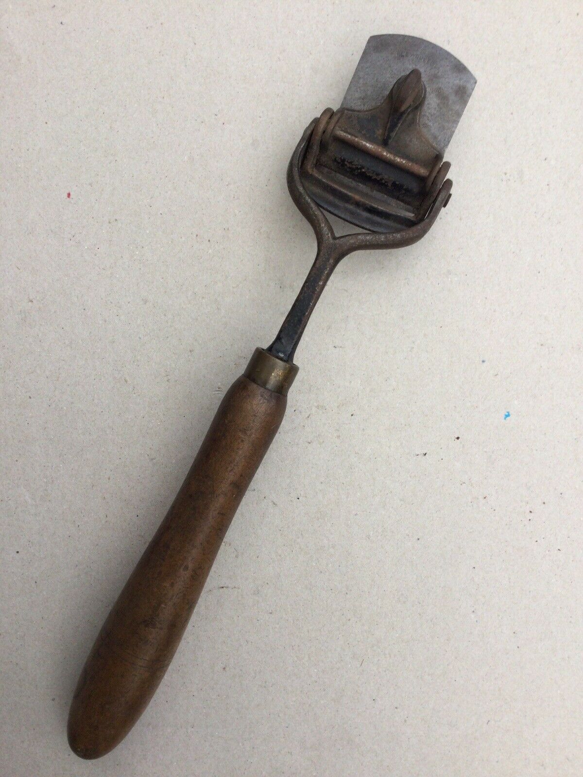

How about an old Stanley Box Scaper?
Hmmm. Guess you don't know about those - the sole of those is actually slightly curved side to side, as should be the blade. They are not really a sctraper, more a sort of pull spoke shave and were actually designed to make a scalloped cut in wooden crates. This was so that you could remove the painted or branded names off the sides of wooden crates so that you could re-use them. So ideal for cleaning up furniture unless you like that rustic, hand-hewed look. With the big move from wooden crates to cardboard boxes in the 50s and 60s they became obsolete.

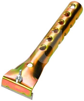

A better bet might be something like a Linbide floor scraper (which I think I mentioned above)

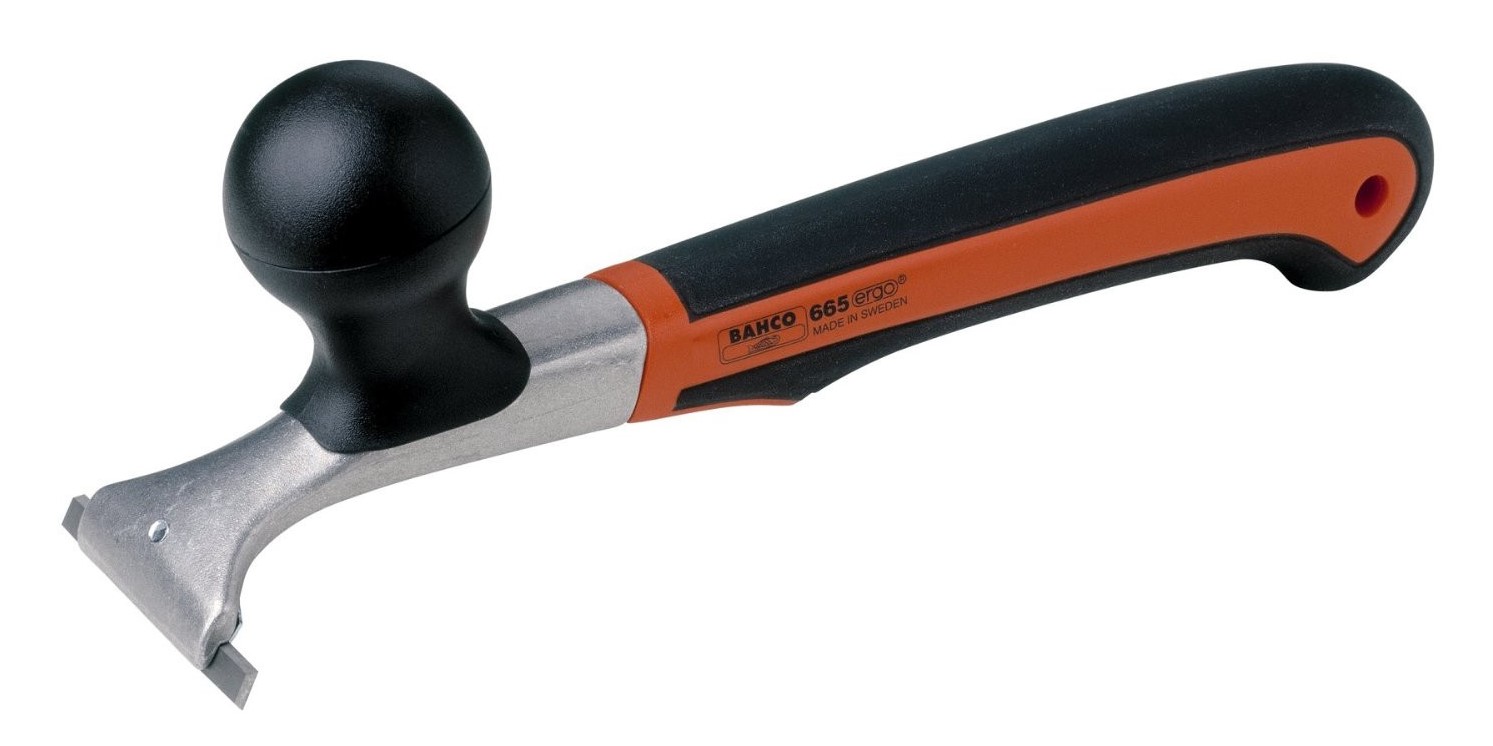

These are available through decorating centres, although SFX and TS probably do cheap Chinese knock-off copies. The alternative ios the natty Sandvik 665 carbide scraper:
which isn't cheap (and again there are cheaper copies) but allows you to exert a lot of pressure. These two designs have replaceable blades available.

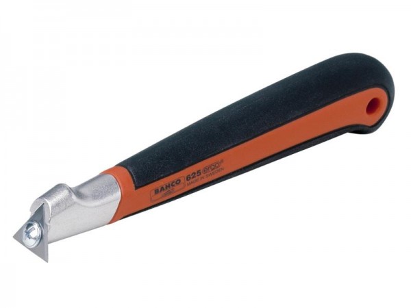

For tight corners Sandvik also do the 625 Pocket Edge Scraper:
which again takes replaceable carbide tips, and again isn't cheap, but has the advantage of having with a variety of shaped carbide tips (triangular, drop, pear and round) available for it which are really good for cleaning up moudings without the need for a heat gun

Interesting tools @JobAndKnock - so just how heavy duty are we talking? I wouldn't actually say the tools seem that expensive, but the replacement blades are half the price of the tool which does seem pricey. Any idea how much use you can get out of a blade?

Quite a lot - the replaceable tips are solid carbide, so they are durable. I've had a Linbide for a few years and I'm still only on my 2nd blade. The little Sandvik I havevis still on the original blade (there are 3 edges - now on the last one). But I am gendrally only using them when I need to clean up an old door or old mouldings prior to repairs
