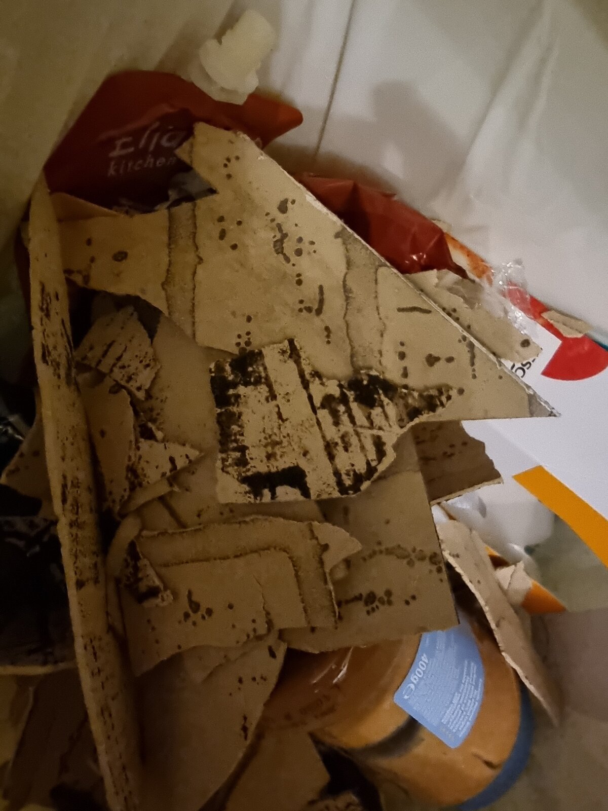

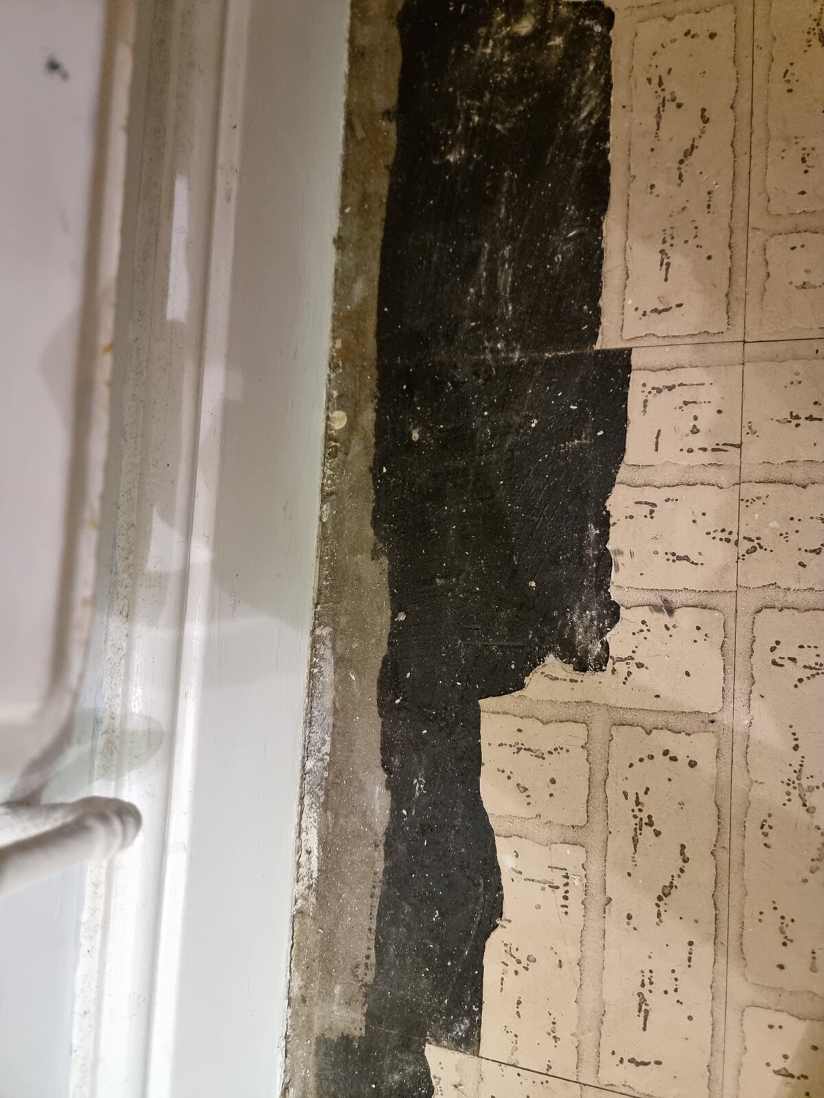

Just about to get a kitchen fitted, told the fitter its vinyl on the floor, after lifting vinyl up ive found another layer of flooring. At first thought it was porcelain tiles but appears to be some kind of plastic copy.
What are these? And what is all that black stuff underneath?
Is my kitchen floor now going to need screeding before they fit the units??
Black stuff feels relatively smooth but theres a tiny hole every now and then from removing the brittle plastic tiles on top so wont be the smoothest surface?
If it doesent need screeding for the units will it need screeding for the click type luxury vinyl tiles with underlay??

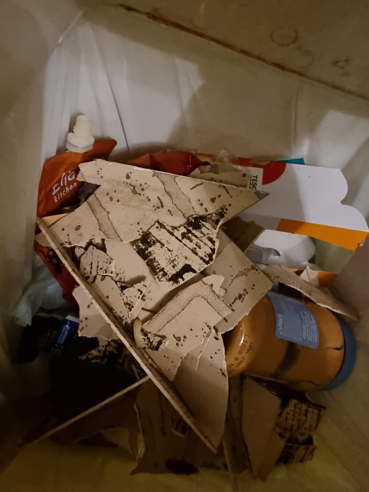

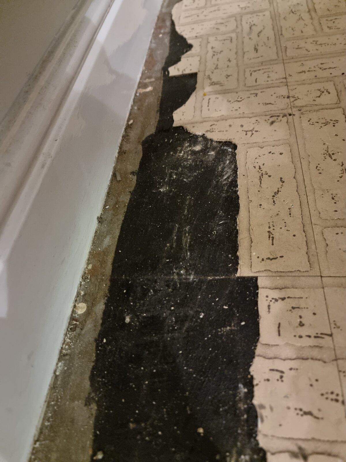

Just reading up and online it mentions about black mastic, which apparently contained asbestos so now im worried as hell!!
I dont know when this floor was laid BUT the house itself was built in 1995.
If it makes any difference it looks like the black stuff was put on the floor first then tiles laid on top of it rather than tiles having it on the back and stuck down.
You can see front of tile and then back of tile has black stuff on it, looks like the tiles were laid on top of the black stuff as stated above.
Tiles are about 2mm thick or so.

I wasent planning on removing it. Just chipping the tiles off it, they come up very easily to be honest. Then either lay a new floating floor on top if its smooth enough or screed on top if required?
House was 95 but not sure if its the original floor or pur in after.
Tiles dont look oily and no discolouration of tile either.

That stuff is much thicker and will cover the entire floor. What I see in your photo is the black stuff does not spread out to the skirting board, because I think I am seeing bare concrete there. As I said - it is the tile adhesive.
Is bitumen just as thick as black mastic then?
It looks 2mm thick or so at most i would say, is that really an indication its just adhesive? Its a full layer on the whole floor not just on bits of the back of the tiles.
Why would the black mastic be spread all the way to the edge of the skirting?
Yes - thin is tile adhesive and can be/needs to be removed from the concrete. Thick - 10mm or so is not adhesive, it is the original floor and should not be disturbed.

Take the tiles up then put a 3mm smoothing compound over the top like ardex NA , Tilemaster pro flow , fball 1200 pro
Will that set okay over the adhesive? Or do you mean just the bit without adhesive?
