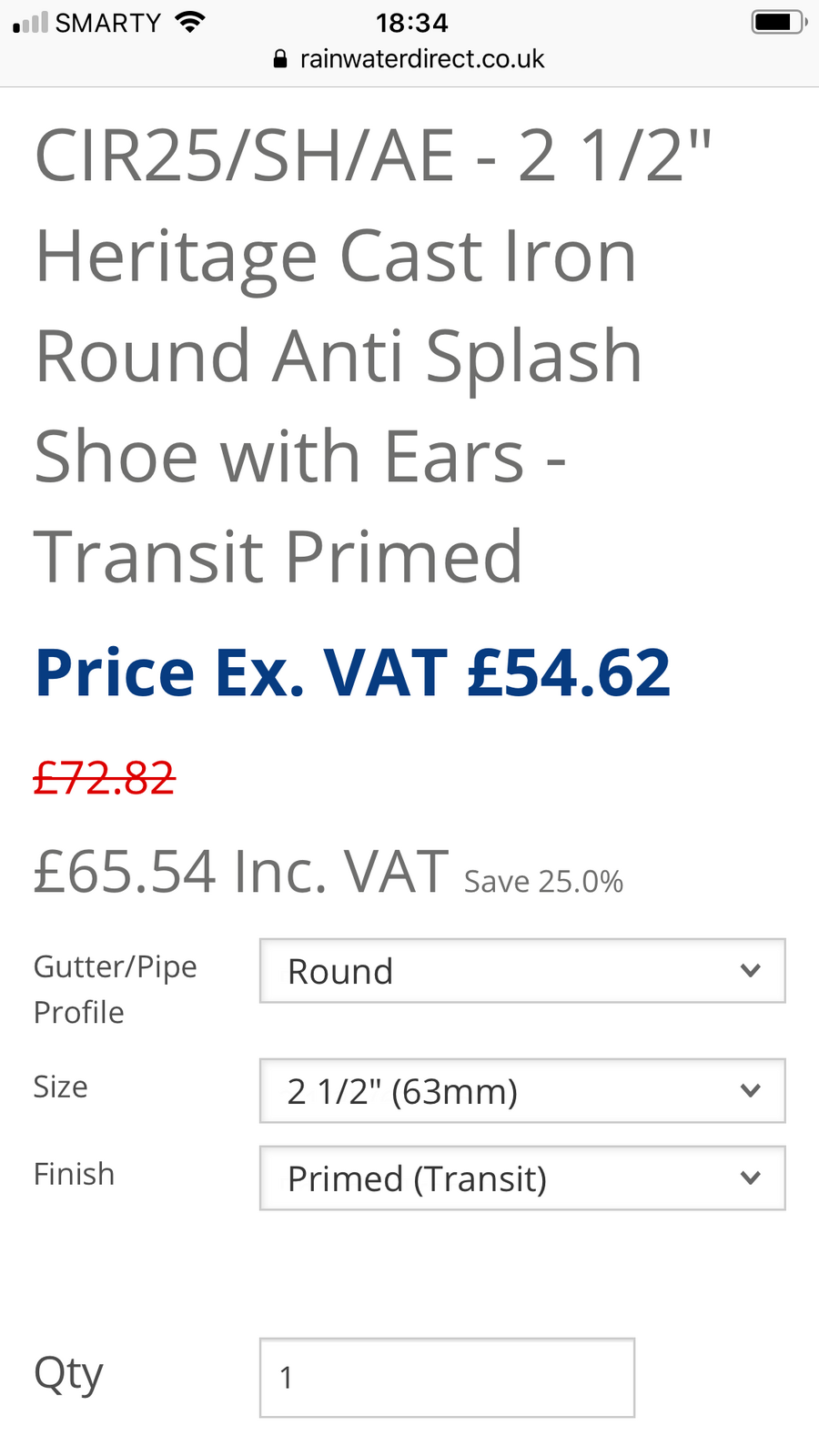

I've just had a clay gully and underground drain replaced due to breakage. The new gully and grate is plastic and a totally different shape and size to the original. Thing is now the downpipe doesn't sit comfortably over the new gully, so I've figured an anti-splash shoe or dog end will sort it by bringing the pipe further over the grate.
The downpipe is cast iron and 65mm diameter.
I can't work out if I need a 75mm or a 63mm diameter shoe/dog end to fit into the existing downpipe. I realise I'm being especially dumb but my brain is fried. It's been a mad couple of weeks.
Delivery is £20 so I want to order right first time otherwise I'll be incurring mega charges!

Standard down-pipes and fittings are 65mm/68mm.
Thanks for the info I thought i’d made a mistake but it defo says 63mm on the description. So if my pipe is 65mm, I need to get a shoe or end of 68mm? I have only found 65mm, 75mm and 100mm ends so far with the exception of this 63mm.
Edit: Brain has finally woken up... of course I need a 68mm shoe! I’ve got so much going on right now i’m not firing on all cylinders. Thing is, I can’t find a 68mm cast iron shoe or end. All I can find is ‘cast iron style/effect’ in 68mm.

Anyone know where I can source this cast iron anti splash shoe or dog end please?

If my memory serves, cast iron DP's are smaller than their plastic counterparts.
I’m scrolling through ebay now for a used one. I get the feeling they don’t make cast iron ends in 68mm any longer.

I can only find cast iron shoes in 65mm online and I need a 68mm. I’ve looked at all my local merchants including Covers, Travis Perkins, KDS, Alsford Timber... nowt.
If anybody knows where I can get a 68mm cast iron shoe from, please point me in the right direction.
Or is a 65mm shoe going to fit a 65mm pipe? I can’t see how personally, but may be I’ve missed something?
Cheers
I’ve got 2 options I think:
1) Buy a 68mm cast iron style/effect (PVC) shoe and paint it in white to match existing 65mm cast iron downpipe
2) Buy a 75mm cast iron (real) shoe and putty/seal in gap between it’s rim and the 65mm cast iron downpipe
Can I get some serious feedback on this please as these real cast iron shoes are not cheap nevermind the £20 delivery on top. I’m easily going to haemorrhage £100 for certain.
Edit: I’ve found 63mm modern cast iron shoes which would mean the shoes fit INTO 65mm downpipes rather than fit over them. That is bizarre surely?
