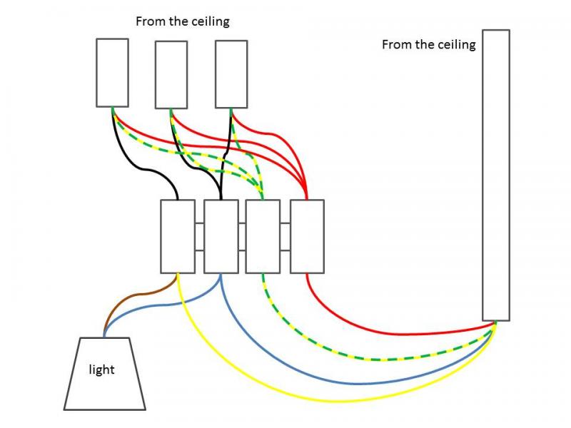

I just moved into a new house and I need to change the bathroom light; it has no cover on the back or front so steam is getting both into the fitting and into the void above it.
The wiring is a bit unexpected though, and provides no earth to the light itself. Can anyone tell me what this type of circuit is, and whether it can provide an earth so I can fit the new light myself? Or do I need to get my nice electrician round? I have attached a diagram of what I have.
Many thanks!
The cable on the far right probably goes to a bathroom fan with an overrun feature and therefore needs both a switched and permanent live. In your diagram the switched live is yellow.
The three shorter cables in your diagram are as follows:
Left - cable to the switch. The red is the permanent live and the black is the switched live coming back from the switch. This black cable should have a red sleeve.
Middle/Right - these cables are the incoming supply and the supply to the next light.
If you need an earth connection to your new light this can be obtained from the terminal with yellow/green cables in the central choc block.
Thanks diyer, you are totally right - there is a fan with an overrun and I had completely forgotten that. So I can just run an additional earth from the 'third' choc block to the light?
I replaced the light, with an earth, and everything is rosy.
