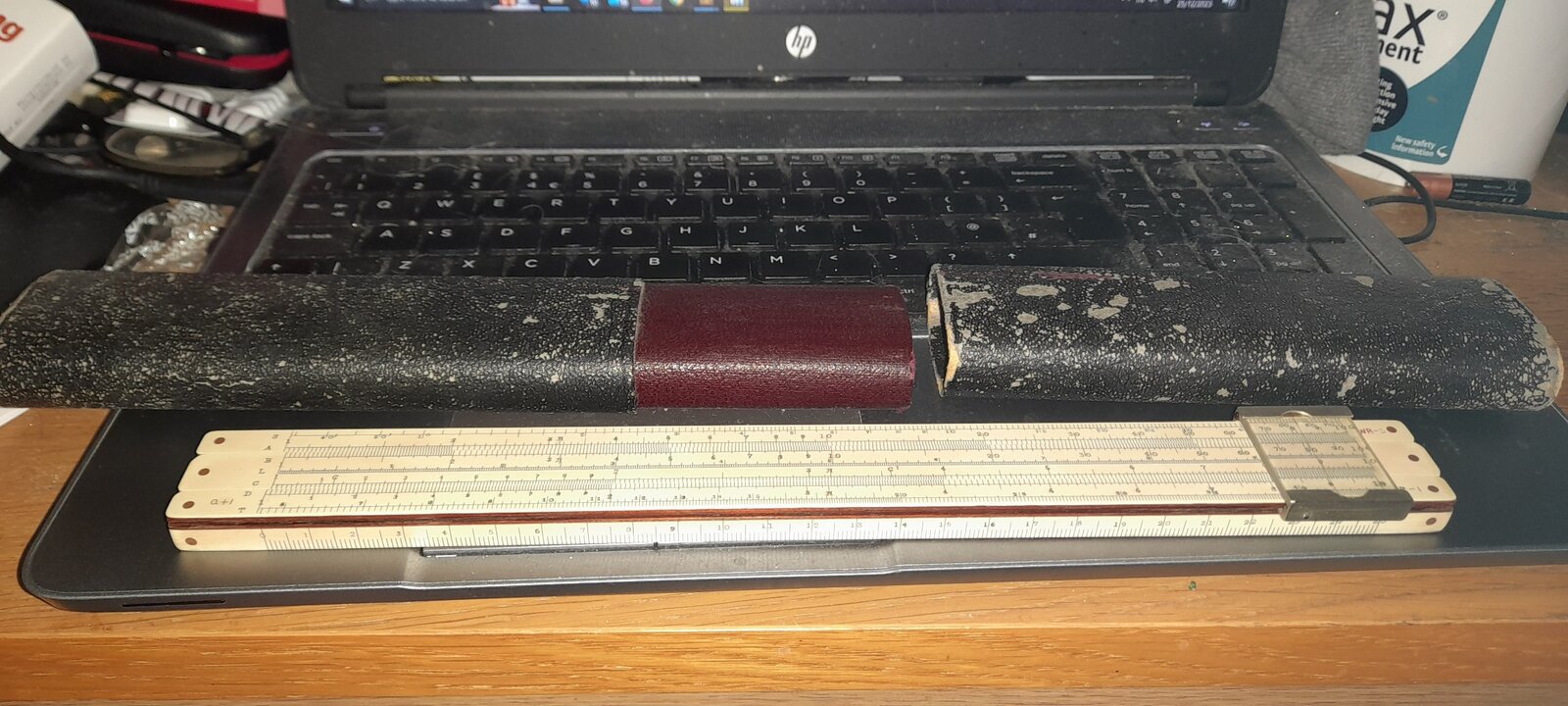

Can anyone beat me and Eric (neither of us admitted it but we both have an abacus and a log table book by Frank Castle)
