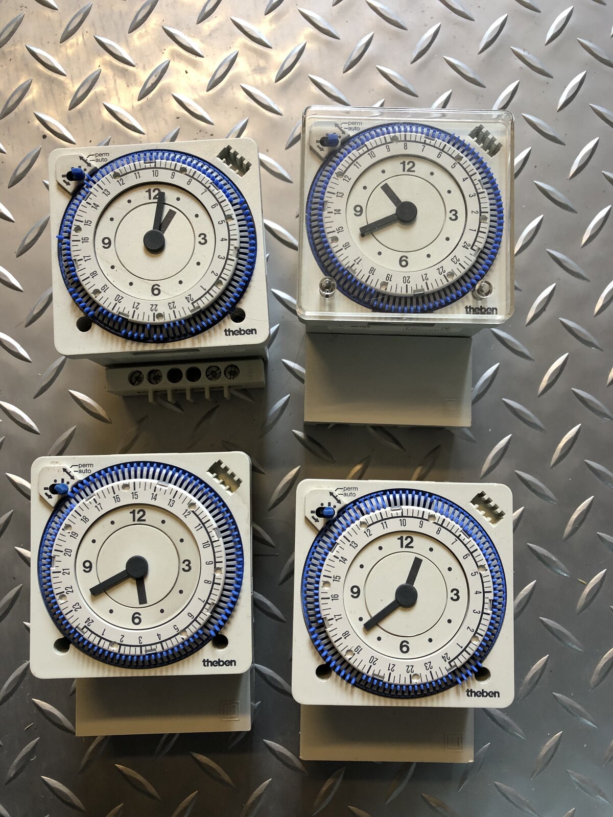

I’m struggling to find what I need because I don’t know what it is called.
I want a time switch that has four terminals, or five if it needs an earth.
1 & 2 ----- Live and Neutral to drive the clock.
3 & 4 -----Two other terminals which are switched but totally separate from the power that runs the clock. I want to switch a separate circuit.
I’ve fitted time switches like this many times but can’t find one to buy now.
It can be basic; I only need one on and one off per day and it will be the same times every day.
What am I looking for?
Just a standard 24hr clock non digital ? I’ve got a couple if you want them if you pay for the postage ….as per picture

I'm stupid, the ones I fitted were non digital but I kept looking at digital ones.
Never worked out why, but time switches often called programmers. Used a lot with central heating. As said want a volt free programmer. Also check the current rating, some are only 5 amp.
The name comes from the fact that inside the unit none of the switching contacts have any connection to a voltage source.
