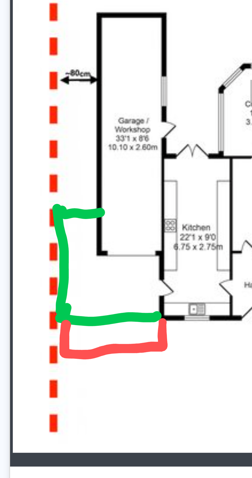

I just put an offer that was accepted on a house that has a narrow and long garage attached to the house. As I would like to be able to park my car inside the garage, I am looking for the most affordable way to make changes to the existing structure (see photos below). I am based in the North West of England (Lancashire).
Option 1:
- tear down the existing garage
- extend the driveway into the garden
- build a large single garage in the top left corner of the plot (I'm considering prefabricated concrete garages but will also look at local builder prices, but I cannot do this until the sale is complete). Just need it for storing a car - no need to any bells and whistles.
Option 2:
- build a new detached garage in the front of the house. Convert the old one eventually into a living area. This might be a potentially painful process to obtain a PP for a detached garage in front of the house even if the space allows.
Option 3:
- extend the width of the existing structure. However, the actual gain in width might be just around 50cm - which would work for the car - but I am not sure if that's good enough gain for the price considering the structural changes the existing garage will require. In my brain, I'm think it should be cheaper than building a new one (prefab or brick) but I'm not a builder and no clue on any prices.
Could anyone advise please on what would be the most sensible approach or what would you do in this situation? Ideally I would like to spend no more than 20k on this, but could go a few grand higher if it's a brand new high quality garage. Any advice would be much appreciated.

You could knock down the bit up to the rear wall of the house and turn that into a workshop and put up a timber open sided car port type supported on columns, that way when you drive in you could open the doors so to speak. It depends on what you want the garage for. As far as I remember if its open on one side its a car port not a garage. so fitting a door to the front would not be an issue and in the pohto there is a fence to the side.
Option 1 sounds good. 2 better but a long shot - planners will be resistant but possibly worth a try depending on what the street looks like and whether others have done the same. Bear in mind that it will get even narrower when you add the required insulation/damp-proofing. 3 is probably impossible, assuming the roof joists currently span the width.
You could also replace it with a new adjoining garage, perhaps with a room on the back. But you'd then lose access to the back garden, assuming it's a semi.
It's a detached house, so there is a good option for access to the garden from the other side of the house. But for Option 3 I was thinking that it would require replacing the flat roof of the garage with a new one (potentially pitched) to accommodate the new width. But that could be pricey.

I'd go with option 1 or just rebuild it. Over 1m from boundary and you can go up to 30sqm without regs. Under 2m from boundary and you're stuck with 2.5m max height under permitted development, but planning for a garage is not expensive.

Is it the width of the garage, or the width of the entrance that is the problem?
If it's the entrance the brick pillar can be reconstructed on the outside of the garage. But that would require a new garage door.
Half a metre gain is quite a gain for the width of a garage.
If you have access to the back garden down the other side of the house i would let time go by and seriously consider flattening the garage, building again so it’s wider and closer to the boundary and splitting it into living and garage space ….

I would extend the garage to the front and widen part of the existing sufficient to fit the car in. You could come to the "front" or possibly further to the building line where the dining room ends (obviously PP dependent). One of those faux pitched roofs on the front would improve the aesthetics.
