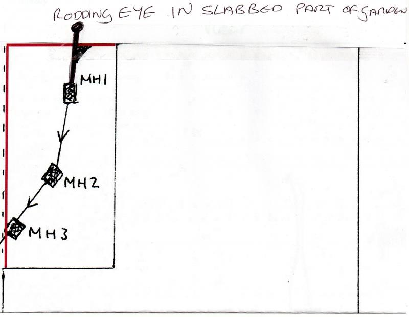

Richard, I will try and explain with pics, try not to leave you more confused.
After double checking for the third time - SVP goes into MH#1 honest :oops:
This is what I was saying about introducing a rodding point outside of the new room. Hope this is self explanatory.

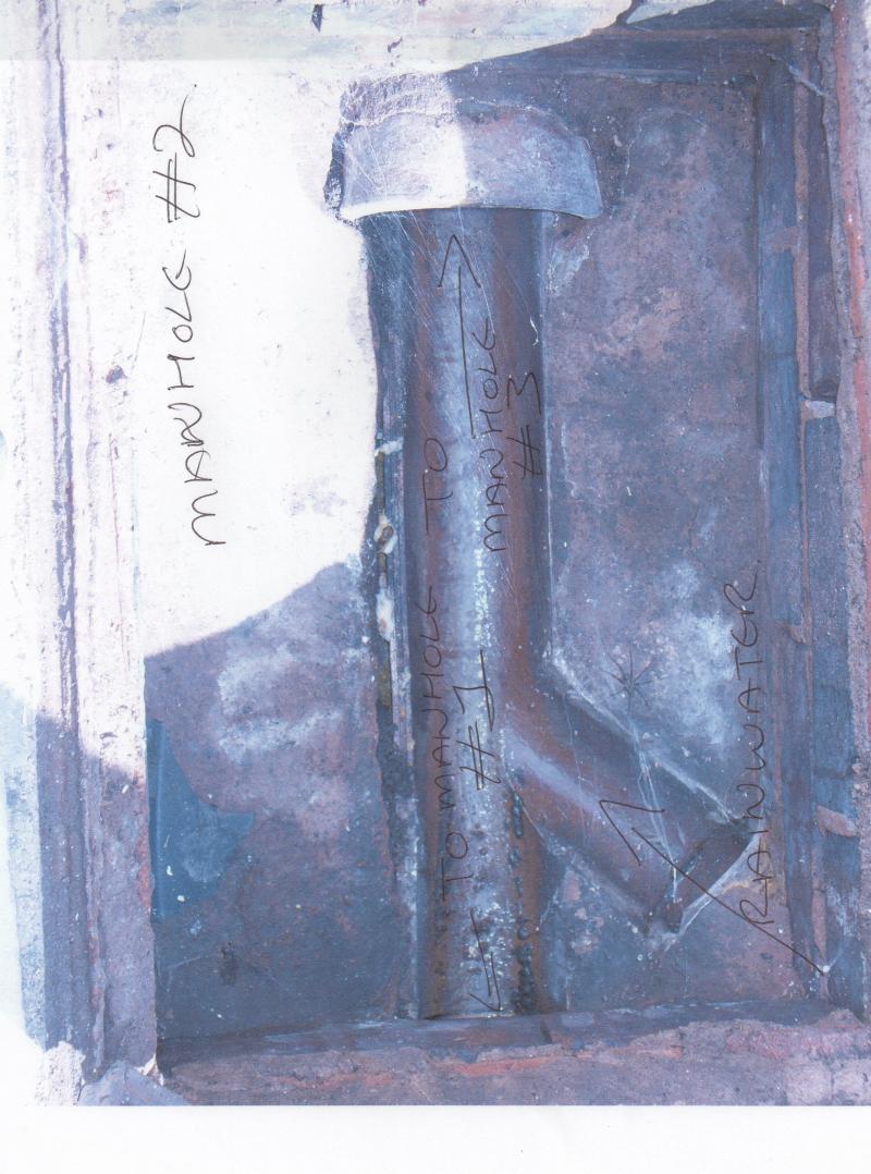

manhole #1 is this:
I hope you can see my comments and the flow.

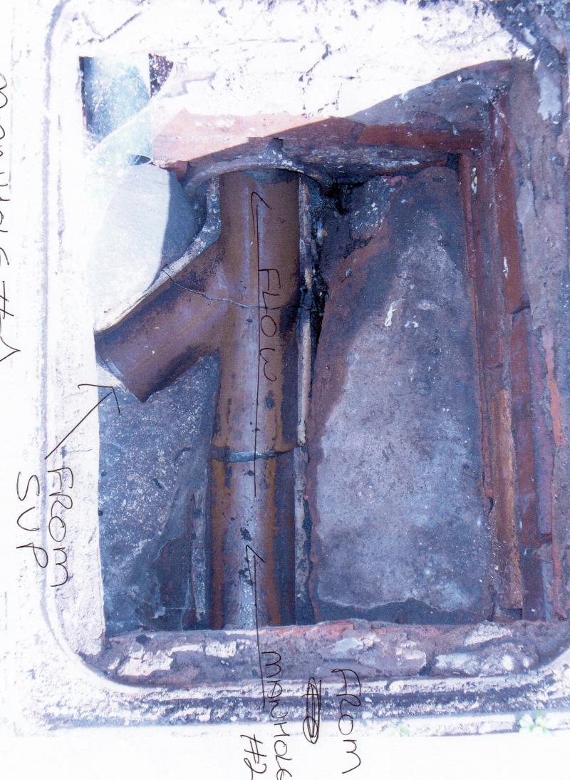

manhole #2 is this:
the only waste is domestic water & rainwater.

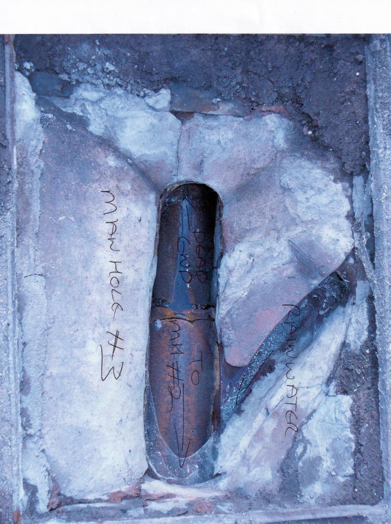

manhole #3 is this:
the only waste is rainwater.
-- As you may notice - claywork is cracked in several places. --

I propose to remove MH#2 & MH#3 & route rainwater to a drain outside the boundary for extension, but back into the sewer as the soil here is clay and a soakway is not advised by LABC.
MH#1 I intend to put in an inspection chamber with riser and a double seal manhole cover ( as this will be an inhabitable room ) to cover access issue for rodding.
Regarding the original cast iron SVP, I spoke with architect who did plans for loft, and as we had a bathroom put in there, he had already agreed with council to replace the remainder of the SVP that the new one is attached to. So in fact I would have new pipes through to the public sewer inlet.
I know its a lot to read but I hope you have the time to have a look & give me your considered opinion.
Thanks again
From the latest info, I’d also remove M/H 2 & 3 & reroute the surface water outside the extension boundary into a new inspection chamber. This should be OK with LABC as you are not introducing any new connections, just rerouting the originals. Draining additional surface water into it from an extension roof may be another matter though & you should check this will be permitted with your local Water Authority as well as an LABC inspector (not the tea lady :LOL: ). In almost all cases, local by-laws prevent new surface water connections & the last thing you want is for it to be kicked into touch after you’ve built or, indeed, face the possibility of a fine!
If at all possible, I would still be looking at removing M/H 1 from inside the extension; it’s not ideal & may put any future prospective purchasers off. Instead of creating just a new rodding point outside the boundary, is it not possible to build a new inspection chamber & route the foul & surface water drains through this? Even if it involves repositioning/rerouting the SVP, it would be a much better & more desirable solution.

MH3 is the one that has the SVP going to it :oops: :oops: - the others MH2 & MH3 are rain water only, I got everything on the pic labelled wrong.
So in my pics - MH1 is actually a pic of MH3 as per the pic I have now uploaded with SVP leading into it, that is why I thought the only way was to have an inspection point there.
So the rodding point stays as it is and the inspection cover stays there just in case of any eventualities.
I would like to move SVP all the way to back of the house but believe that would be way to much travelling for the foul waste.
Again so sorry if I have wasted your time
What I posted still stands; I would advise loosing the inspection cover inside the extension if at all possible, even if it means installing new chambers & negotiating with your neighbour to reroute/replace a section of his foul drain.
