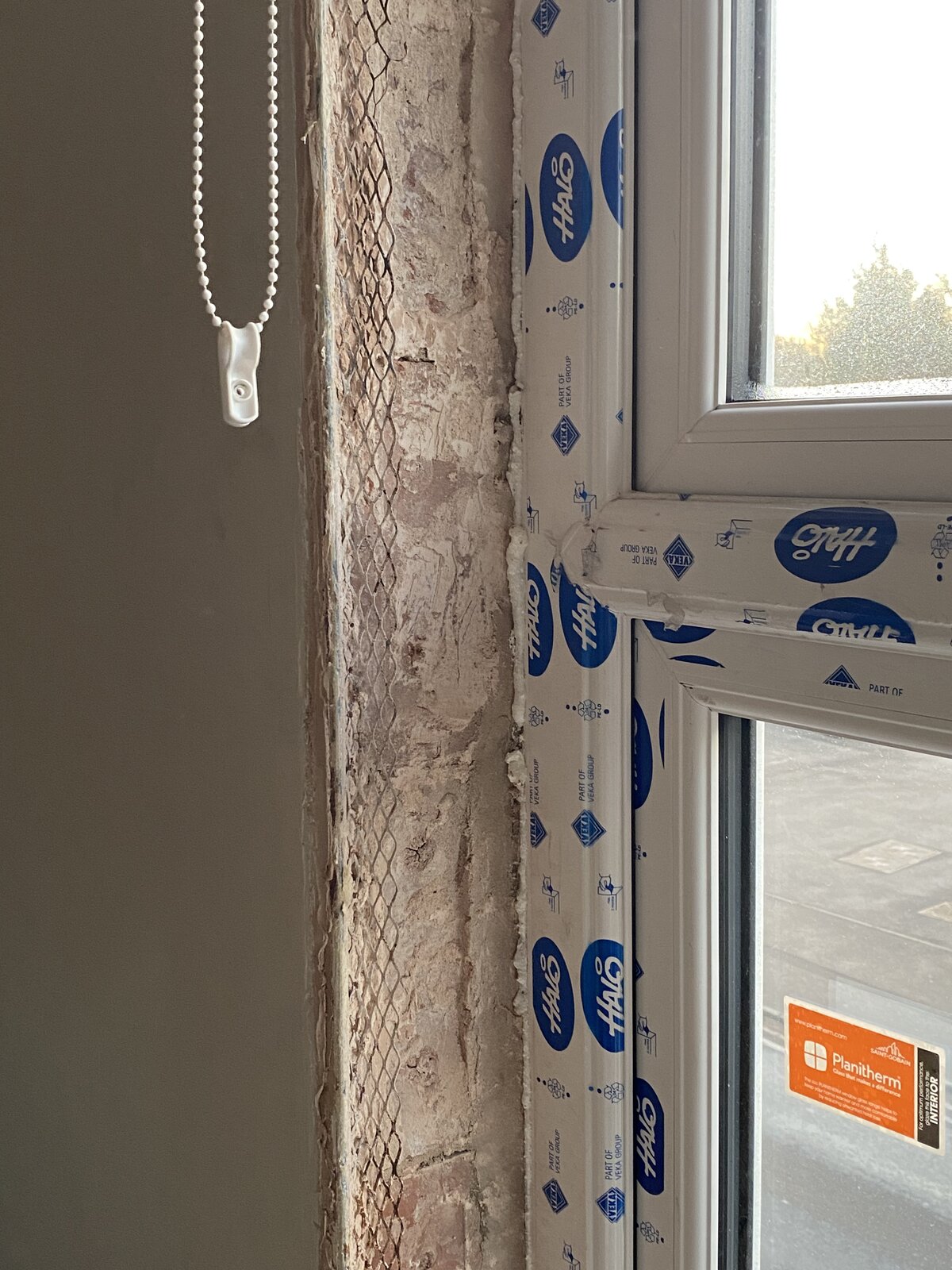

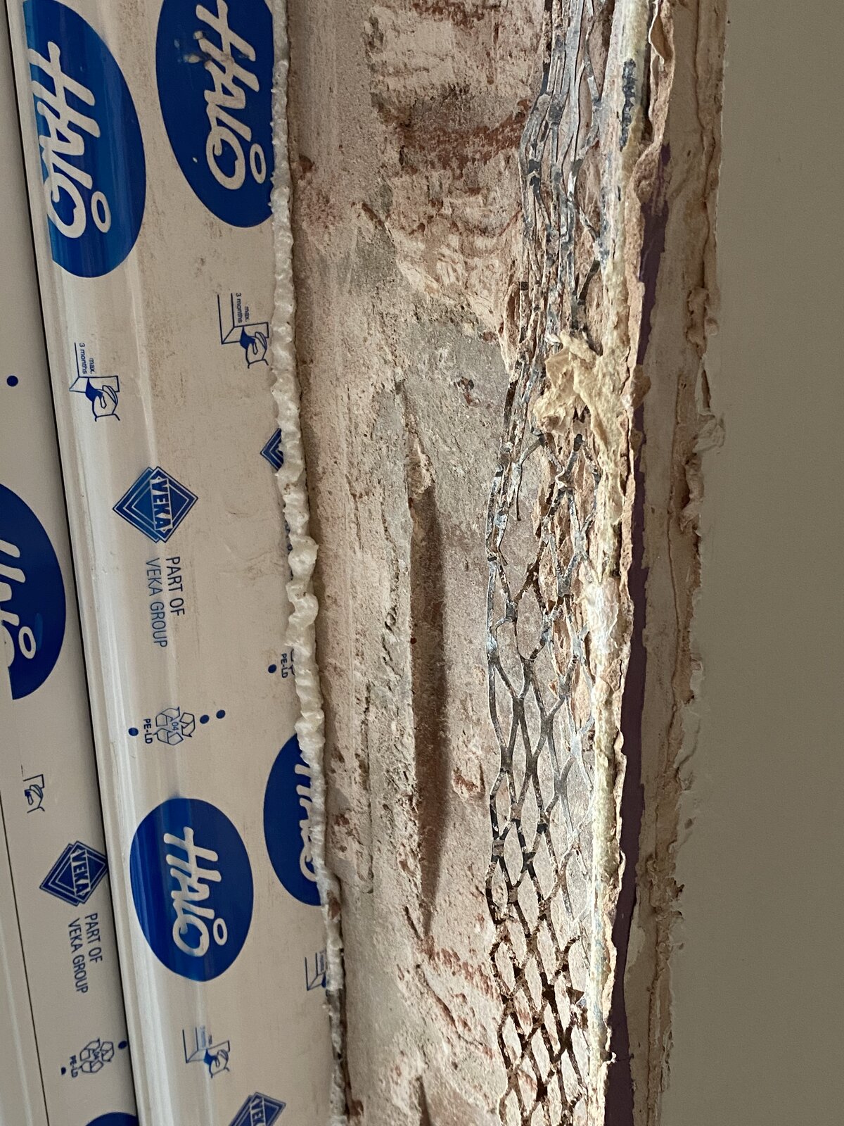

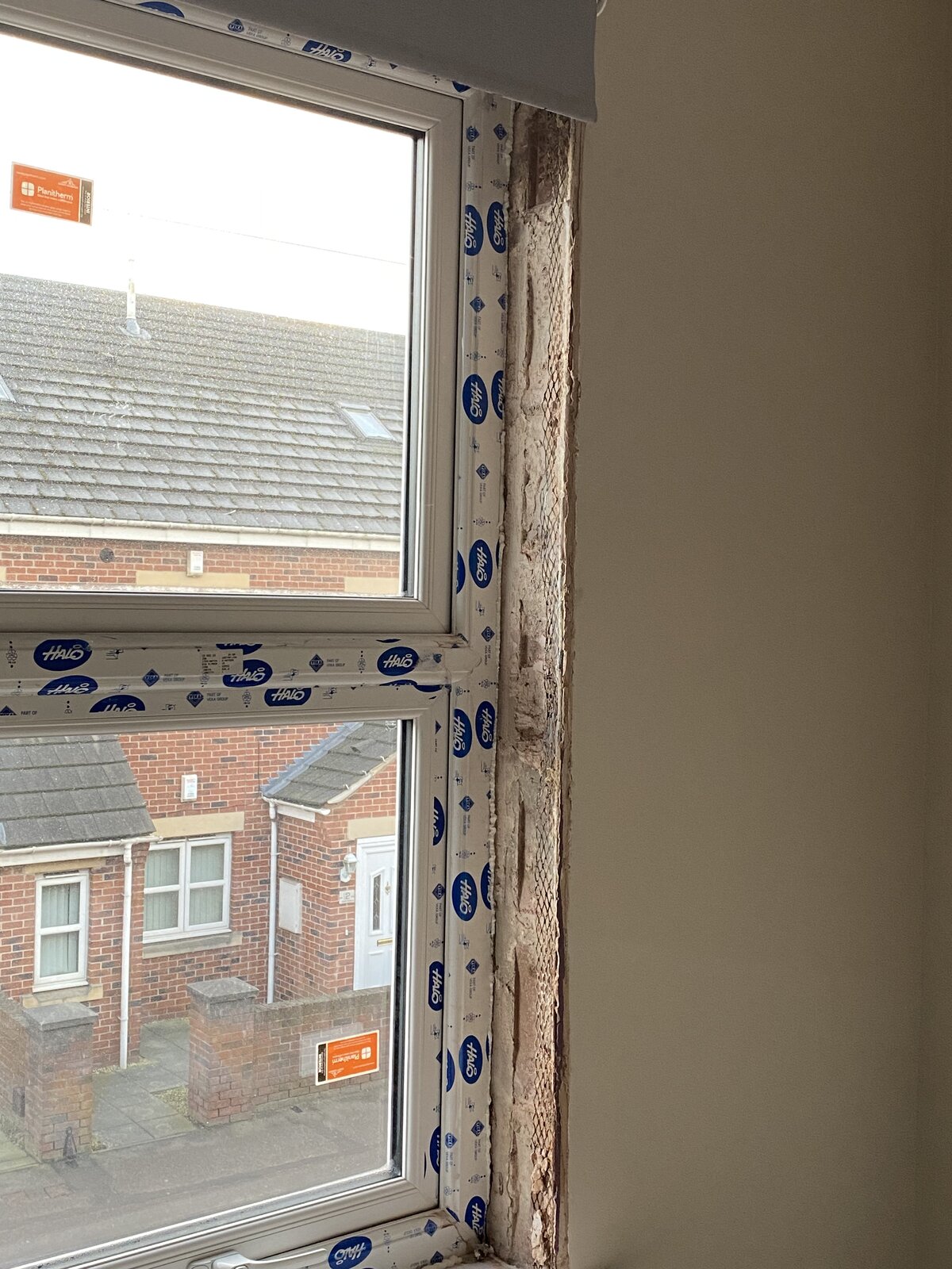

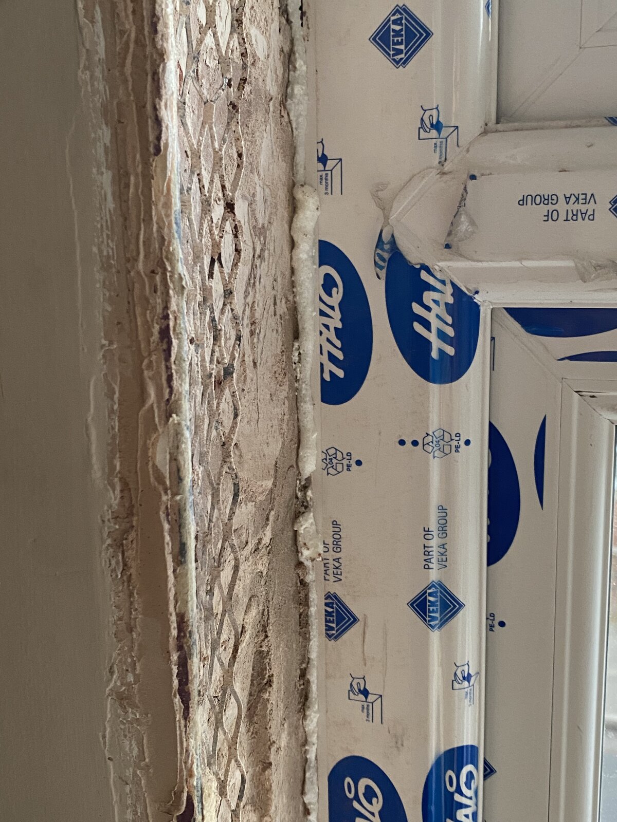

Before my windows were installed I had this awful pvc stuck around window frame so I removed it and half the plaster came off with it, so I removed it all back to brick and I’m left with this
How do I deal with this - without plastering the whole wall aswell! Will I need new external angle beads?

Put on an insulated plasterboard, yes you'll need a new corner bead.
You'll be able to get it nice and square easily since you have a window to go off one end and the other side a entire wall.
You'll be able to get it nice and square easily since you have a window to go off one end and the other side an entire wall.
Thanks for your reply
If I put a corner bead on how will it effect the currnt plaster on the wall?
Can I just feather it in to the existing plaster on the wall?
What thickness insulated PB is best?
Would I cut away the existing corner bead with tin snips? Or just board over it?
