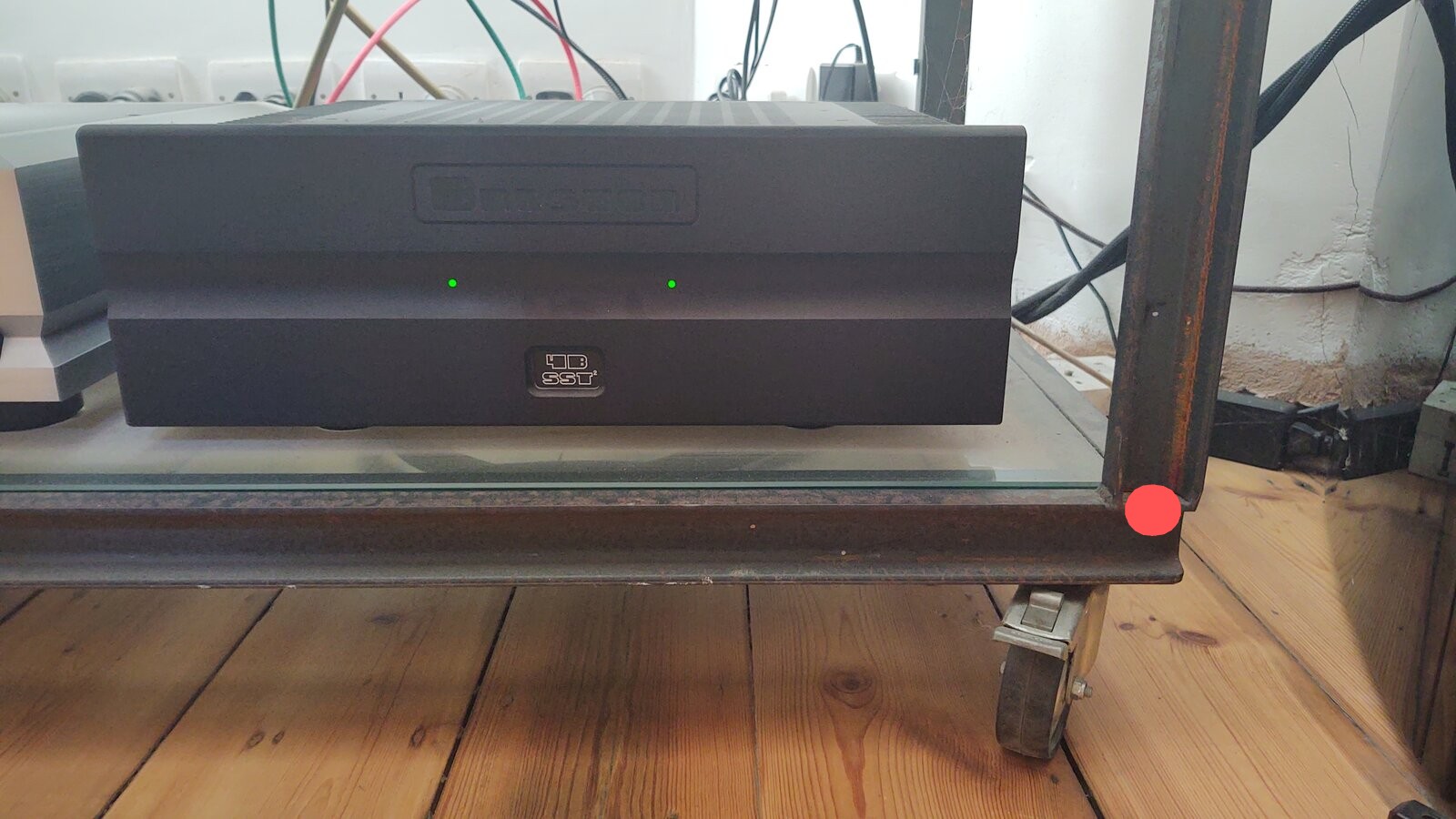

I have a hifi rack made from steel beams, see below. I'd like to cut a few notches to improve my cable management. I'd use a file but space for running a file back and forth is restricted so I thought it might be an idea to use a tool like a rasp drill bit that fits for into a cordless drill. It's pretty thick steel. What tool would you recommend that would do the job?

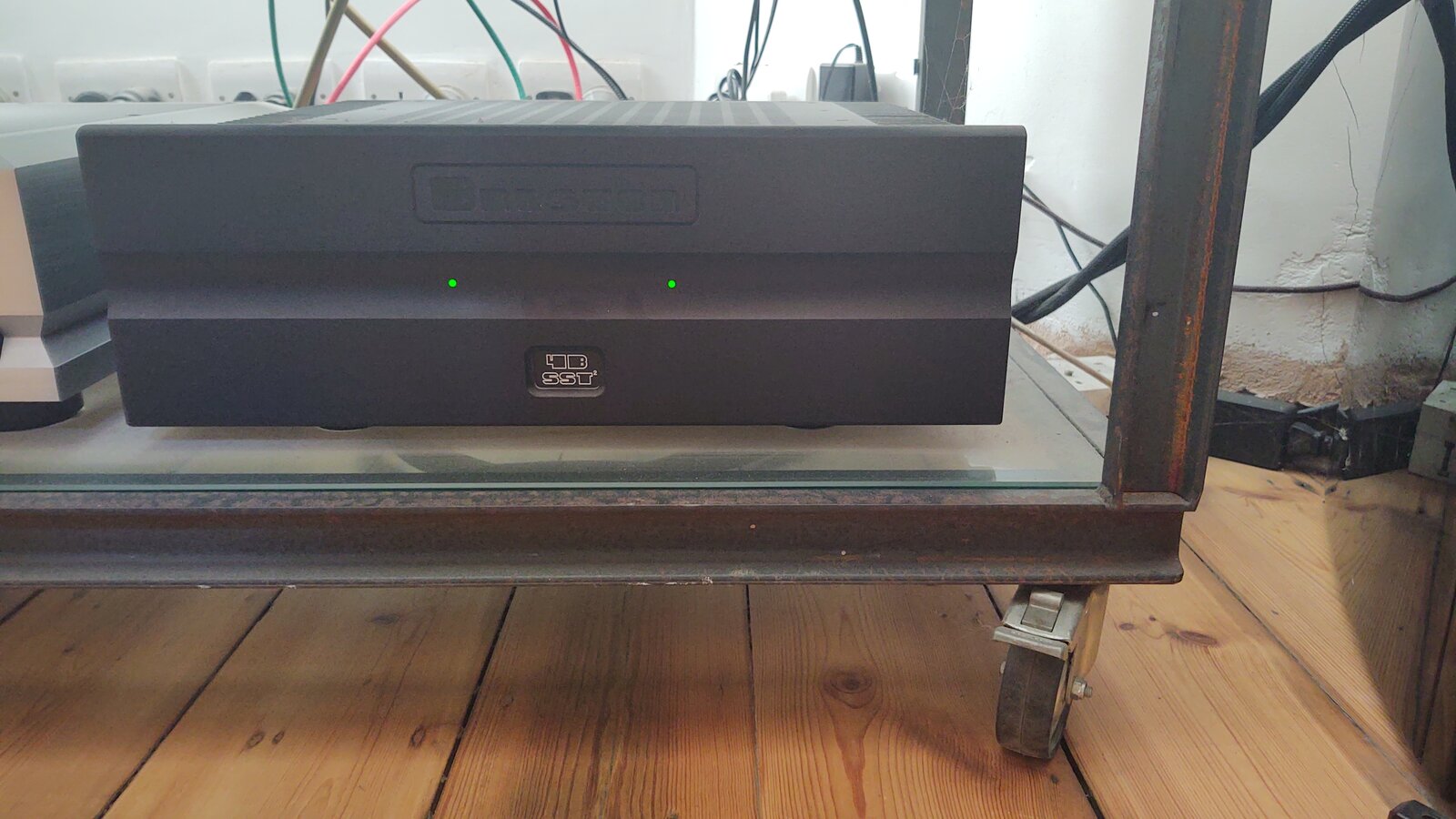

Is like to cut a notch where the red dot is. A saw or a file might not work and will take ages. A grinder would work but I don't have one. Is there a specific bit that fits in a drill that could grind a notch?
You will need a grinder, mains grinders are cheaper than cordless. A milling bit won't work.

Why not drill a hole?
Or two, or several, and if need be, square it off with a file
Holes drilled. It came out ok in the end. Glad I didn't have to use a grinder which could have been messy in a small space and expensive equipment close by. Going to get a rasp tomorrow. Any of the rasps sold in Screwfix any good? Happy to get it elsewhere if I can get a better one that will cut into the steel more easily
They are files. If your intention is to turn a round hole into a square one, aren't they going to be too big?
