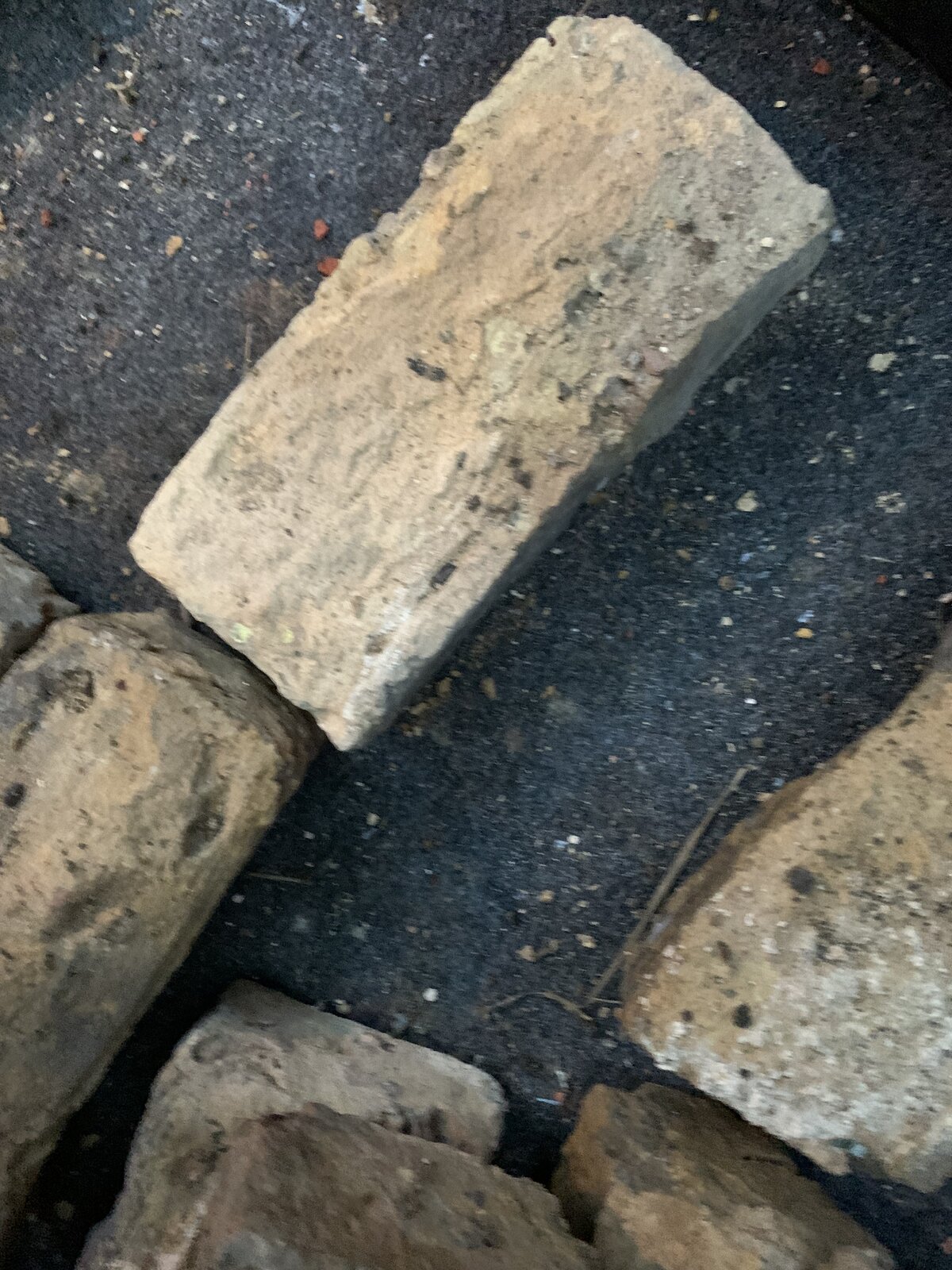

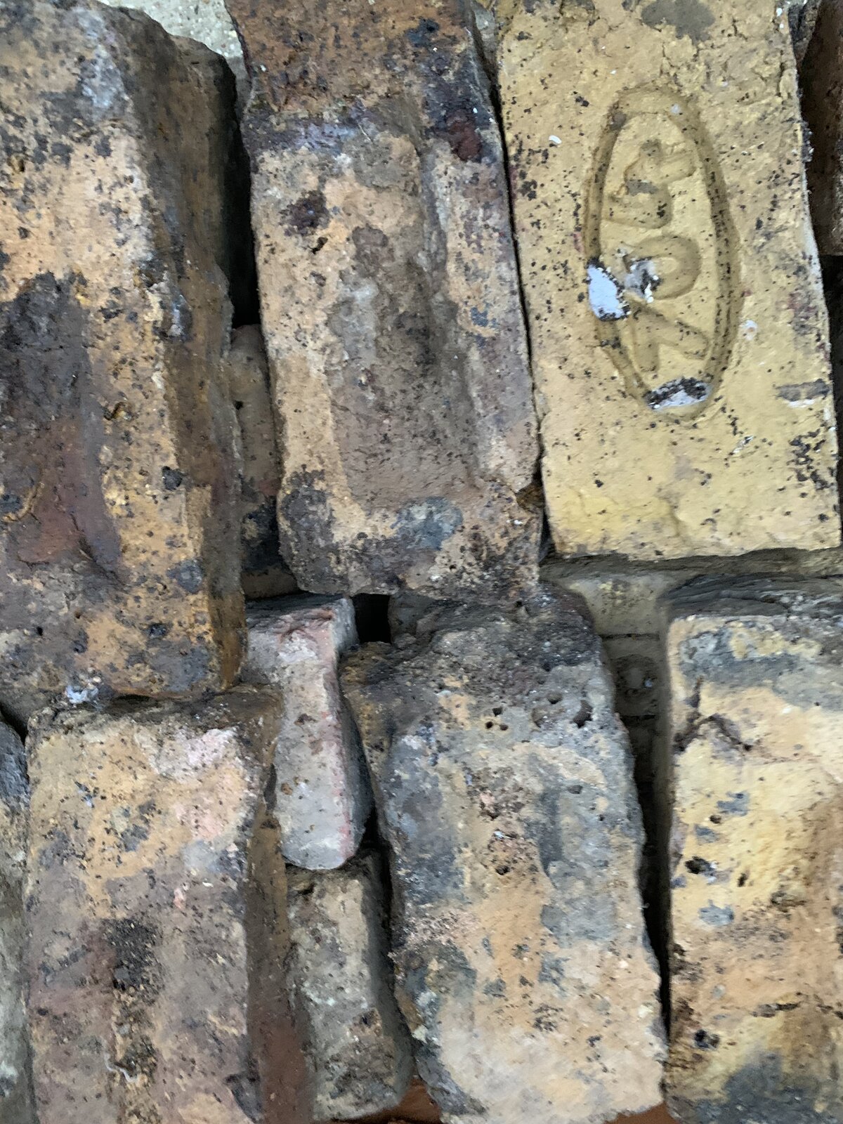

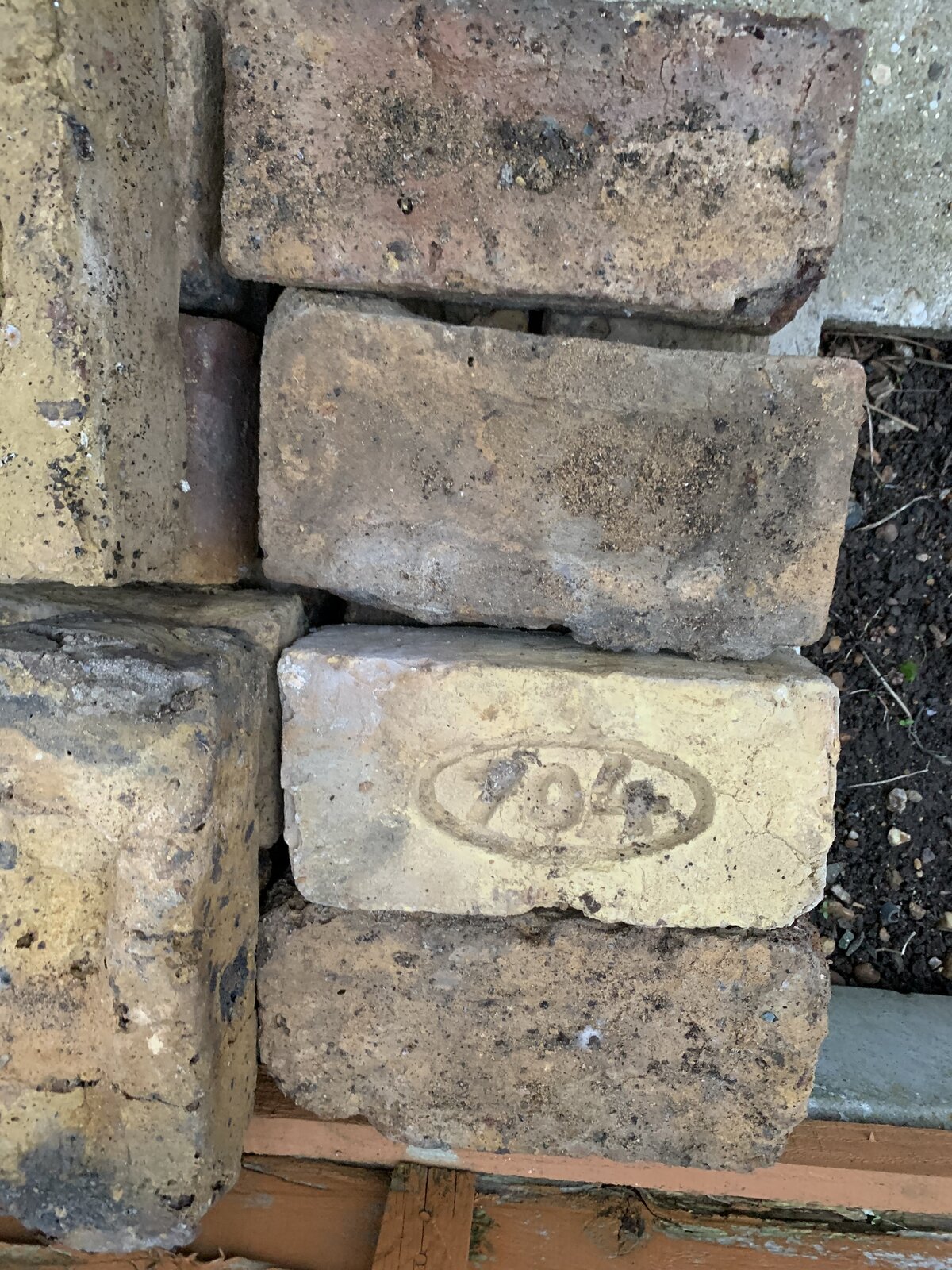

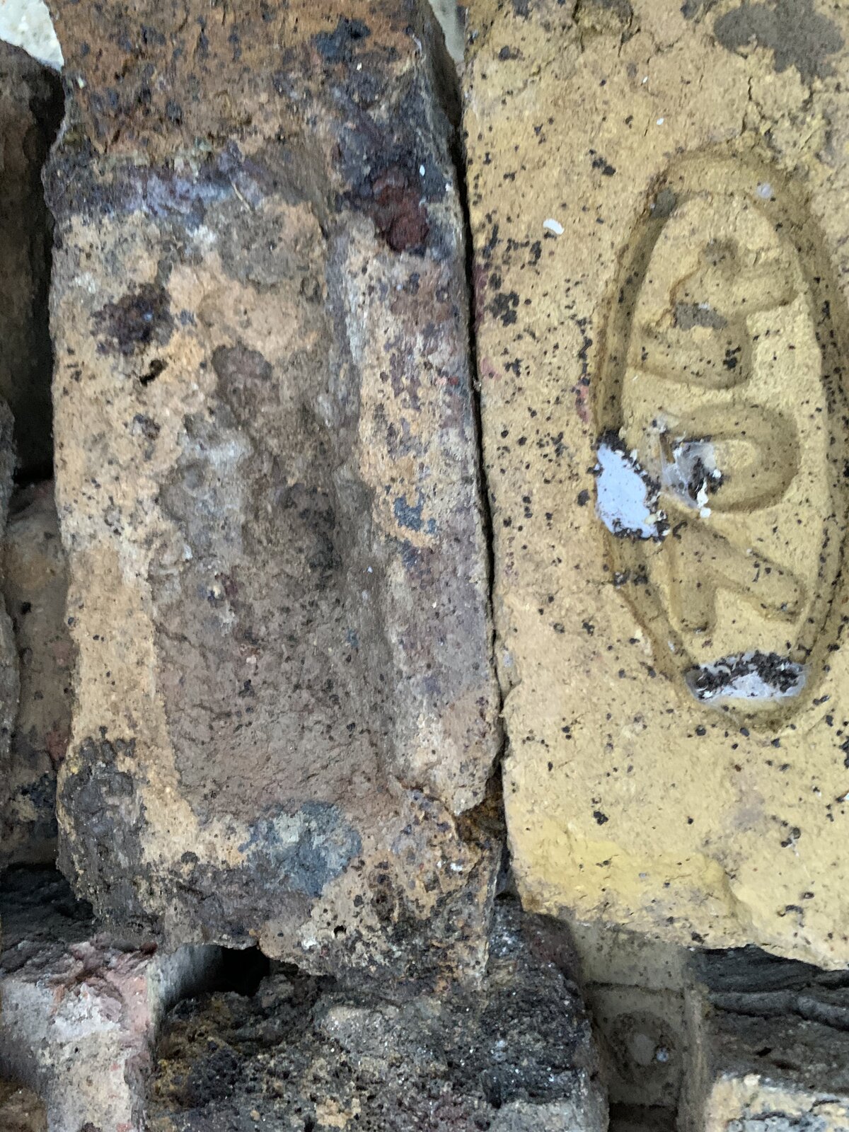

what type of these bricks - Are these any good for garden wall?
29 Mar 2012
90
Thinking to garden wall or path.
Not sure what types these bricks are
I'd guess they are fire-brick, used inside chimneys, furnaces an kilns. They look far too irregular for a wall, certainly a face, but they would do for backing-up, ie. for the brickwork behind the face (front) of the wall.
Alternatively, they could be old glazed brick with a tile-like surface.
