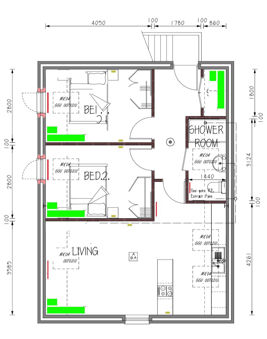

Perfect thanks mate. I was just about to propose that I will be doing the following:
Trust thats what you are suggesting? Will start on this tomorrow as I've just received the fibre boards.

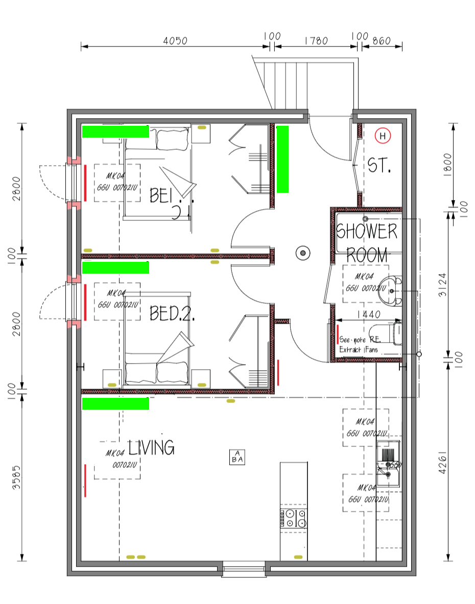

If laying rows from left to right, you need to start at the other side of the hallway.
Hi and thanks, hopefully getting somewhere now.
trust the below starting areas and run direction are okay?
Have done and they look fine to me. Was hoping for someone with experience laying laminate to confirm that the starting points and direction are okay.
Well, you seem to get confused with what I meant with left to right, but I am sure after 3 boards you will see...

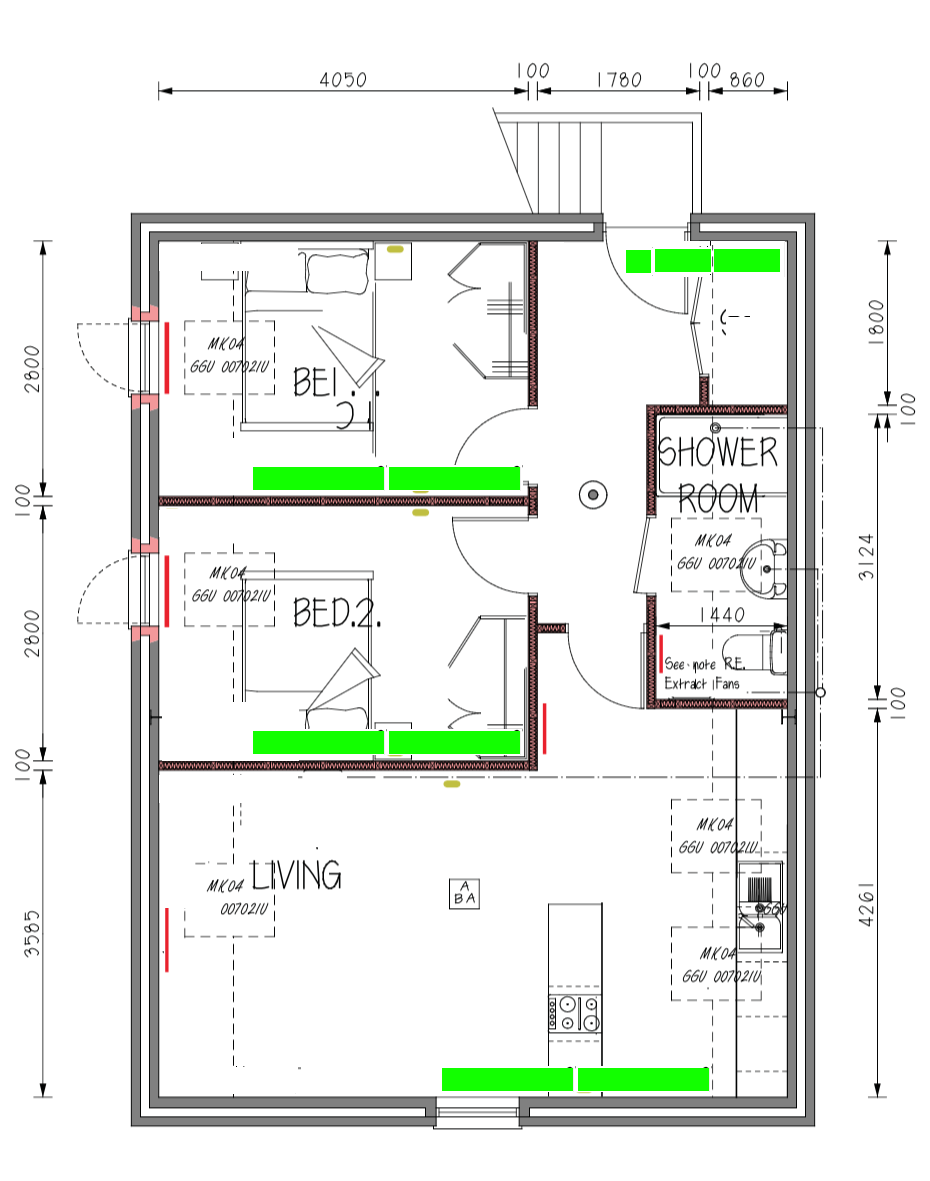

This?

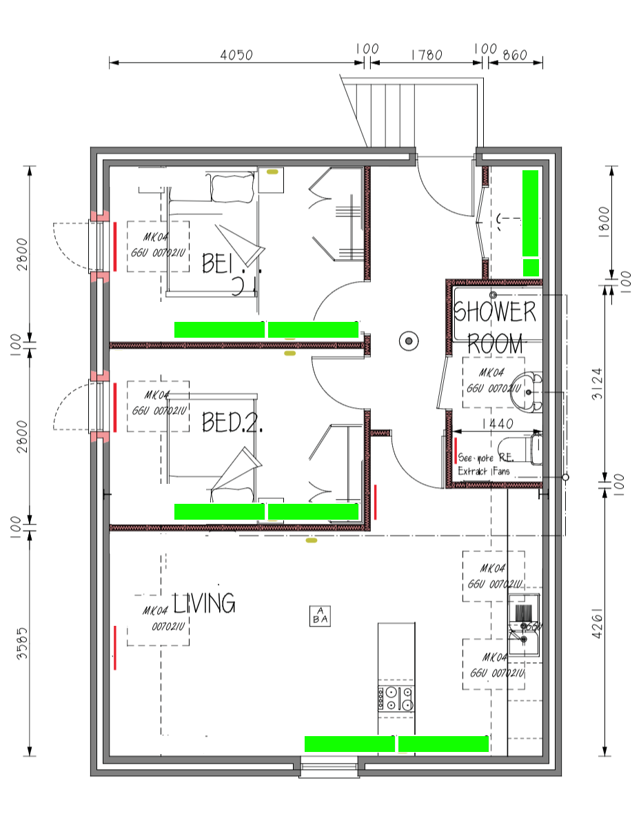

Appreciated foxhole. Do you mean like this? I didnt want to run that direction in the hall as I thought it would look weird...?
Correct me but surly they are the two options running from the cup side? And they are both wrong?
The problem is that I do not understand you. Would you mind explaining a little?
