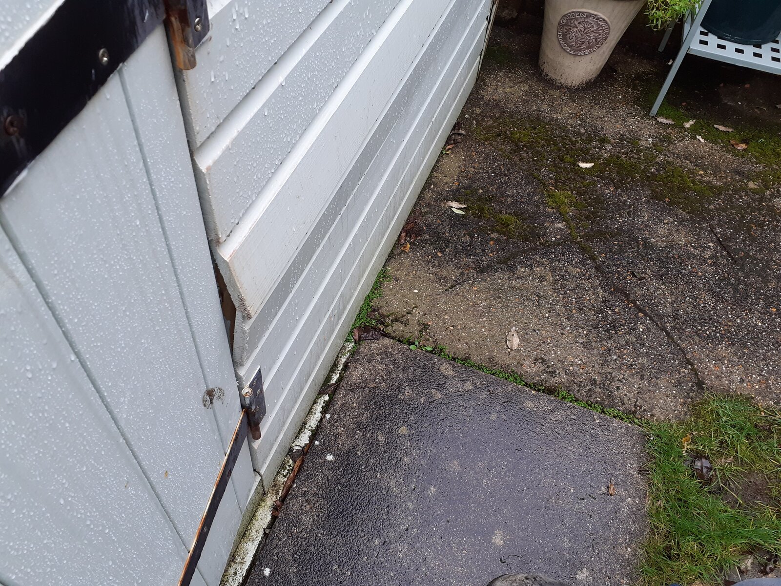

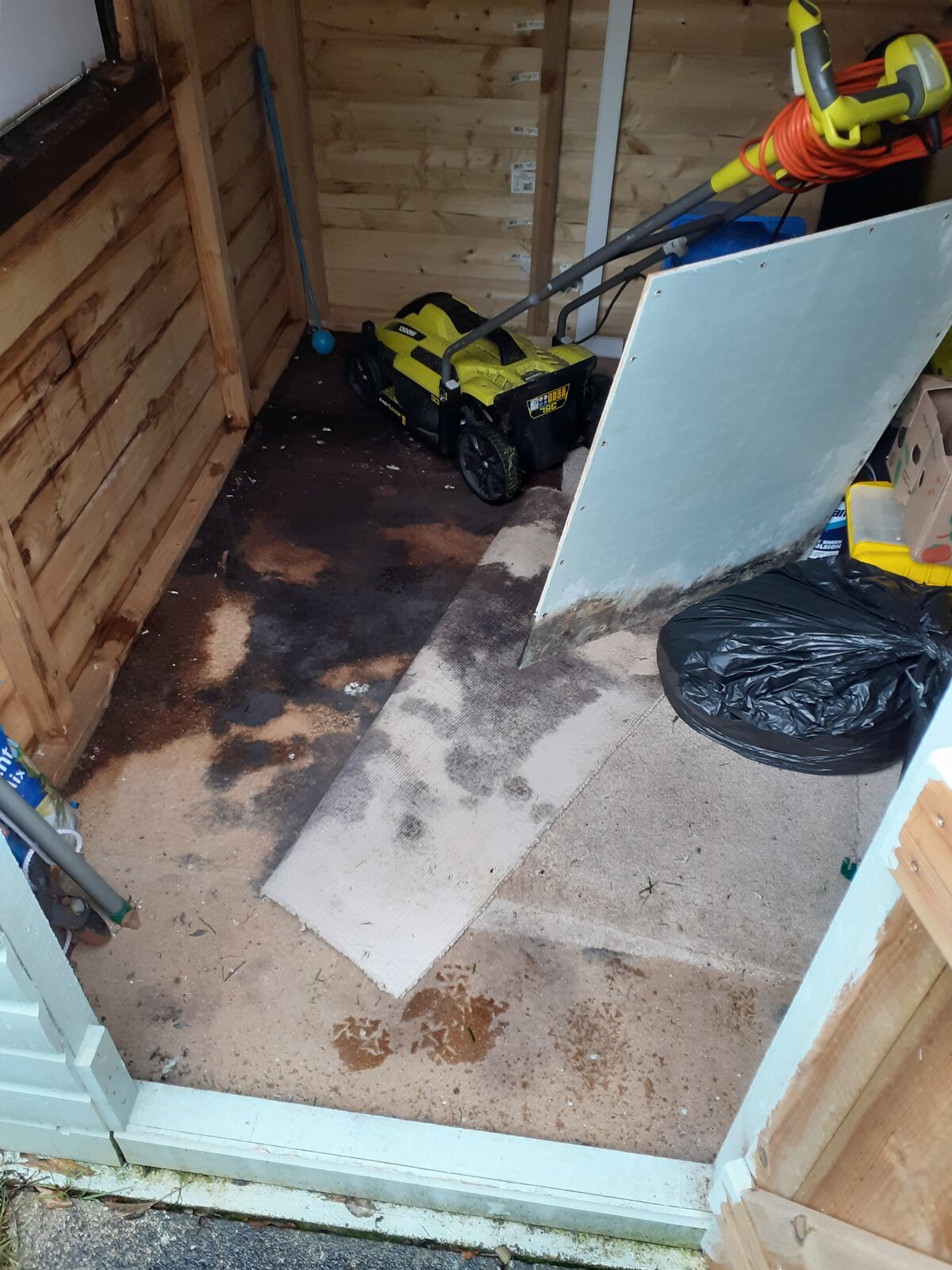

Gonna cut this rotten shed floor out and replace with chipboard. But what's causing it. Should I put dpm under it?
The panels on side are pushing each other. Is this expansion? Would a block plane to trim it a
bit do the trick?
It looks as if the entire hut base is sat on the floor - that is a really bad idea, because it will soak up moisture and be constantly damp causing rot. It needs to be raised off the ground or the slab, so air can get under it. I would suspect the timber floor battens have rotted out.
+1, definitely get it up off the deck by at least 40mm, it could be an idea to block the gaps with chicken wire to keep the leaves etc out at the same time.

I wonder if it has anything to do with all that water leaking in through and under the walls? :rolleyes:

Whatever you put down as a replacement floor, painting the underside with a bitumen-based paint should prolong its life.
The wall looks wet too, is it just one wall that is wet, perhaps caused by the window?
Definitely needs raising up on bearers regardless.

Dismantle shed. Make new base from treated 3 x 2 softwood battening and some OSB3 or the like (nailed on top, for the floor, on 600mm centres) and sit the new base on a DPM. Re-assemble the shed sides on the new base and replace the roof which will probably need refelting. As to the T&G, it has swollen from water absorption and a plane won't work - the lot will have to come off from that point down (or up, depending on which is least work) and be refixed. That's the proper fix. Frankly I think it's more work than it's worth

Cut your losses, scrap that pile of carp.
Make a decent base support frame from 3x2 or 3x3 treated timber, level up on mortar mix with dpc between that and the timber.
Buy a new shed, 6 x 4 aren't that expensive.
