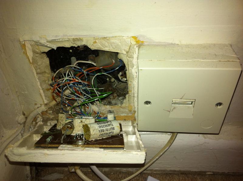

I've recently moved into a new house. The previous owners were a little slapdash with, well, just about everything, including phone extensions. There are extensions throughout the house in walls, along skirting boards, under carpets etc. None of them have been put in very carefully, and we don't really need them with DECT phones, so we're going to take them out.

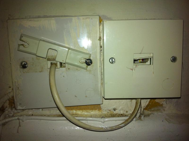

Anyway, I was trying to work out which is the master socket but I'm a bit confused. This is what I think is the master socket (on the left). It is downstairs near the front door of my property.
As you can see immediately next to the master socket is an extension socket, which plugs into the master socket. There is also a sort of plate that holds the plug in place for some reason (partially lifted on the photo) - any ideas why?

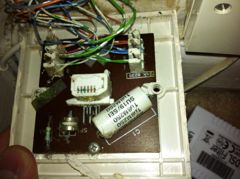

So I unscrewed the socket, to find this mess, and I'm not sure what's going on...
And here's a close-up of the circuit board.

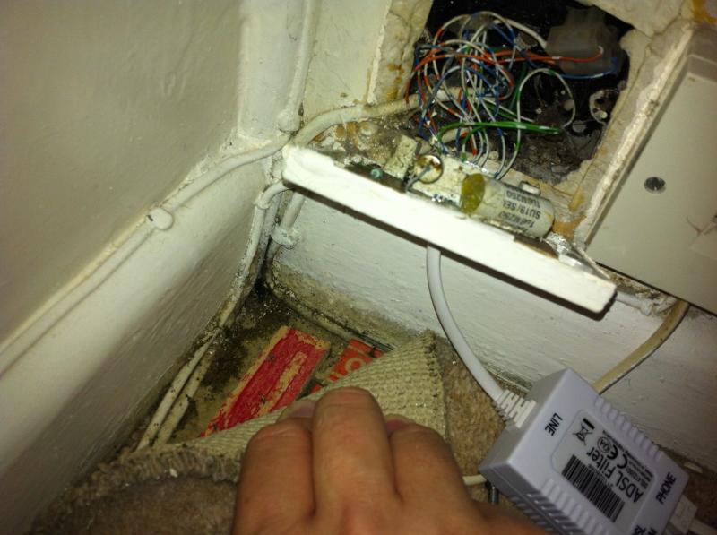

There are also numerous cables coming out of the master socket (as well as to the extension socket). These go off under the floor (not sure where yet!).
So my overall query is... what is going on here?

Looks like a non standard bt master wired to the extensions via the fly lead, so the internal can be disconnected from the master socket. Nasty !

It looks a right mess... go to your local paper and you will see ads from ex bt engineers , disconnect all your extensions and just fit a nte5... or call openreach out but expect a hefty bill
In th days after the introduction of plug in phones but before the NTE5 you were not supposed to mess with the master socket or any of it's wiring. So if you wanted to do things by the book you had to plug into the master socket.
The way it was usually done was to use a "converter with cable" that was included in an extension kit. This plugged into the existing phone socket, the phone at the master socket location plugged into the converter and then the extension sockets were wired to the cable coming out of the converter.
It looks like someone decided to use a conventional phone plug instead of a converter with cable. Maybe because it was what they had, maybe because they could get a locking bar to prevent it being unplgged.
It also looks like someone has wired extensions directly from the master socket (which is technically breaking the rules but a lot of people did it), this suggests that the current mess has developed over a period of time
It is also very strange that there are so many wires at the master socket. Normally only contacts 2 and 5 would be connected to the incoming line and contacts 2,3,4 and 5 to extensions
In short it's a horrible mess and it's going to take some work to figure out the exact details of what is going on. Personally i'd start by trying to figure out which cable carries the incoming BT line then redo stuff starting from there.
P.S. It's unusual to see a large size non-NTE5 master socket with BT branding. I guess the builders put a box in before BT installed the phone line or something.

I've done a bit of exploring, and discovered what is going where.
There are two "hard-wired" extensions coming out of the Master socket - one of these goes to a room downstairs, the other goes to a room upstairs.
The extension box on the right, which is connected via the socket of the Master socket, goes solely to our burglar alarm. This is strange because we don't have it configured to call anyone! (Does anyone know why this might be?)
Thanks to DECT phones, we don't need any of the extensions, so my plan is to remove both of the hard-wired extensions from the Socket. I'd also like to remove the wire to the alarm and the extension box on the right, but I shall wait to see whether I need that or not.
I'd then like to get BT to upgrade my Master socket. I appreciate this will probably cost me. Is it true that they will upgrade the Master socket for free if I upgrade to Infinity? If I've removed the hard-wired extensions by then, will they know it has been tampered with?

Some people like to have their burgular alarms call either them directly or an alarm monitoring station when the alarm goes off.
I guess this explains why they used a conventional plug and a locking bar rather than the "converter with cable"

If you upgrade to a FTTC service (BT infinity or similar) then a BT openreach engineer will be sent to install the VDSL filtering and modem. AIUI if you have anything other than the latest variant of openreach NTE5 they will replace the master socket as part of this process.

If you're going to call BT out anyway then I wouldn't worry about the hardwired extensions. It is quite possible that they were installed by BT anyway and there is no reason for you to mess with them.
