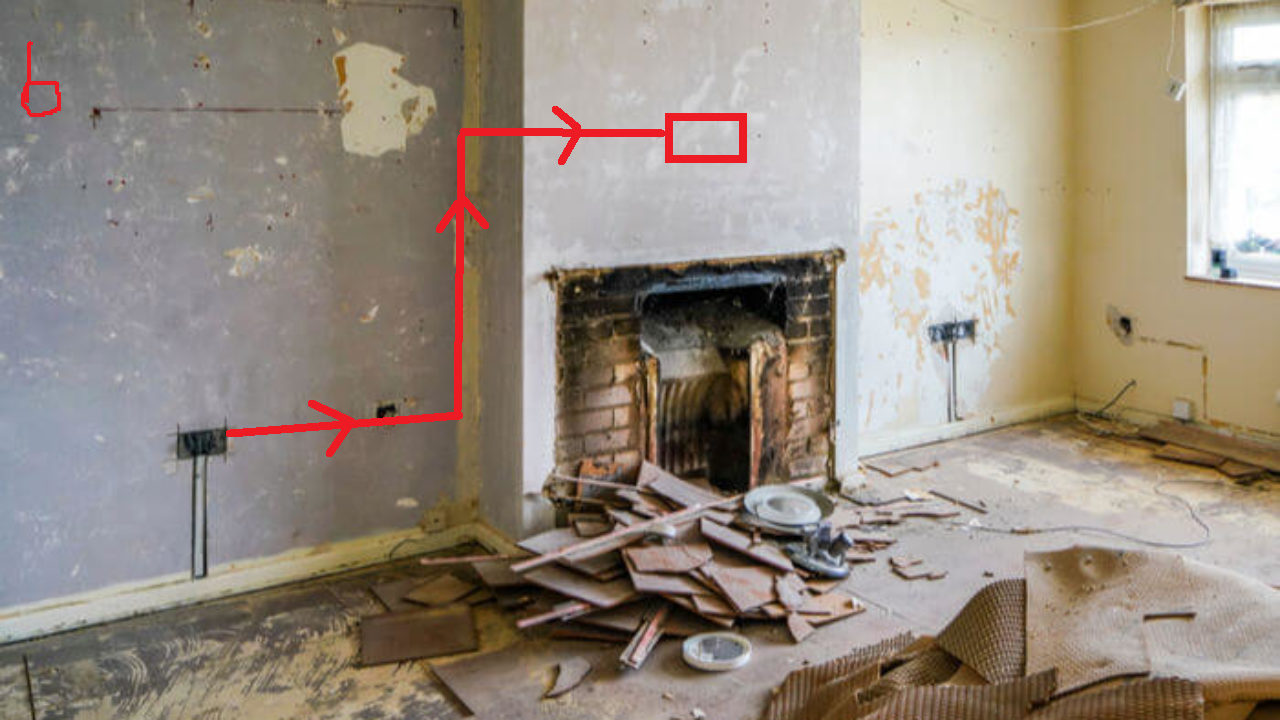

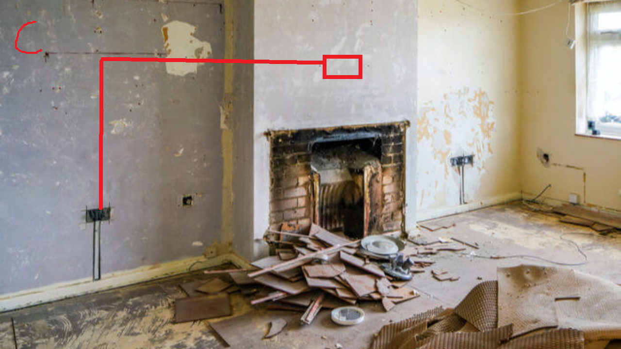

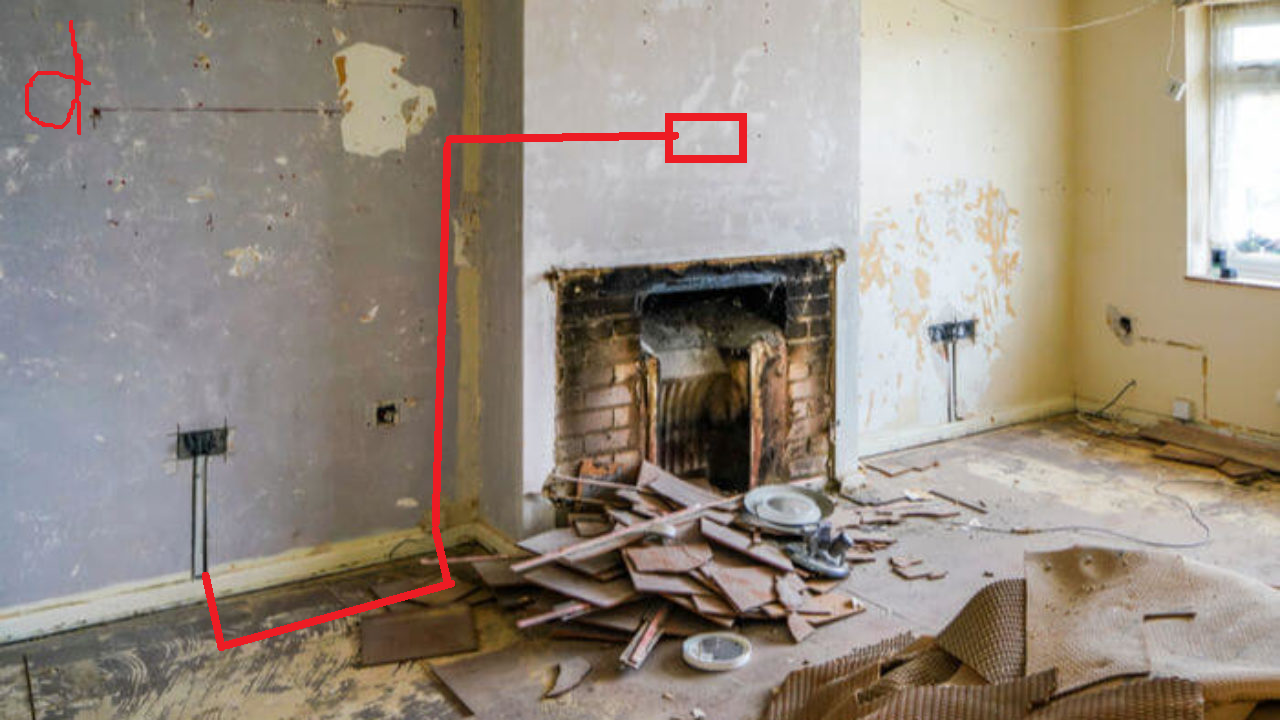

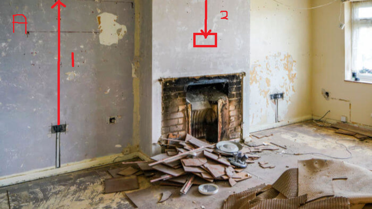

I'm installing a new ring circuit and i'd like add a socket above my fireplace (for the 65" 4K TV :D:D)
However I need some advice on the safest way to route the cable
From the four options attached (i.e. A,B, C,D) what would be the safest/simplest way
FYI -Option A is chasing straight up the wall, placing cable under floorboard in upper floor, then chasing straight down to the socket on the chimney breast

A = yes
B = yes if the chimney breast is 300mm depth or less
C = no
D =yes if the chimney breast is 300mm depth or less
Unless this is a bedroom, that it far too high for a television.
Don’t forget aerial, satellite, CAT6, HDMI and other cables you will need for the TV.
But as flameport says it is too high for a TV. Will the fireplace be used? With rising heat your TV won’t last long.
Above the mantle seems to be the fashionable place at the moment.
Consider fitting a switch to control the TV socket for easy isolation.
Why do you want the telly over the fireplace?
As he is fitting a socket pulling the plug is the best isolation there is.
